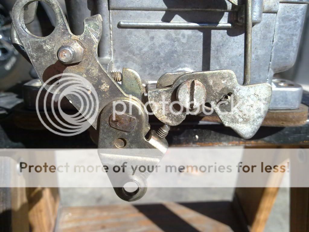

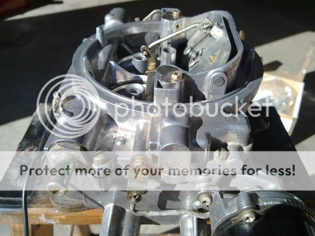

cbolt Posted October 8, 2010 Author Share Posted October 8, 2010 Wolf, Â I have made the adjustments to both the choke by loosening the screws and turning the housing cover and to the cam detent area via the screw on the accelerator linkage and what appears to be happening is that when I press the accelerator (or grab the linkage and do it by hand) the fast idle rod and cam rotates slightly but not enough to pull it all the way to the fast idle setting. I can then move the fast idle cam to the proper setting manually and it doesn't seem to bind but it won't move fully to fast idle simply by pressing the gas to the floor, which it used to do. I can't see any obstructions or binding in the linkage and I know Carter says that the linkage is designed to operate dry so lubrication is out of the question. Still scratching my head. I am wondering if the choke adjustment housing has somehow tured 360 degrees, taking most of the tension off the spring and I need to adjust it one full turn back to its original setting. Â Having said all that I would love some pictures of how to make adjustments. I may see something I hadn't thought of or you may know a few tricks I don't. I'm almost to the point of just getting a rebuild kit and starting from scratch. (after the mini-meet in old town, that is) I hate doing that because this is mostly just a minor inconvenience at this point, the car runs great after I get it started and warm. Quote Link to comment Share on other sites More sharing options...

cbolt Posted October 8, 2010 Author Share Posted October 8, 2010 those are great pictures! What is not happening with mine is in the third picture from the top. When I press my throttle the cam doesn't fal down into the position shown due to gravity, only down about as far as the position in the picture above it. According to Carter the linkages are designed to operate dry which to me says no WD-40 so that leaves me with the question how do I get the fast idle cam to move to the correct position when the engine is cold and the gas has been pressed? Quote Link to comment Share on other sites More sharing options...

cbolt Posted October 8, 2010 Author Share Posted October 8, 2010 Yea, I think there is something binding the linkage but only slightly and oxidation or small dirt build up could very well be the culprit. Carter says not to use lube in order to avoid any material sticking to the lubricant and causing this very issue (I suspect this issue anyway) The problem could be at the screw holding the cam because the rods themselves look clean even at the joints. I'm gonna pull it out into the sunshine and play with it this morning. I took pictures of my own to compare with the ones in this thread and it is clear that the cam isn't moving as far as it should. It really is a simple mechanism and I have never seen an issue with a fast idle cam before so you can imagine how frustrating it is. This is my second Carter afb (different vehicles) and it has run flawlessly for 9 years since I did the initial tuning. Guess I'm rusty at carb troubleshooting nowadays. Quote Link to comment Share on other sites More sharing options...
