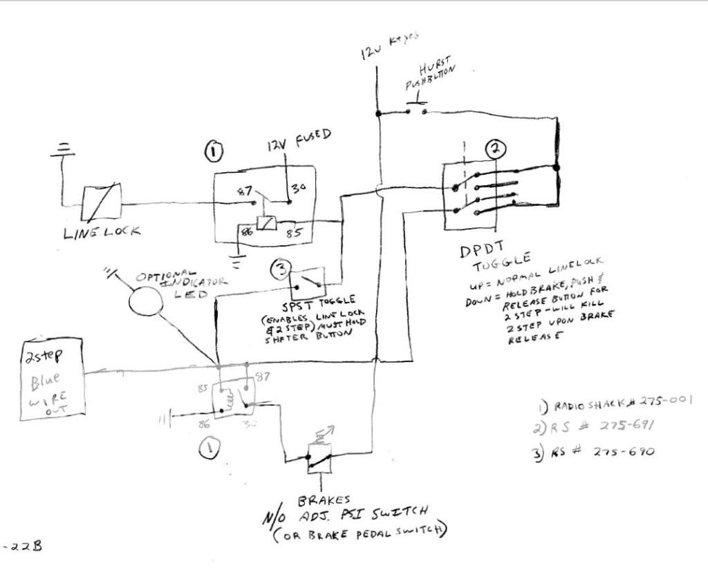

I think I will do this too. I'm going to tie it into my line lock switch so I can have my foot off the brake. Then release button which kills the line lock and rpm limit.

Right, but what I'm saying is you have to take your foot off the brake at the same time you release the button, correct?
I want to hold the car on the line with the line lock only, so when you release the button it releases the brake and the rpms go. Only using the button, no foot.
I took the car out to see what this would be like. I don't think think tying the line lock to the 2 step going to work. In order for the front brakes to be able to hold, even at 2k rpms, you really have to push the pedal HARD. It will hold it, but there is quite a delay from the time you release. Noticable, as in probably a half second. (remember, we are talking about hundreths in reaction times) You need much less brake pressure to hold it on the line with the pedal. The brakes don't release fast like a transbrake...

Simple test, hold the car at 2k with the brake pedal, just enough so that it doesn't move. Let off the brakes and moves instantly. Do the same with the line lock, and there is a significant delay before it moves....
Breese, can you try it and see what yours does in that test?
I have played around with LL and it will hold my car at 2k without issue. I bought a good micro switch button when I originally installed my LL about 5 years ago. When I let the button go it is quick to release the front brakes. I don't notice any delay.I think it is not uncommon for people to wire in their T-brake and LL together so the car doesn't roll the beams when staged.

No, I understood. I am using a cheap Biondo. I'm wondering if a more expensive one like a Hurst would have a quicker release time. I might also try a microswitch off the brake pedal with a selector for mode. So operation with my shifter mounted button would be: toggle in pos 1 for burnout, line lock works as normal via shifter button. Toggle in pos 2, shifter button is wired in series with foot brake micro switch and supplies 12vdc to 2 step only. This would allow you to do the burnout as normal with the line lock, then flick a switch, pull up to the line, stage (brake pedal down as you always would footbrake race) hit and hold the button on the shifter and mash the gas. As soon as you lift off the brake pedal, it goes. Then you can let off the shifter button and continue the race. The 2 step would never be able to work unless both the brake pedal and shifter button were depressed.

Holding at 2k with just the line lock (you really have to jam the pedal hard) and releasing off the button, there is a delay before movement.
Holding at 2k rpms with the pedal, and releasing you get instant movement, however there is a delay in the brake switch, the brake booster must hold the pedal from coming back quickly. So the lights stay on for that split second also. Therefor, I don't think an additional switch off the brake pedal would be effective either.
I tested one of my Harleys for electrical response time when releasing the brake. They use a pressure switch in the brake line to run the brake lights. Those seem to work instantly as soon as you release the brake. I'm thinking now a pressure switch in the brake line is going to be the only way to get it to react fast enough, but I would like to install one and see how quick it really is.
I think a latching relay would also be better on the shifter button, then you just stage, hit the button once (with the brakes pushed down) and once you lift off the pedal that's it.
I imagine the line lock delay isn't an electrical problem, but a flow restriction internally?

I installed the 2 step yesterday and wired it just as I show above. It does work as I designed. The only thing to note is the brake pressure switch should be between the master cyl and the line lock.
