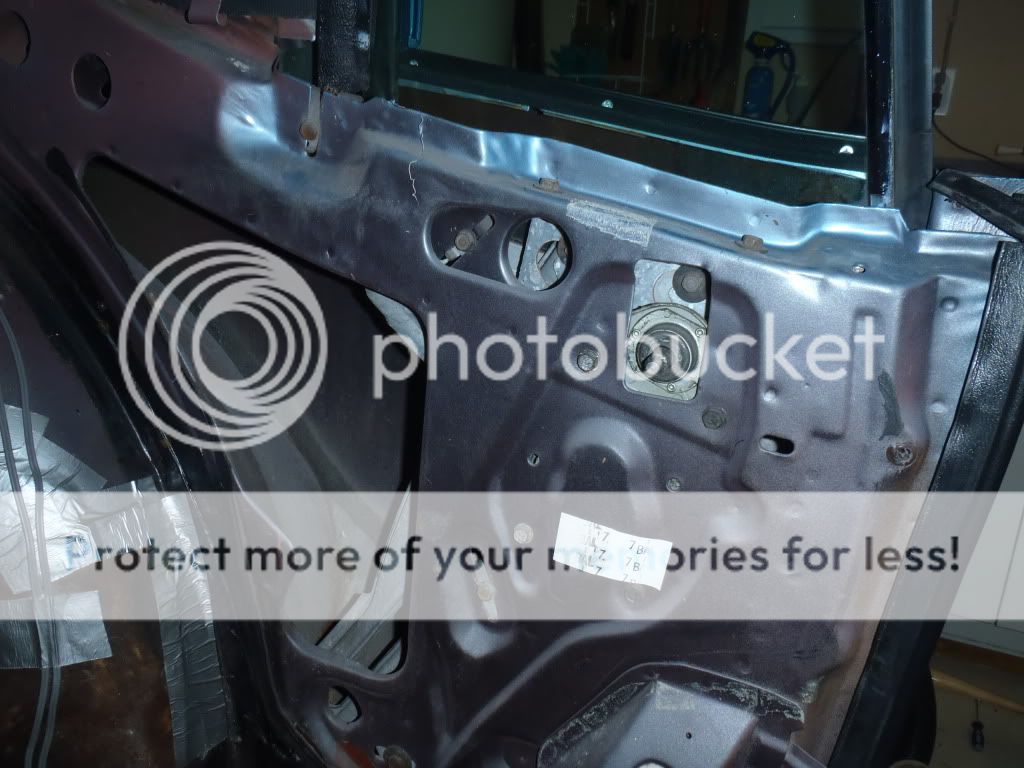

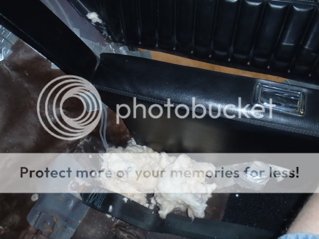

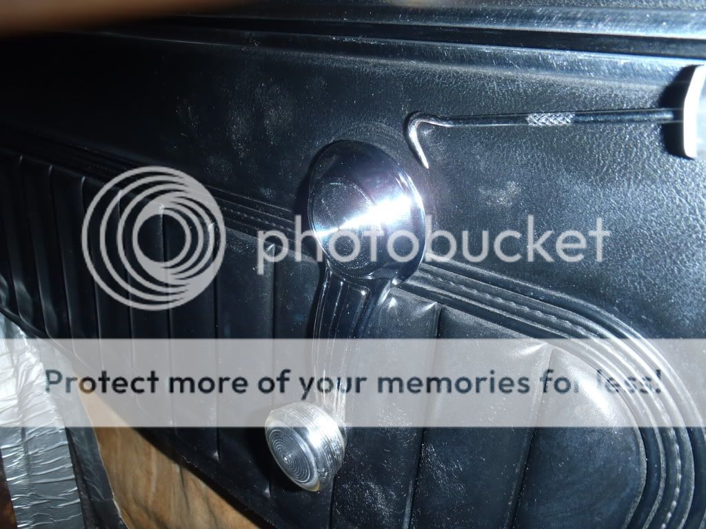

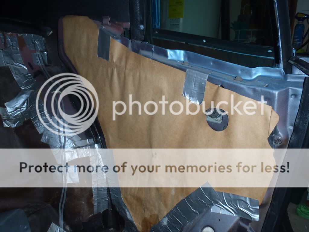

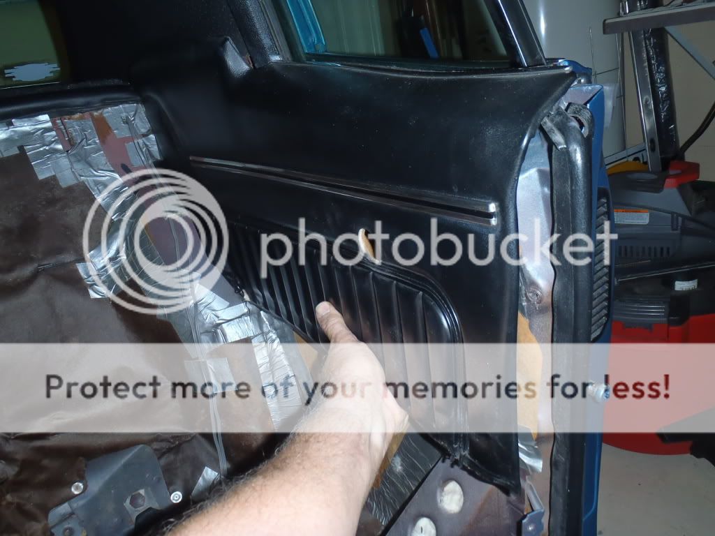

MCfan Posted January 25, 2014 Share Posted January 25, 2014 Hi, Glen, You've already removed the two screws at the front of the armrest so you're getting there but there are a couple more things to do before you can get access to your regulator to service or replace it. First, you need to remove the rear seat back, also. Remove the two bolts shown below and lift the seat back up and off the hanging lip under the edge of the package tray (sounds easier than it actually is). Now you can get to the screw that holds that flat arching trim piece between the back of each armrest and the package tray as shown below. Note that the screw is about in the middle of the arched trim piece. You do NOT need to separate the armrest and the arched trim piece, just lift them out together. (Ignore the white insulation in that photo - a previous owner packed the whole rear compartment with that stuff - I removed it all.) Now you need to remove the window crank in order to remove the interior panel above the armrest. Sounds like you already found the screw at the top of the panel and have removed it, if not, do it now. Now the interior panel should lift right off. If not, check for one more screw holding the far back edge of the panel to the inner wall. Next, remove the vapor barrier to get full access to the regulator. In the photo below, you can easily see the four hex bolt heads that hold the manual regulator in place. If you need/want to remove it, be sure to tape the window in place so the glass won't slide down when you pull the regulator out. It may not look like enough room but it will come out and go back in fairly easily. You may have to put the window crank on temporarily to reposition the lift arm to get it out. If you just want to lube the assembly, you can do that without removing the regulator. Be sure to check the condition of the nylon wheel that runs in the track. As you can see in the photo below, the original lube on those wheels and tracks dries out or wears off over the years and can cause binding or rough operation. You can solve some operational problems by just re-lubing the tracks and wheels with multi-purpose grease. If the nylon wheel is broken or worn flat, your manual window will never work very easily, if at all. You just about have to remove the regulator to replace that wheel. Give me a call at (316) 253-4346 if you have any questions. Good luck! Quote Link to comment Share on other sites More sharing options...

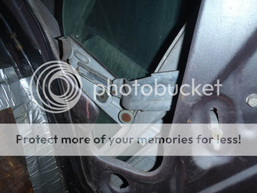

Rock Posted January 26, 2014 Author Share Posted January 26, 2014 here is a pic of the roller. you can see that it is broken and this is the on at the bottom of the glass and runs in the center of the channel. here's the channel. Disregard the beer in the pic. here is a pic of where the roller sits on the bottom of the glass. A pic of the other side intact with the broken guide. Quote Link to comment Share on other sites More sharing options...
Rock Posted January 26, 2014 Author Share Posted January 26, 2014 This is a prime example of the snowball effect!! This started out as replacing the hand cranks and turned into smooth window cranks and replacing guides. As long as everything is out might as well replace the back deck as that is warped and needing replacement. Quote Link to comment Share on other sites More sharing options...
MCfan Posted January 26, 2014 Share Posted January 26, 2014 Thanks for the photos and explanation. Now I understand why you removed the glass and, of course, it's the regulator that will come out the hole in the side not the glass. Looks like you have found a major problem and are well on your way to fixing it. What is the condition of the nylon roller on the end of the regulator's lift arm that fits into the short, nearly horizontal track near the bottom of the window glass? Quote Link to comment Share on other sites More sharing options...
Rock Posted January 26, 2014 Author Share Posted January 26, 2014 It was a little bound up up but in decent shape. Once I replace the center channel guide it will work like new when everything is greased and lubed. I marked where all the bolts where before disassembly so putting it back together shouldn't be a problem. Quote Link to comment Share on other sites More sharing options...
