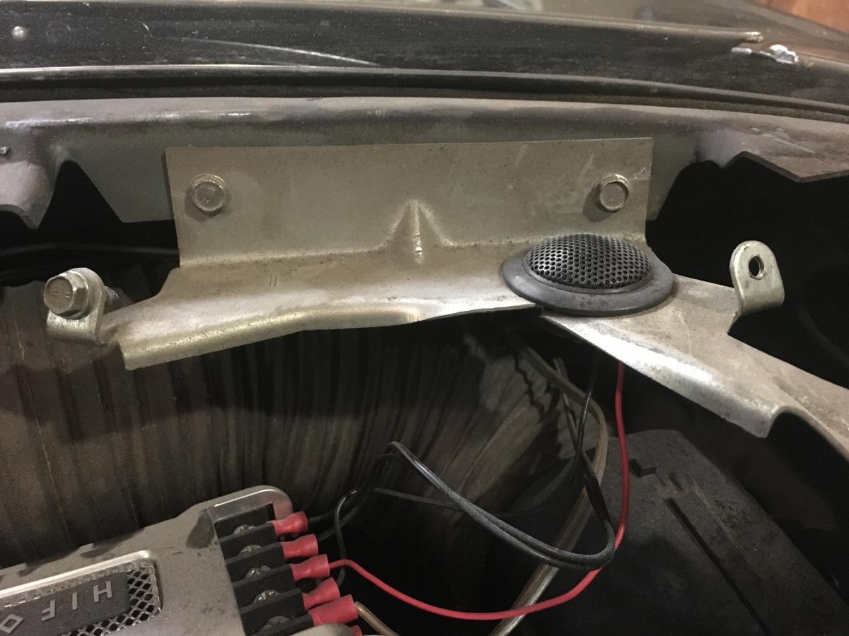

Rock Posted March 13, 2017 Share Posted March 13, 2017 I found that with the limited space you have under the dash I decided to use component speakers. I added kick panel bass speakers and added the tweeters in the space in the dash. Quote Link to comment Share on other sites More sharing options...

Rock Posted March 15, 2017 Share Posted March 15, 2017 If you need more let me know. Basically I bought the pre molded kickpanels and added 6 1/2" speakers. Then I added the tweeters and the filters under the dash. It sounds real good. The highs are up around ear level and the lows are low. You can stuff speakers under the dash but you will never get the larger magnets inside the drivers side. Quote Link to comment Share on other sites More sharing options...

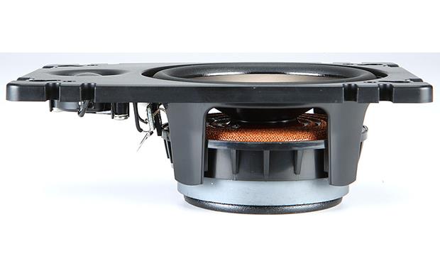

snomobeelr Posted March 18, 2017 Share Posted March 18, 2017 I like the kick panels but I saw these Polk Audio db461p , 4x6 speakers. They are offset wondering if they might work? https://www.crutchfield.com/p_107DB461P/Polk-Audio-db461p.html?tp=105 Quote Link to comment Share on other sites More sharing options...

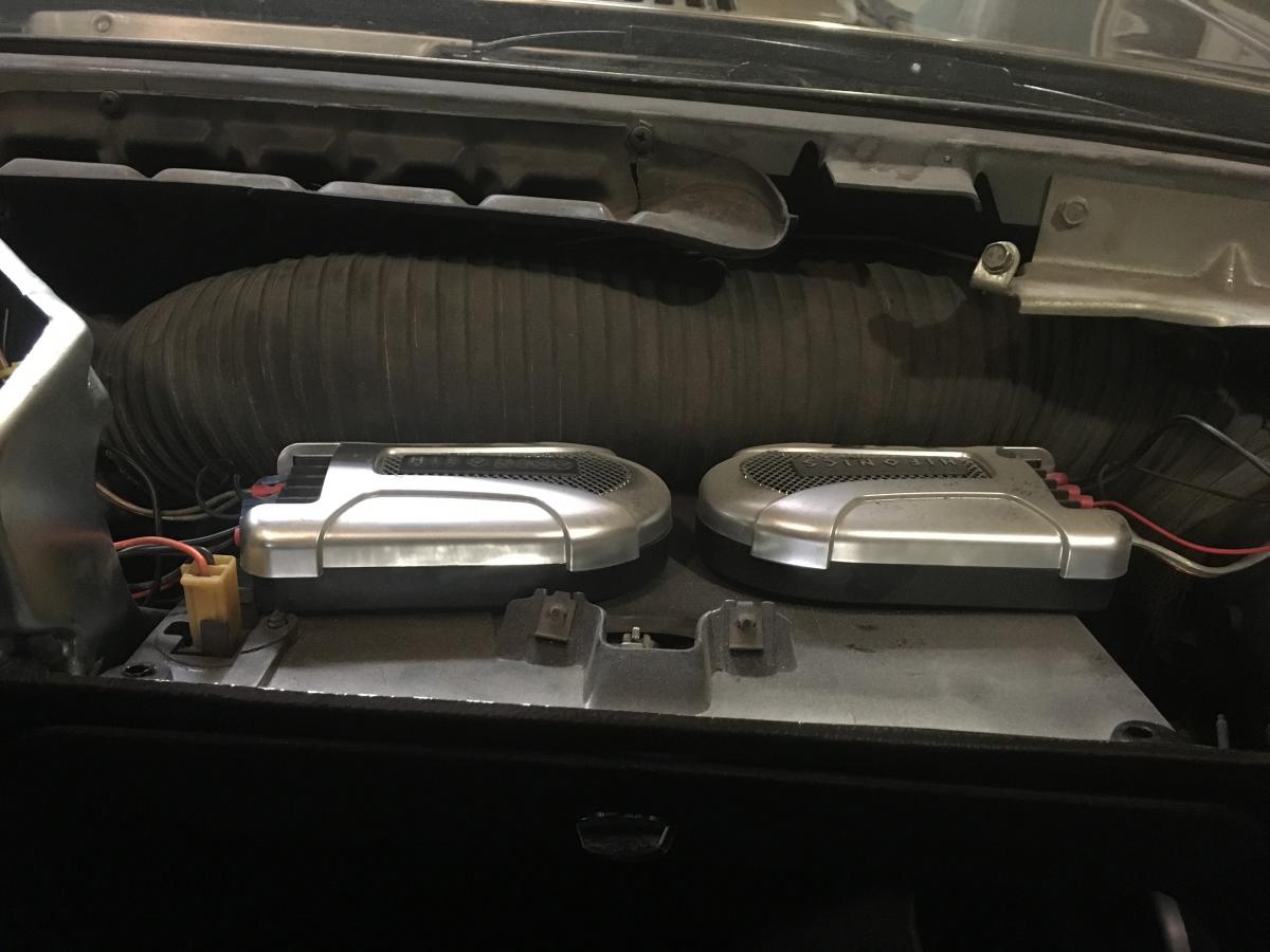

monte70car Posted March 18, 2017 Share Posted March 18, 2017 Here is whats in my flea market find 4" speakers, The JBL speakers Then I updated the kick panel to 6.5" speakers 6x9 in the back deck and then there is 2 10" subs pointed to the back seat and if your wondering that box was brought from Best Buys for a Dodge Ram pick up, it fits that area like it was designed to go there. Some where I have a video of the radio playing. Quote Link to comment Share on other sites More sharing options...

Dito707 Posted March 18, 2017 Share Posted March 18, 2017 Snomobeeler, OPG has speakers designed to fit inside of the Monte Carlo dash. Quote Link to comment Share on other sites More sharing options...
