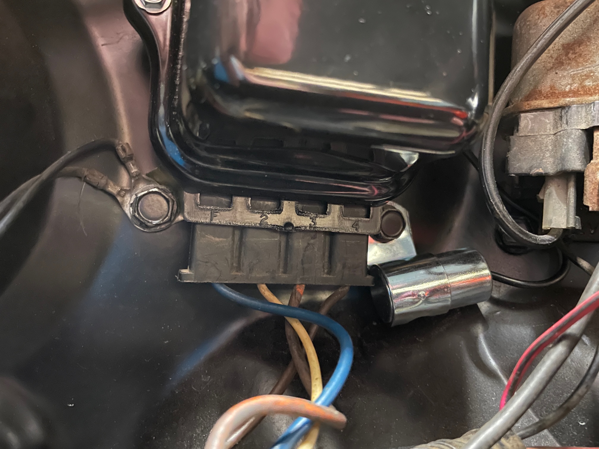

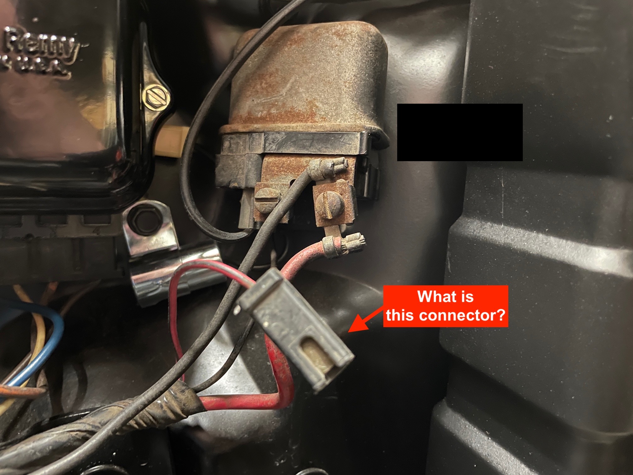

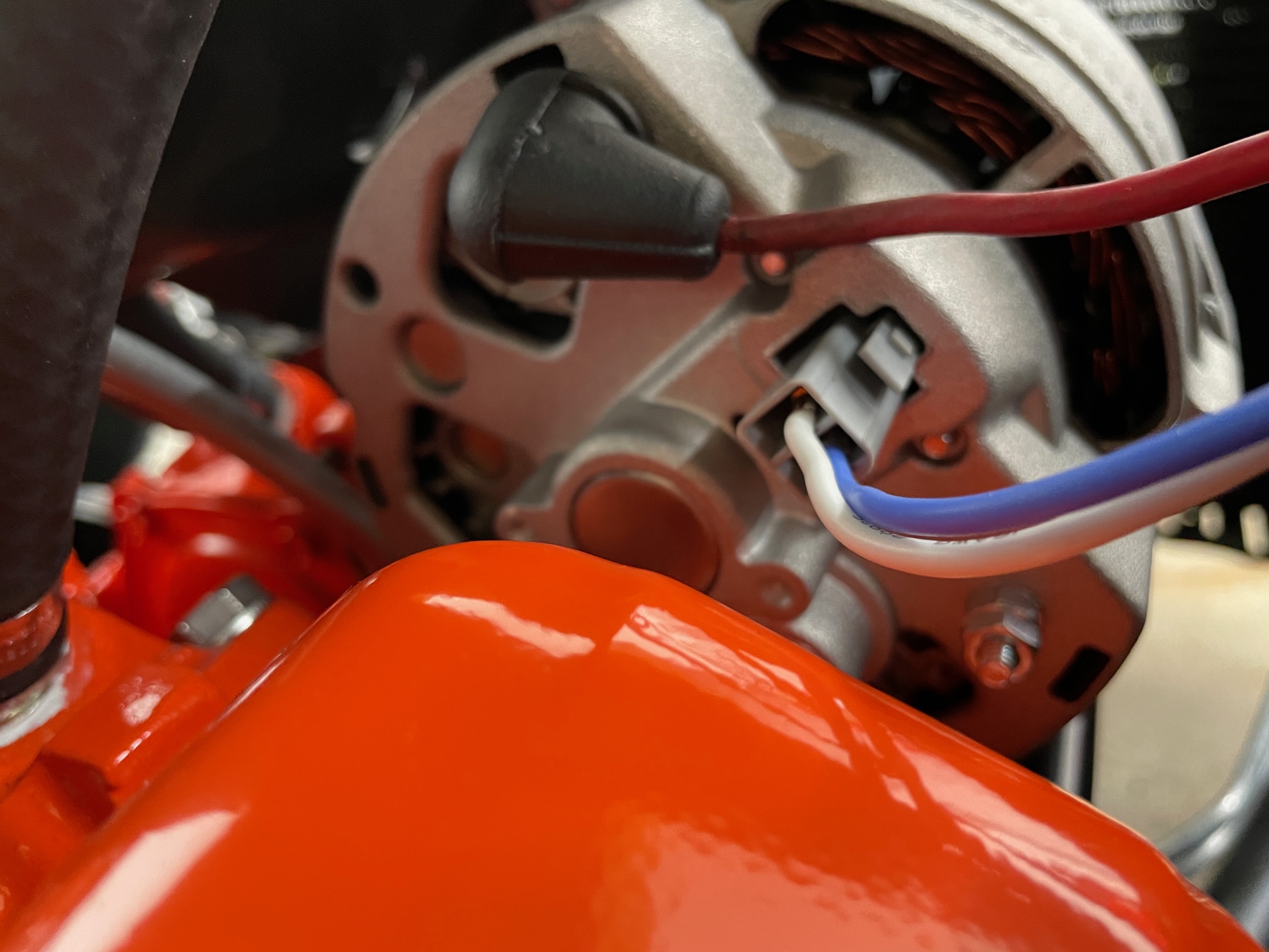

TheBMan Posted April 25, 2023 Share Posted April 25, 2023 Hey guys. The 70 MC that I purchased had an internal regulator alternator on it. I put it back to stock with a new external regulator alternator (three wire) and new external voltage regulator. I am seeing 16+ volts at idle. I looked at the wiring diagram for the car and made sure that the blue and white wires run to the regulator and have continuity. The F wire (blue) is hot with the key on. I read that the other wire should be hot all the time. Is that with key on or off or both? My white wire is never hot. I have Googled and Googled and Googled and what I can't confirm is which terminal is which on the alternator. Mine is not labeled F and R (or 1 and 2) as some are. You can see in one of the photos how I currently have it connected. Also, trying to figure out what the disconnected wire is as seen in one of the attached photos. Is this related to the charging system? It was this way when I purchased the car. Any help is appreciated! Quote Link to comment Share on other sites More sharing options...
jft69z Posted April 25, 2023 Share Posted April 25, 2023 17 minutes ago, TheBMan said: Mine is not labeled F and R (or 1 and 2) as some are. Looking at the alternator, R will be on the left, F will be on the right. 1 1 Quote Link to comment Share on other sites More sharing options...
TheBMan Posted April 25, 2023 Author Share Posted April 25, 2023 4 minutes ago, jft69z said: Looking at the alternator, R will be on the left, F will be on the right. Thanks Joe. That means I have those wires correct. That's one thing I can eliminate as the possible problem. 1 Quote Link to comment Share on other sites More sharing options...
jft69z Posted April 25, 2023 Share Posted April 25, 2023 A factory service manual has all sorts of very detailed troubleshooting information for that charging system. May be a good investment to pick one up (PM me). 1 Quote Link to comment Share on other sites More sharing options...
TheBMan Posted April 25, 2023 Author Share Posted April 25, 2023 1 hour ago, jft69z said: A factory service manual has all sorts of very detailed troubleshooting information for that charging system. May be a good investment to pick one up (PM me). You're absolutely right, I do have a manual and I just got done reading the test procedures. I put a test light on terminal F and 4 at the regulator; the test light lit up. The manual says that means a bad regulator. I have [another] new one coming. I'll install and re-test. 2 Quote Link to comment Share on other sites More sharing options...
TheBMan Posted April 25, 2023 Author Share Posted April 25, 2023 @jft69z Problem solved. I replaced the new voltage regulator with another new unit and the voltage is now 14.3. Perfect. I was questioning myself in this entire process because I had the re-convert the car back to external regulator and had to fix some wiring, which isn't my strong suit. That said, your tip to check the manual (duh) was the closer. Appreciate the tip and the help. Sometimes we just need a little nudge. 😉 3 Quote Link to comment Share on other sites More sharing options...
