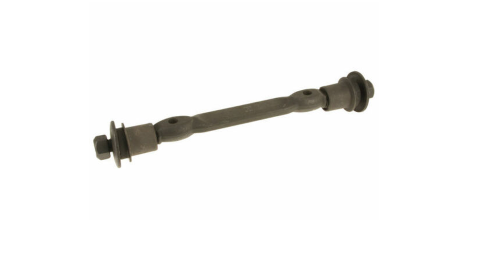

Has anyone had experience with an offset version of the front upper control arm shaft ?  I'm trying to set my castor alignment to get into the positive range of 3 to 5 degrees without screwing up the Camber or changing the upper control arms. I've also seen versions of offset bushings, but don't care for the idea. Any help would be appreciated.
I'm in the learning stage and have access to a complete alignment machine at our military hobby shop. One of the members suggested I change the upper control arms to achieve the increased positive castor. After doing some research I found that offset shafts are available.

The offset shafts are more for fixing the effects of frame sag, where the upper control arm mounts are pulled toward each other. They affect the front and rear stud evenly, while you need to pull the rear of the control arm in to get positive caster. Anything more than 2-3 degrees of positive caster will probably be tough with stock control arms.

 Open to suggestions…. Thoughts and ideas…   Are there any negatives to using the offset shaft to achieve better Castor numbers ????

The odd thing was me (the dummy) using alignment adapters on the wheels to slide over the Rally caps.. Today I removed the Rally caps and didn't use the plastic alignment adapters…
Now I have sane numbers and will be able to shim into the positive 3degree side using the stock arms and shafts… All steering parts, bushings etc are in great shape except for the passenger uppers and some wear on the drag arm. The steering box, ball joints, tie rod ends etc, and all other bushings front and rear are in excellent shape.
Apparently those two upper bushings took a beating or were improperly installed and the arm slide back just enough to cause the car to slightly favor the right side of the road and create a slightly negative castor reading….  It was almost impossible to see because they appear perfectly centered.
I'll replace these parts and see if I can improve the castor and camber with the stock arms and shaft.  No offset needed now..
