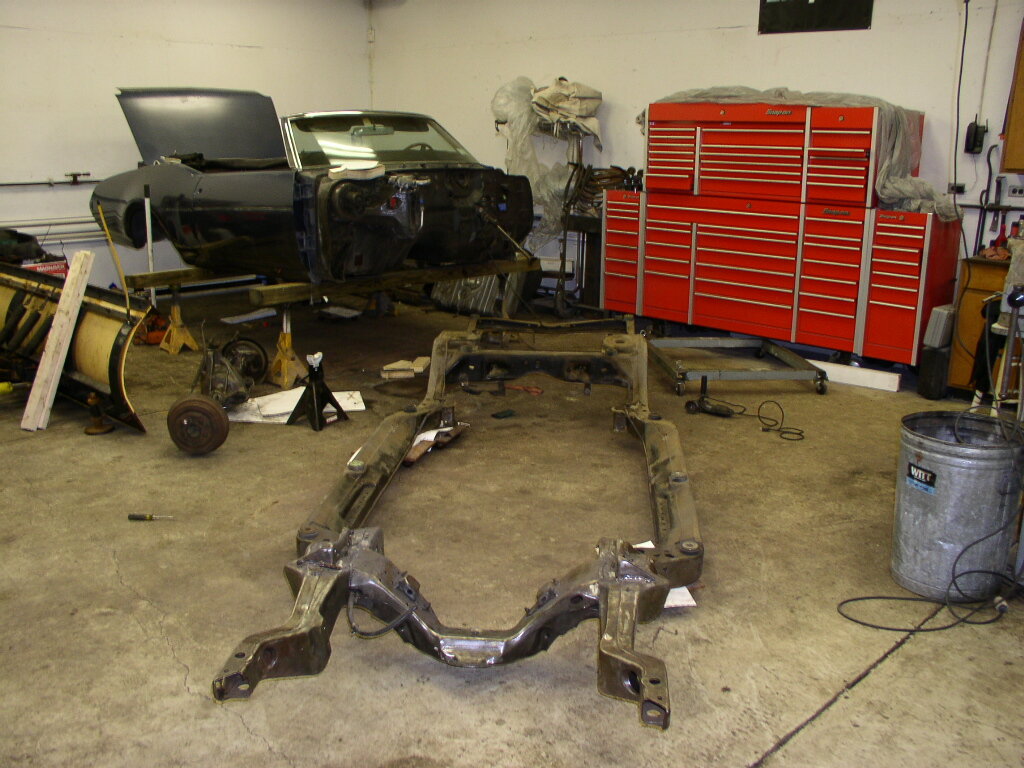

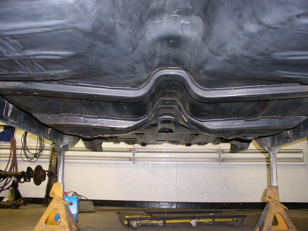

jft69z Posted September 8, 2023 Share Posted September 8, 2023 Are you looking for something that's movable, or just stationary storage? Before I got the body cart to move & store the shell, I'd just use a couple 4x6's and jack stands to put the car body on. I've also just used the jack stands on the 4 corners of the pinch welds with no problems. You can see the 4x6 at the front & rear, supported by the stands: Just the stands: With a body cart to move the shell around: 3 Quote Link to comment Share on other sites More sharing options...
