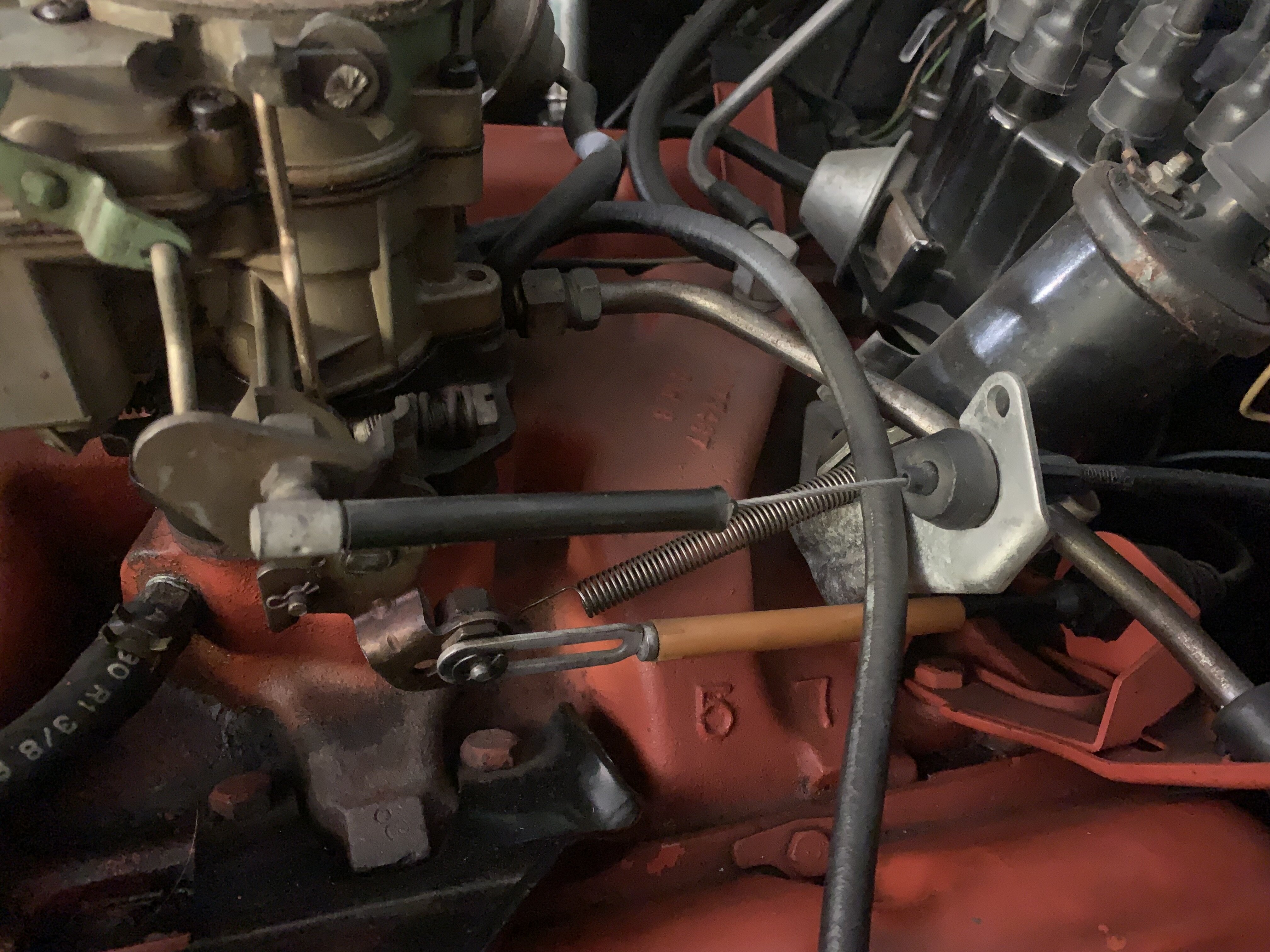

My ‘70 350/350 has a trans leak. Went under and found the shifter seal leaking. $14 from Amazon with the tool 👍 While I was looking for the leak I noticed on the passenger side that the kickdown cable is connected to the trans but the top end is swinging in the breeze. Where does the other end connect to?

So the tool and seal come tomorrow. That was just part of the story of why I was under there. I’m looking to see where the kickdown cable attaches. It seems to be about a foot too short to go to the drivers side of the carb

When I get back to the car I can send a photo of the hook up. I’m not sure how helpful that will be if yours is a foot of reaching the carb. Is there some kind of end on the cable?
The end of the cable has a rectangular slot on it. It might reach I haven’t actually tried it just seems short. I’ll try to run it up to the carb while I’m working on it this weekend

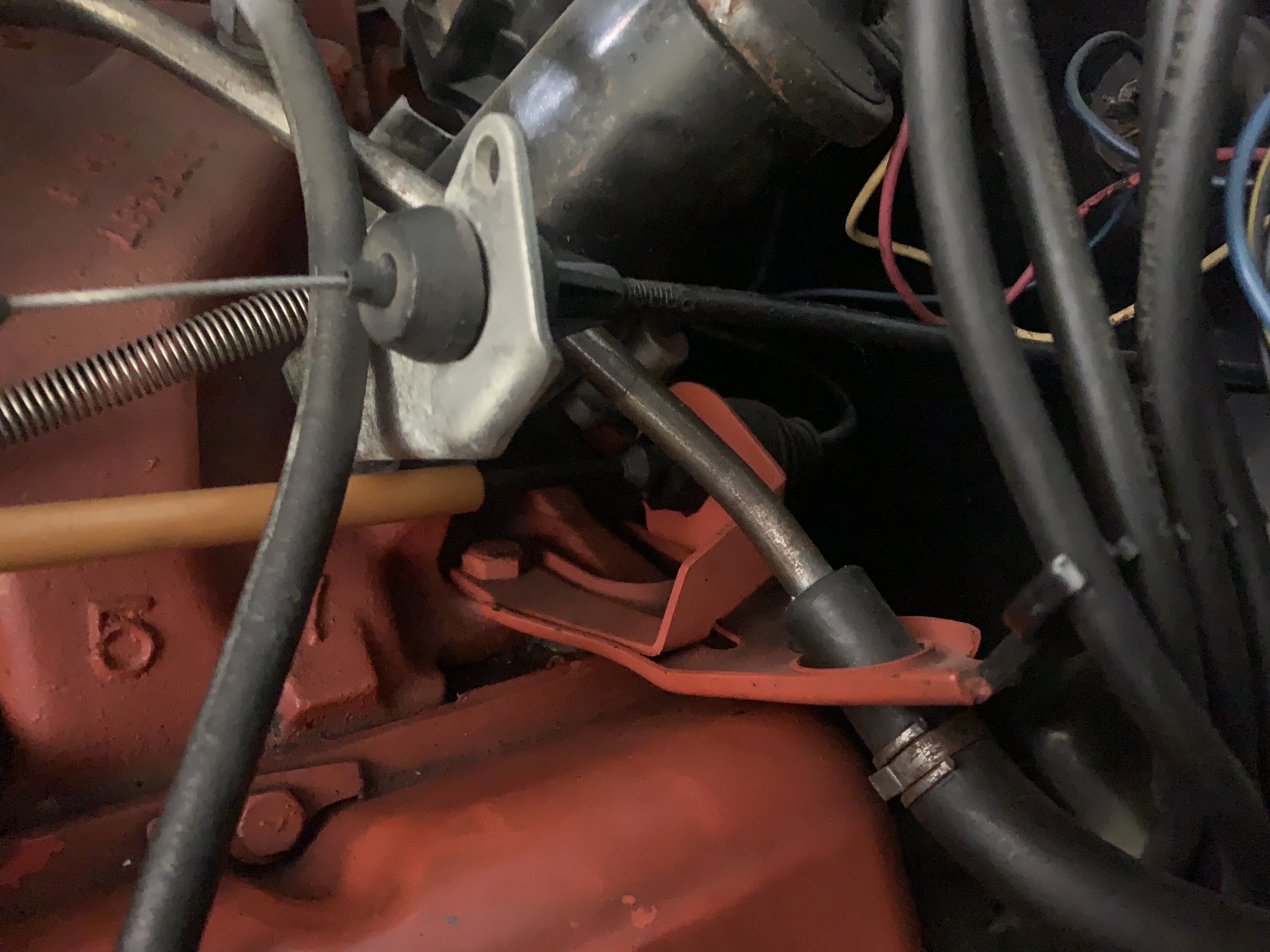

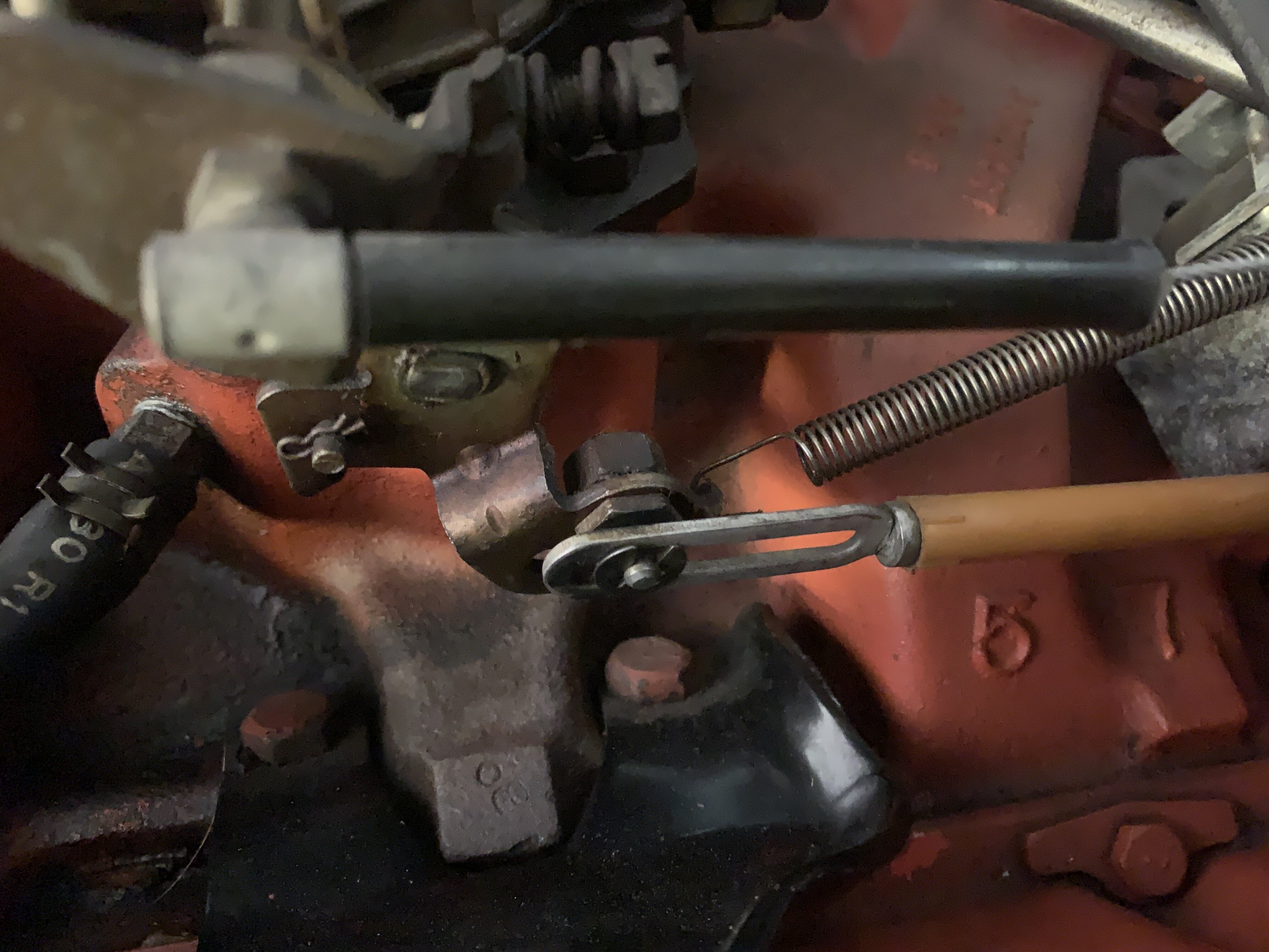

I added cruise control to mine about 30 years ago so there are some differences. Hope this helps some.
