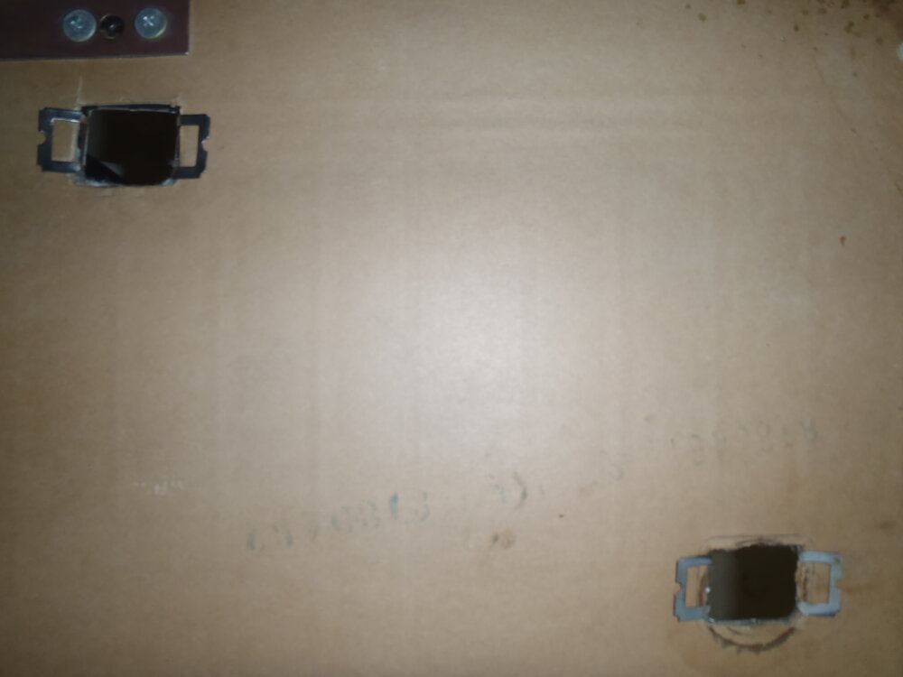

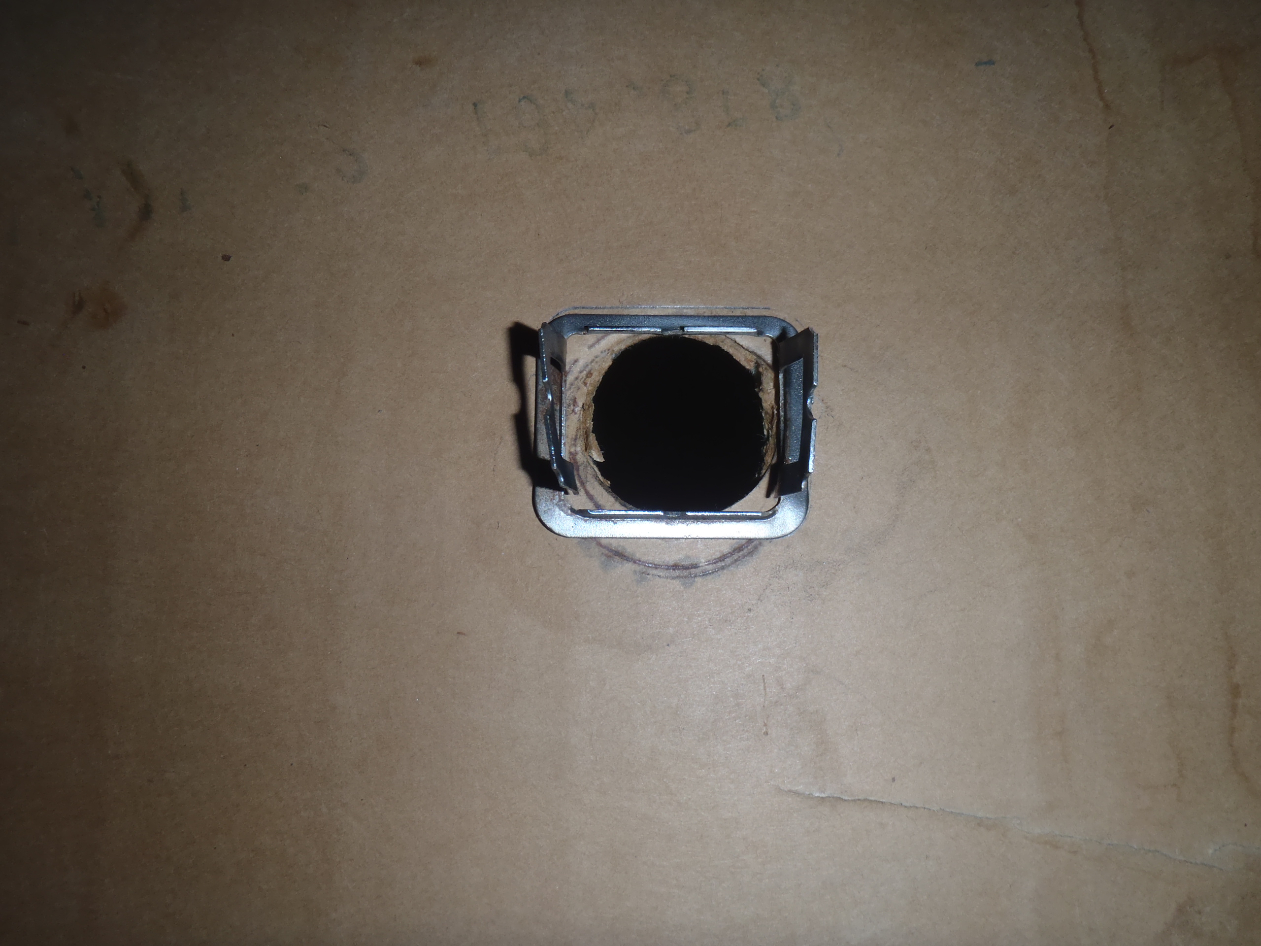

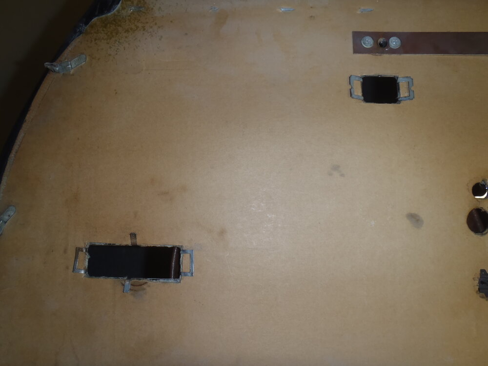

MCfan Posted June 28, 2021 Share Posted June 28, 2021 3 hours ago, Dtret said: You may also need door panels I was able to use the existing door panels by installing the switch housings at the same location of the previous hand crank opening (photos attached). I had factory power windows on my other '70 and the switches were in exactly those same locations. I also installed factory power door locks at the same time and those switch locations were actually shown with an indented outline on the backside of the door panel. 1 Quote Link to comment Share on other sites More sharing options...
