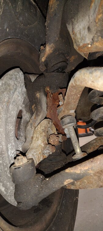

B-Man Posted November 14, 2023 Author Share Posted November 14, 2023 Update ... new rear coil springs and isolators installed. Much easier with the borrowed set of spring compressors, for sure. I was really tempted to drop it down and see the stance but I've got more work to do while the jack stands are giving a gravity assist. Onto the front end - SWEET MERCIFUL CRAP!!!!!!!!!! I had no idea the front end was in as bad a shape as it is. I mean, check out that passenger side upper ball joint. Geez! I guess I'm in the market for a front end rebuild kit. Onward and upward! 1 Quote Link to comment Share on other sites More sharing options...
cny first gen 71 Posted November 14, 2023 Share Posted November 14, 2023 Not sure how far your going on front end or how experienced you are but some parts of that can be very dangerous, be very careful! 1 Quote Link to comment Share on other sites More sharing options...
