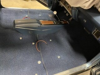

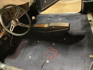

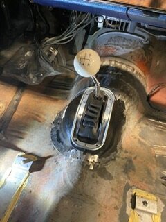

70white402 Posted July 23, 2023 Share Posted July 23, 2023 Yes it’s well worth it. I have a 70 402/400 turbo ans went with the 5 speed. I put a 3:73 in the rear. I did switch the 402 to a 496. Rocket ship! Quote Link to comment Share on other sites More sharing options...

70white402 Posted July 23, 2023 Share Posted July 23, 2023 9 minutes ago, 201fireman said: Yea I have a 489 with a TH400. I so want to do it but wasn't sure. That's a pretty hefty cost. Did you get a conversion (kit) from a company and if so, who? Or did you just buy the trans and piece the rest together. I bought from silver sport transmission also. Quote Link to comment Share on other sites More sharing options...
70white402 Posted July 23, 2023 Share Posted July 23, 2023 Quote Link to comment Share on other sites More sharing options...
