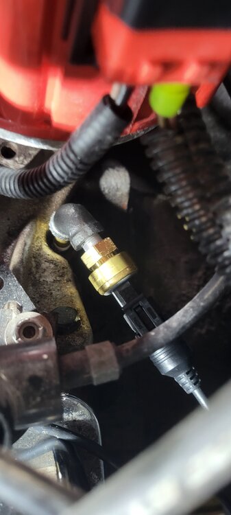

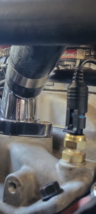

BobW Posted February 18 Author Share Posted February 18 Yesterday's start of installation went fairly well. Began by removing the 3 mechanical under dash accessory gauges to install the DD sending units and cables. Speedo and oil pressure senders installed easily. Temp sender not so much! The Jegs 4 bbl manifold has the sender directly under the hose, and the height of the sender doesn't clear the hose. Tried installing the sender in the side of the block but again, the height of the sender was within 1/4" of the header! Solution: Found a 45* swivel thermostat housing on Summit, I'll get a pic when it's installed. https://www.summitracing.com/parts/sum-371100 Today's plan is the get the old gauge panel out and get the wiring run to where I plan to mount the box on top of the glove compartment. 3 Quote Link to comment Share on other sites More sharing options...

BobW Posted February 26 Author Share Posted February 26 Finally got some pics showing the new thermostat housing and DD temp sender, plenty of clearance now. 2 Quote Link to comment Share on other sites More sharing options...
