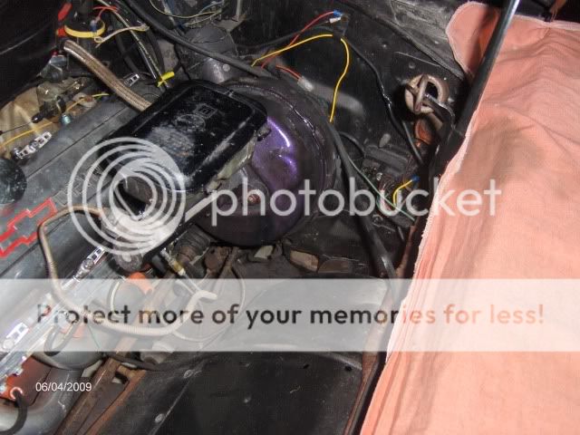

Little update. I have a new master and booster coming, because mine was starting to go bad, and for disc / disc you should have a master with equal size reservoirs, and the stock one does not. I am getting a 8" dual booster and master from CPP (Classic Performance Products) but I ordered it off eBay from their eBay store and saved around $100.

The big brown truck showed up today! CPP upgraded me to a chrome master and booster because they sold too many on the eBay ad. grin So for $197 shipped I think I got a great deal!
Now to get it installed! Updates to follow!
Ian, make sure you remove the master cylinder from the booster and bench bleed it before installing. You may already know that but figured I would remind you. - Dave
Ian, you still need to bleed the master cylinder. It is not hard at all. Air bubbles can get trapped in areas and not allow for the fluid to flow as required. Some do not require many pumps and still others require a good number of pumps. Just remove the nuts that hold the MC and put one ear of the MC in a vise. Make sure the MC is level. The MC probably came with plastic tubing to go from the reservoir to the exit fittings. Some one man bleeding kits come with this tubing as well. Fill the reservoir and push the piston in and release(pump slowly, rapid/hard pumping may send fluid everywhere). I use a phillips screw driver with protection between the piston and the head of the screw driver. Once there are no bubbles showing when you pump it, it is bled. I have had some only take 5-7 pumps. My current Wilwood Alum MC took about 30 pumps.
It is also wise to already have the booster on the fire wall, that way you can take the MC, with the fluid still in the reservoir and install it on the booster. For the most part, pressure or gravity bleeding brakes is for the lines, caplipers, and cylinders. I would not recommend trying to bleed the MC while you bleed the whole brake system. Some may have done it this way and may of had this method work. I would say they got lucky or the brakes are still not functioning 100% properly.
It may seem like a pain to do it this way but we are talking about your brakes and it only takes 15-20 minutes or extra time. - Dave
Thanks guys! Yeah Allan I bought one to do the new rears as you have to unmount them to get the bleeder to face up to get the air out. It works nice, but don't leave it under the hood and start the engine (another ask me how I know) frown Brake fluid all over the engine!!!
It stops good! I need new front pads and calipers now (got a little pull) I am going to go semi metallic this time. I can lock the rears now, which I could not do all the time with the drums, but I think the master was part of that problem. I am happy with the kits fit and function. I know Drum brakes will work OK, but I like the look and over all all the new parts work better.
Finally took them out of the camera grin It was dark when I got done. I'll try to take a few more later.
