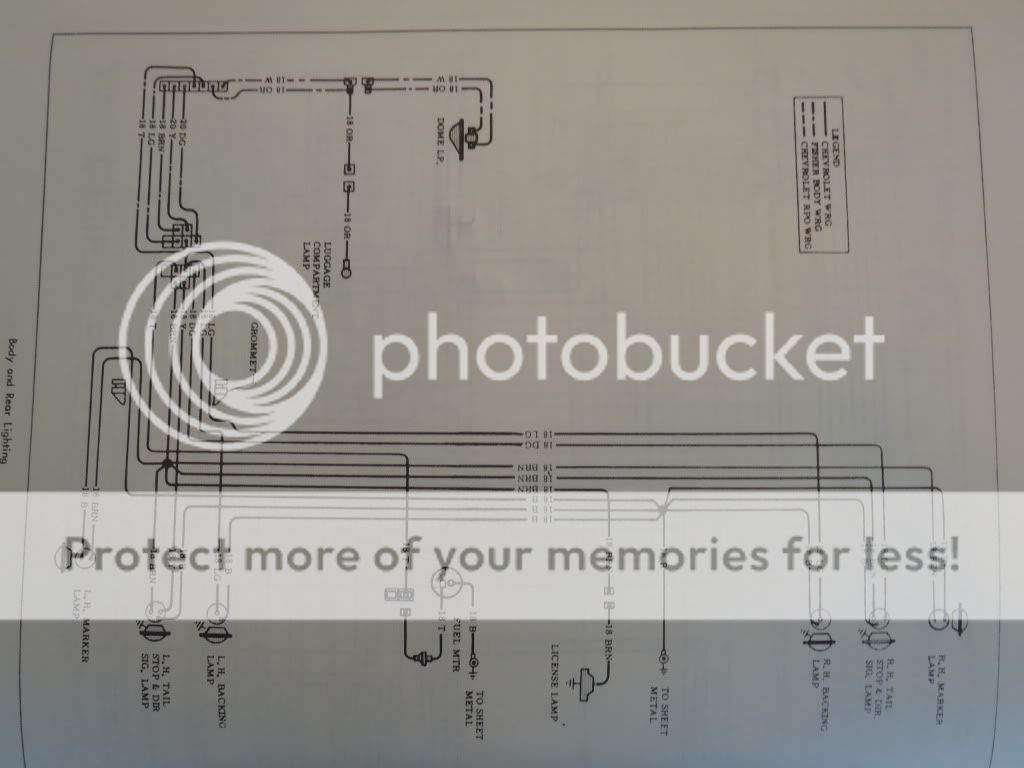

Murph Posted February 23, 2013 Share Posted February 23, 2013 I am trying to trouble shoot my brake lights and signals. Does anyone know where I can find a wiring diagram for a 1972 model on the internet? Quote Link to comment Share on other sites More sharing options...
MCfan Posted February 23, 2013 Share Posted February 23, 2013 Hi, Patrick, Here's a page from the '70 Wiring Diagram Manual that might get you started. I can't imagine that anything as basic as rear lighting changed between '70 and '72, but maybe it did. If you need to see any of the other pages in the manual just click on this link: 1970 Wiring Diagram Manual photos Good luck resolving your problem. Quote Link to comment Share on other sites More sharing options...
