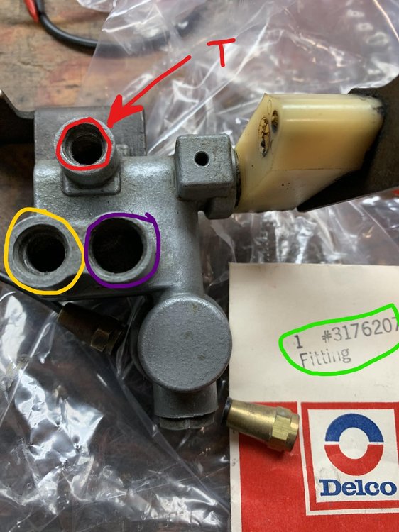

so I found these fittings on ebay for the air lines, but need the ones that go in between them and the valve, looking a pictures think I need a T on top and single on bottom and what about the exhaust? anyone know the sizes or a part number?

hello sendo,
                         if you do a search under load leveling valve  there should be pictures of what you are looking for.   yellow, intake port  red, t fitting lift port   purple, exhaust port    3/8 24 threads. o ring under all fittings into the body.

went to lowes and home depot and could not find anything. what kind of fitting are these? lowes only had compression fitting and reg pipe. are these iff?

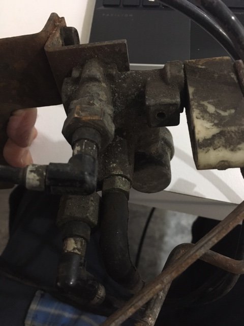

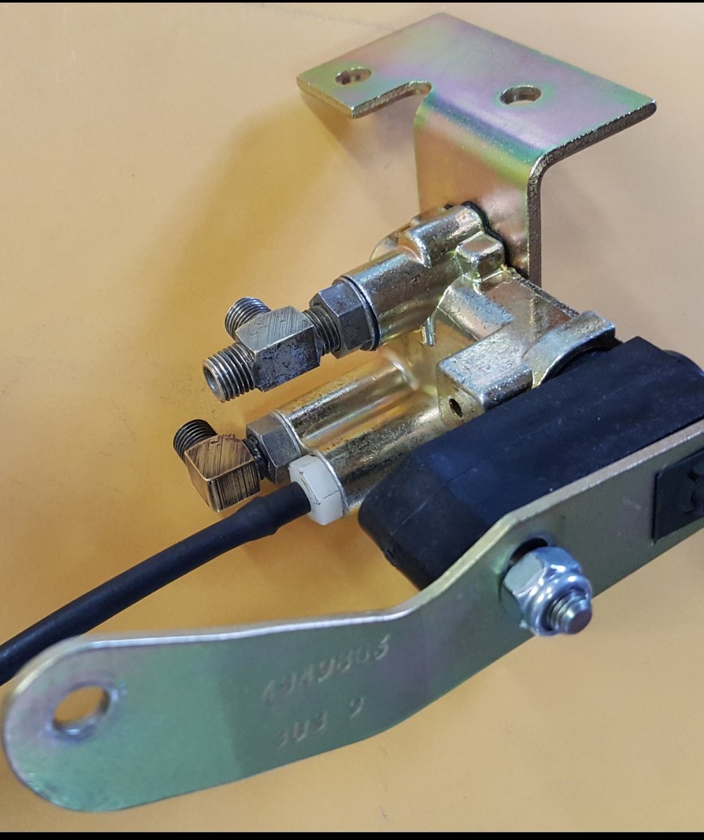

Rosendo, these are the only pics i have, its a Caddy unit and not sure if the line are the same but this is what i have. hope it helps.
If you need more pics, let me know.
Posted
Willie, those fittings aren't correct for the Monte.
