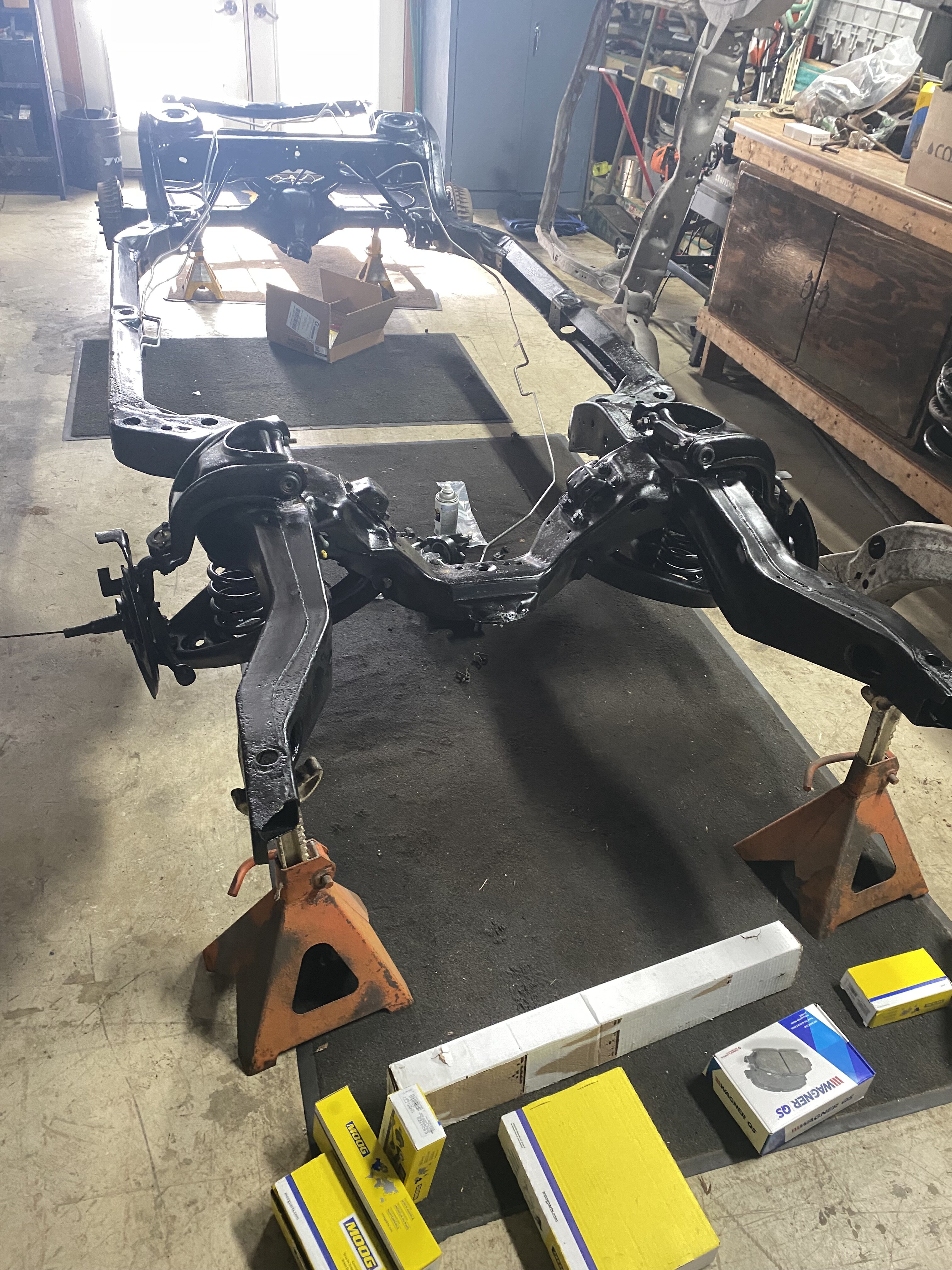

Gothamsproblem Posted December 18, 2023 Author Share Posted December 18, 2023 2 hours ago, Searsman said: Welcome to the club Adam, lots of friendlyβcrazyβ old farts here . Love the garage,, nice and well organized, looks just like mineΒ All good workspaces are a mess right lol. It's actually my buddy's garage. So me not being so mechanically inclined for shouldering most the weight of the mechanics I'm trading him my 88 Monte (which he's LS swapping ATM.) For the work on the 70. Sure is beautiful seeing that car 28 years apart!Β 2 Quote Link to comment Share on other sites More sharing options...
