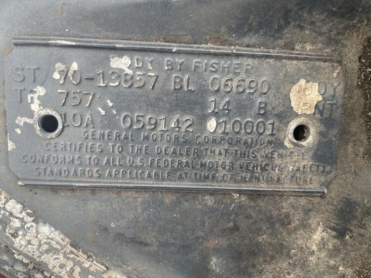

Roger OrtizJr Posted March 29 Share Posted March 29 How do we decipher our cowl tags. I've had my Monte for 4 and 1/2 yrs. I've done some small projects on the car. I noticed when I bought the car that the cowl tag and vin # are different. Also the number on the front of engine block has been milled off except for an "H" and it looks to possibly be last letter.LOOKING FOR HELP. THANK YOU. Quote Link to comment Share on other sites More sharing options...
Canuck Posted March 29 Share Posted March 29 Here’s some decoding pages. Note that the last 6 digits of your VIN are not going to match anything on the body tag. https://www.firstgenmc.com/forums/index.php?/resources/decodingbodytag/ https://www.firstgenmc.com/forums/index.php?/resources/decodingengine/ 5 Quote Link to comment Share on other sites More sharing options...
Glen Posted March 29 Share Posted March 29 Hey Roger, dumb question…do you know if the motor is original to your car? Means a lot if you plan on using the link Aaron provided to (possibly) make that determination. Good luck! 3 Quote Link to comment Share on other sites More sharing options...
Scott S. Posted March 29 Share Posted March 29 Wasn't there another thread on the site that determined that an "H" stamp meant it was a factory replacement ?? Quote Link to comment Share on other sites More sharing options...
RichG Posted April 12 Share Posted April 12 Factory Replacements were coded CE for Chevrolet Engine along with a number that correlated to the warranty claim. The number itself had nothing to do with the car per se, just the warranty claim. Quote Link to comment Share on other sites More sharing options...
