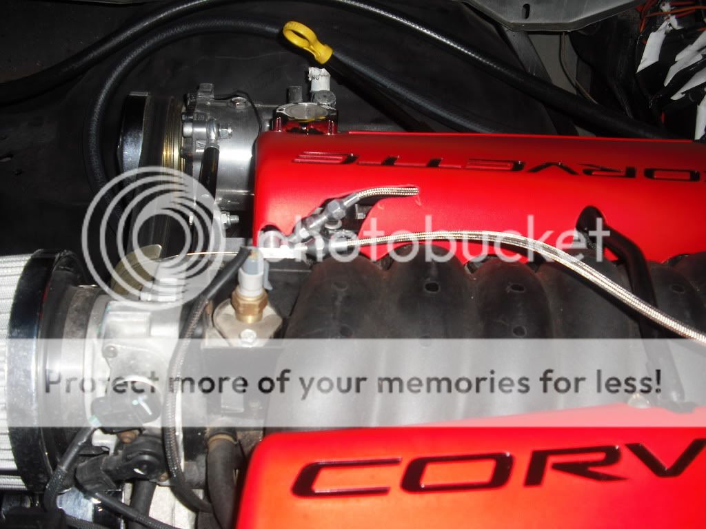

kc8oye Posted October 18, 2010 Share Posted October 18, 2010 there is no throttle linkage to an LS engine.. it's Drive-by-Wire. unless you are goin with a carb. Quote Link to comment Share on other sites More sharing options...
Shadow Gray SS Posted October 18, 2010 Share Posted October 18, 2010 I believe Chris' has a throttle cable for the efi Quote Link to comment Share on other sites More sharing options...
Jared Richey Posted October 18, 2010 Author Share Posted October 18, 2010 there is no throttle linkage to an LS engine.. it's Drive-by-Wire. unless you are goin with a carb. yeah they are, my friend has one of those pre 2002 Camaros and it has a linkage. Quote Link to comment Share on other sites More sharing options...
Montecruiser Posted October 18, 2010 Share Posted October 18, 2010 I believe Chris' has a throttle cable for the efi Yes, mine has a throttle cable from Lokar. It mounts up alongside the trans kickdown cable. I had to cut into my fuel rail covers for that one. I routed the throttle cable accross the top and over to the drivers side where it goes through the firewall to the gas pedal. Quote Link to comment Share on other sites More sharing options...
