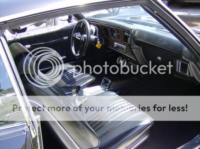

FASTSS454 Posted April 30, 2012 Share Posted April 30, 2012 Buy a hog ring pliers and a box of rings, and new seat foam because the old stuff will fall apart on you. Let the new seat covers sit in the sun for a few hours to soften them up. This is a job anyone can do if they take their time. I did mine here is a shot of it. Link to comment Share on other sites More sharing options...
