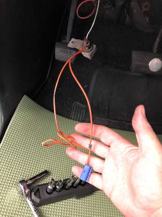

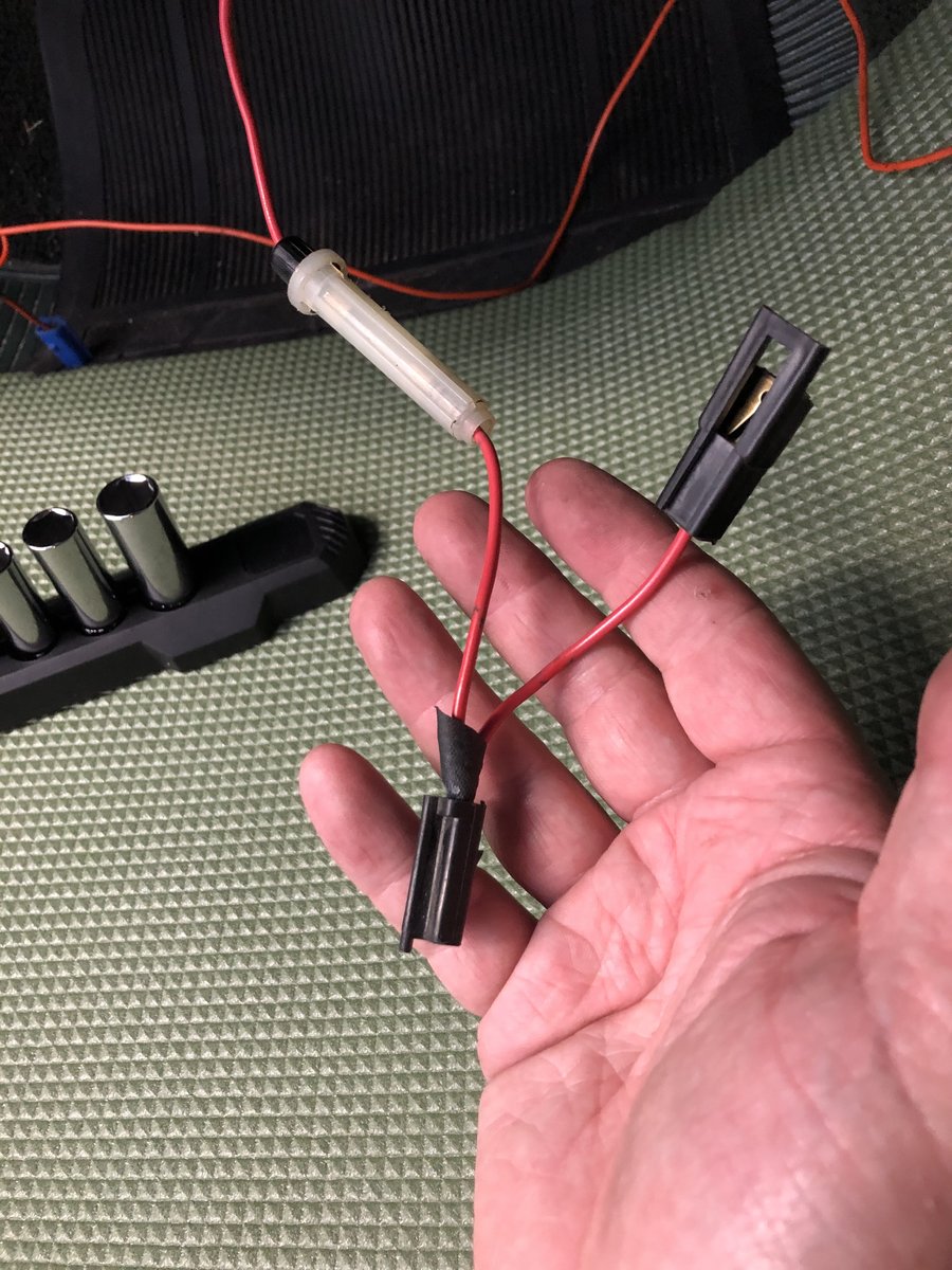

gdubya Posted April 12, 2020 Share Posted April 12, 2020 Need some help. The pass side courtesy lamp is spliced into the driver side lamp and then someone added a connector to plug it into the fuse panel. This cannot be correct. Wiring diagrams show both coming from the splice behind the instrument panel. Picture attached. The rear Defog is throwing me for a loop. The purple wire goes to the trunk as expected but coming off the switch is the inline fuse and two connectors. The male one was plugged into an orange wire behind the ac controls that I traced back to the splice behind the IP. The female end was not connected to anything. I thought the defog was plugged into the fuse box but the connector is wrong. Is the orange wire supposed to be for the courtesy lamps? Pic attached. Quote Link to comment Share on other sites More sharing options...
RealRed70 Posted April 12, 2020 Share Posted April 12, 2020 That does not look exactly like it did from the factory, but it will work. The orange wires from the courtesy lights on the driver and passenger side should go into the blue female connector as you said. From the factory there would have been a short orange wire with a male connector on it like the red wire for the defogger has. Plug that blue female connector into the fuse box in the Bat. position. Slide it over the made spade in the fuse box. The red power wire for the defogger goes in the ignition position, which is two spots down from where you just plugged in the courtesy light power wire. The extra plug on each of those wires is in case you have more power options to plug in. There are only so many spaces on the fuse block. Quote Link to comment Share on other sites More sharing options...
gdubya Posted April 12, 2020 Author Share Posted April 12, 2020 Thanks Red The defog wire was originally plugged into an orange wire behind the ac controls and not into the fuse box. Is that the short orange wire you are talking about? I think that is where the original courtesy lamps may have plugged into. If that is the case, where can I find replacement connectors? Not sure the connector on the defog will plug in as it is a different style of connector. Not sure the defog harness is original to the car or not. It was built with rear defog but not sure of originality. Quote Link to comment Share on other sites More sharing options...
RealRed70 Posted April 13, 2020 Share Posted April 13, 2020 All the orange wires that have connectors on them in your dash harness are constant hot wires. Meaning that they draw right from the battery. This would include your clock wire, cigarette lighter wire and glove box light wire. These are all orange in color. You have a battery spot in your fuse block that is marked BAT. Plug that blue connector with the orange wire into the BAT location. It should fit there. Now if your door jamb switch wires are tied in with those white wires on your courtesy lights and you plug that blue connector in the BAT location your courtesy lights should go on when you open one or both of your cars doors. Be sure the bulbs are in working condition. Now if you plug that black connector for the defogger in the Ignition location, which is marked IGN, and you have the rest of the defogger wiring correctly run, your defogger will most likely work. Do not forget the ground on the defogger motor. Be sure the fuse is good. Just for sheets and giggles please try my suggestions. I am trying to help you. Your courtesy light wires have been messed with and most likely were not plugged in where they were supposed to be from GM. Quote Link to comment Share on other sites More sharing options...

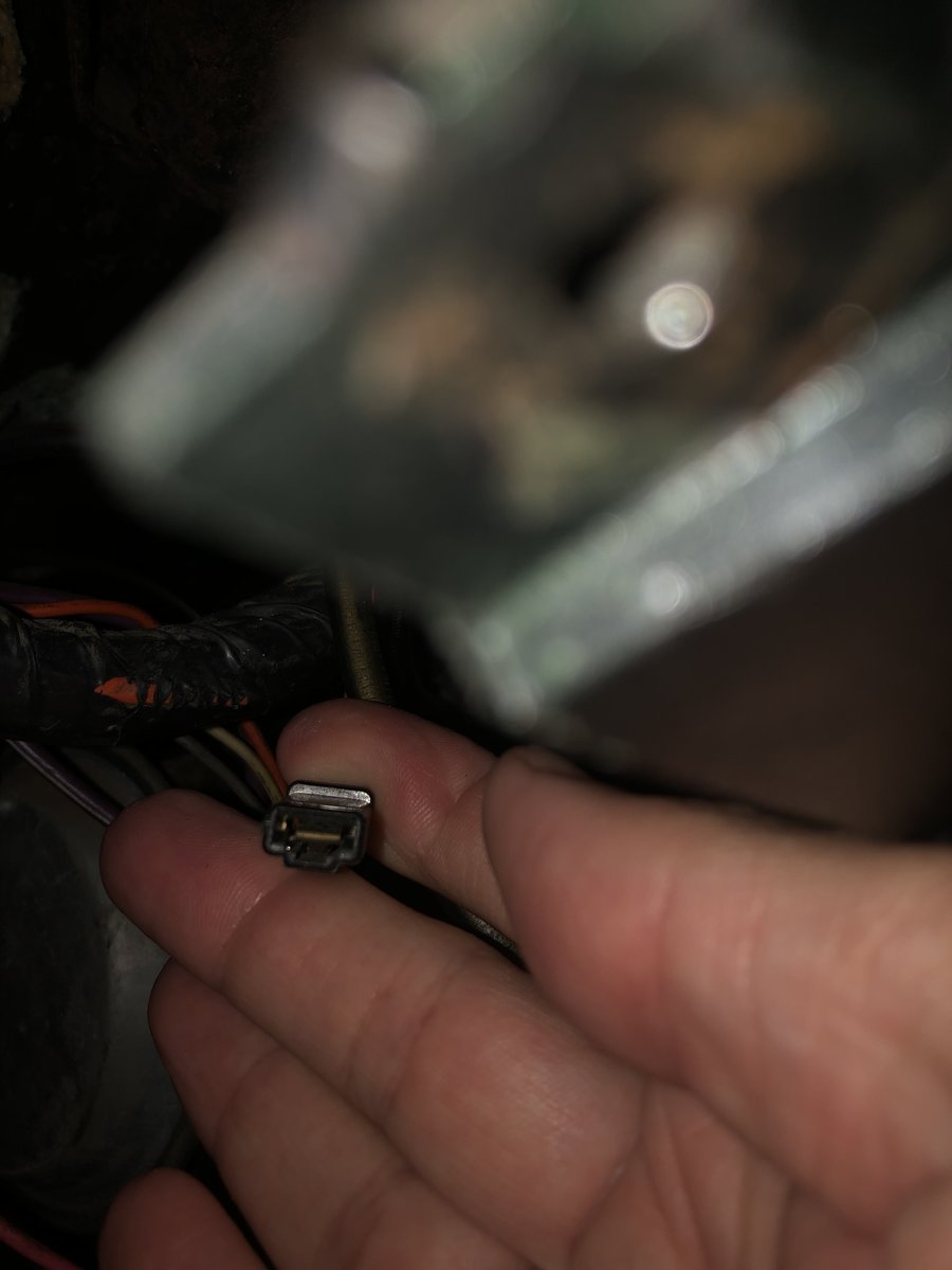

gdubya Posted April 16, 2020 Author Share Posted April 16, 2020 Red, I cannot thank you enough. Here are some pics of the connector. Not easy to get a good pic of location. It comes off the harness and drops down below the radio. looking at the wiring diagram I feel like it is supposed to feed the courtesy lamps but not really sure. Any ideas on what it would plug into it? Quote Link to comment Share on other sites More sharing options...
cbolt Posted April 17, 2020 Share Posted April 17, 2020 Based on the location I would guess it feeds the console in console cars. When I added my console I had to tie the console harness into the factory plug, and that little guy looks familiar. Why not use a test light and see when the connector has voltage? Or if you don't have power available you could read it back to the fuse block to put yourself in the ballpark at least. Quote Link to comment Share on other sites More sharing options...
RealRed70 Posted April 17, 2020 Share Posted April 17, 2020 That single orange wire is not for a console. I can see the correct black connector for a console in that picture. It is the connector with the orange, gray and white wire in it. The console connector is just below the single orange wire and to the right. 1 Quote Link to comment Share on other sites More sharing options...
gdubya Posted April 17, 2020 Author Share Posted April 17, 2020 Red you beat me to it. Any idea about the singe orange wire? If you need a better picture let me know. It is not an easy spot to get to. I traced it up into the main wiring harness where it heads back towards to driver's side and then dips back towards the fuse block (I believe). 1 Quote Link to comment Share on other sites More sharing options...
RealRed70 Posted April 17, 2020 Share Posted April 17, 2020 That single orange looks exactly like the orange used for the clock, if one was ordered from GM. Do you already have a wire to your clock if your car has one? Quote Link to comment Share on other sites More sharing options...
