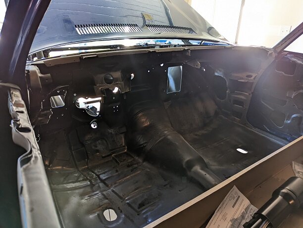

Different subject, anyone know what this bar is? It does not appear factory but is welded just behind the drivers door:
20221116_095322.jpg.8fed26d5af01268837a27199fc72b0ea.jpg20221116_095334.jpg.995d48ba062062fd46faef17c7b31d5e.jpg
Red line is the back of the drivers door, arrow pointing to the front of the car.

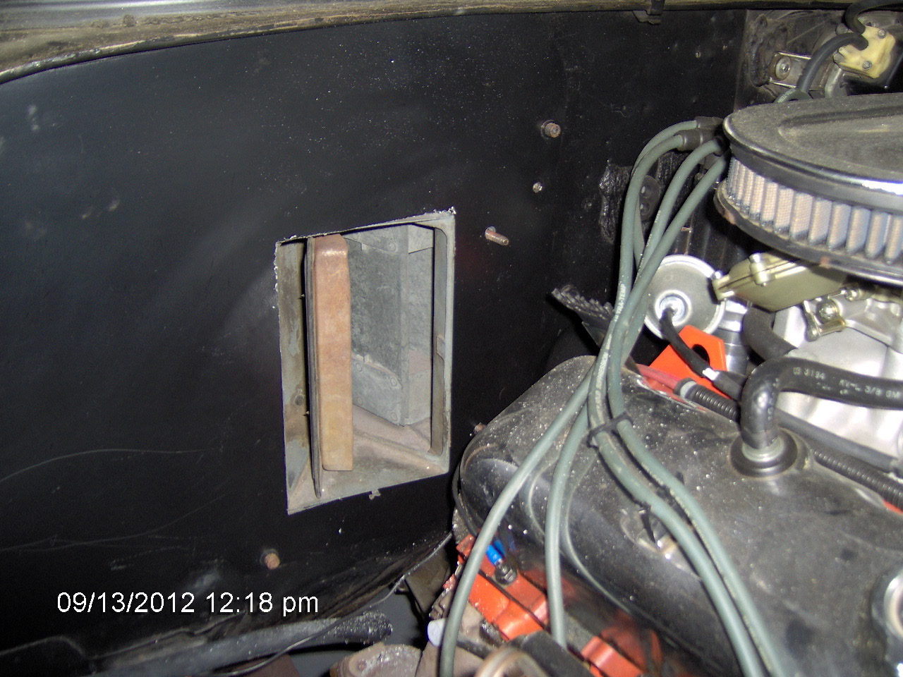

I forget if the car came with AC or not, will have to determine whether it did. I want to say yes, just can't remember right now for certain. I should grab a picture of the garage that it will eventually end up in (hopefully, with a 65 Mustang that is currently in need of everything thanks to the previous owner letting it sit and rot for 20 years).
That is a factory A/C car based on the firewall. People take them out all the time and I cannot figure a move like that out for the life of me. Look around for "take out" parts on www.chevelles.com. Guys over there are often selling complete systems that they have removed ( ???????? ). Again it beats me but to each his own.
Most all parts are still available new and there are places that specialize in A/C parts for these cars. Easy research via the net can get you what you need. Also, the A-Body A/C systems are common to all 70 / 72 A-Body cars Buick / Olds  / Pontiac so don't limit your search to just Chevies. Some of the softer parts like wiring (because of different control locations) may be different but the evaporator housing / evaporator and blower motors are the same.
I ordered my 71 W/O A/C because I ran out of money.

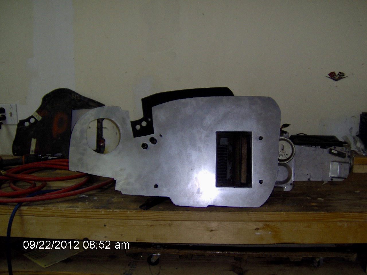

About 20 years later I wanted to add it and got all the parts (Including part of the firewall) to add it but decided I didn't want to do that much work.
Still have all the parts in the basement.
It's not a terrible amount of work if ya go slow and call a "time out" when ya get tired. Once I realized that the non A/C and A/C firewalls had the same positions for the studs that hold the air handler on the passengers side of the firewall and the Evap housing on the engine side as well as the blower motor mounting portion of the evap housing I powered forward with the conversion. Below are a couple of pics that I might have posted to another thread already, maybe you saw them maybe not.
First pic is the firewall with the new A/C air flow transition hole cut and the old non A/C airflow transition hole still open. Second pic is the plate (from the third Pic) in place covering the non A/C transition hole and the A/C air handler in place under the dash.

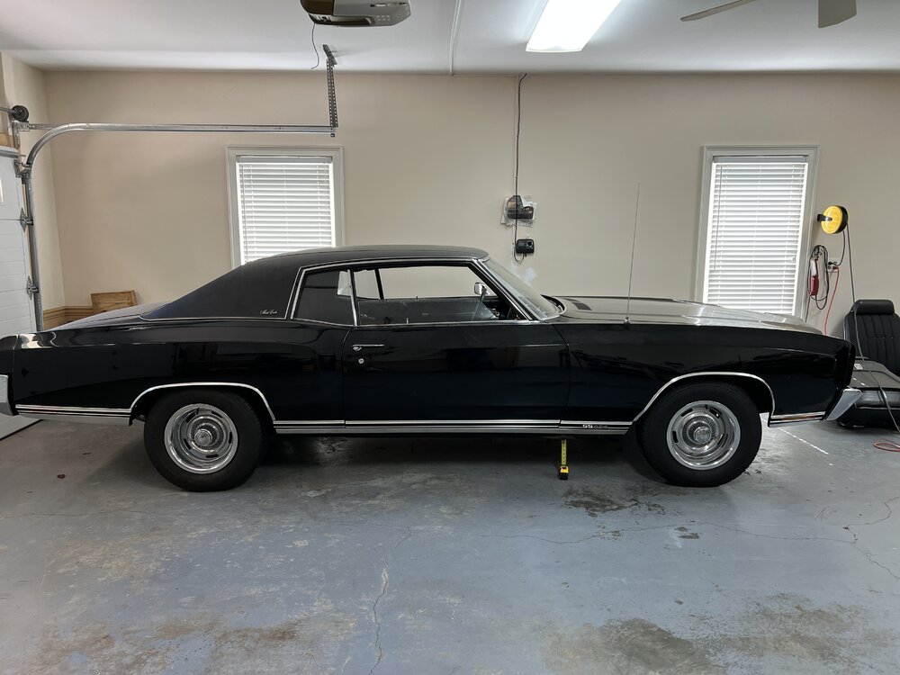

BTW the new  shop / garage is "to kill for". What is your opinion on the ride height of my rattle trap...opinions always welcome.
No worries, to be honest I was looking at mine and thinking it's not low? haha.... thanks, the shop / garage is great, if only COVID had not made it cost way over budget, it would be perfect!!
I like your ride height, but on some of these older cars I think they look better a little taller.  Is it level front to rear? just too high for what you really want?
