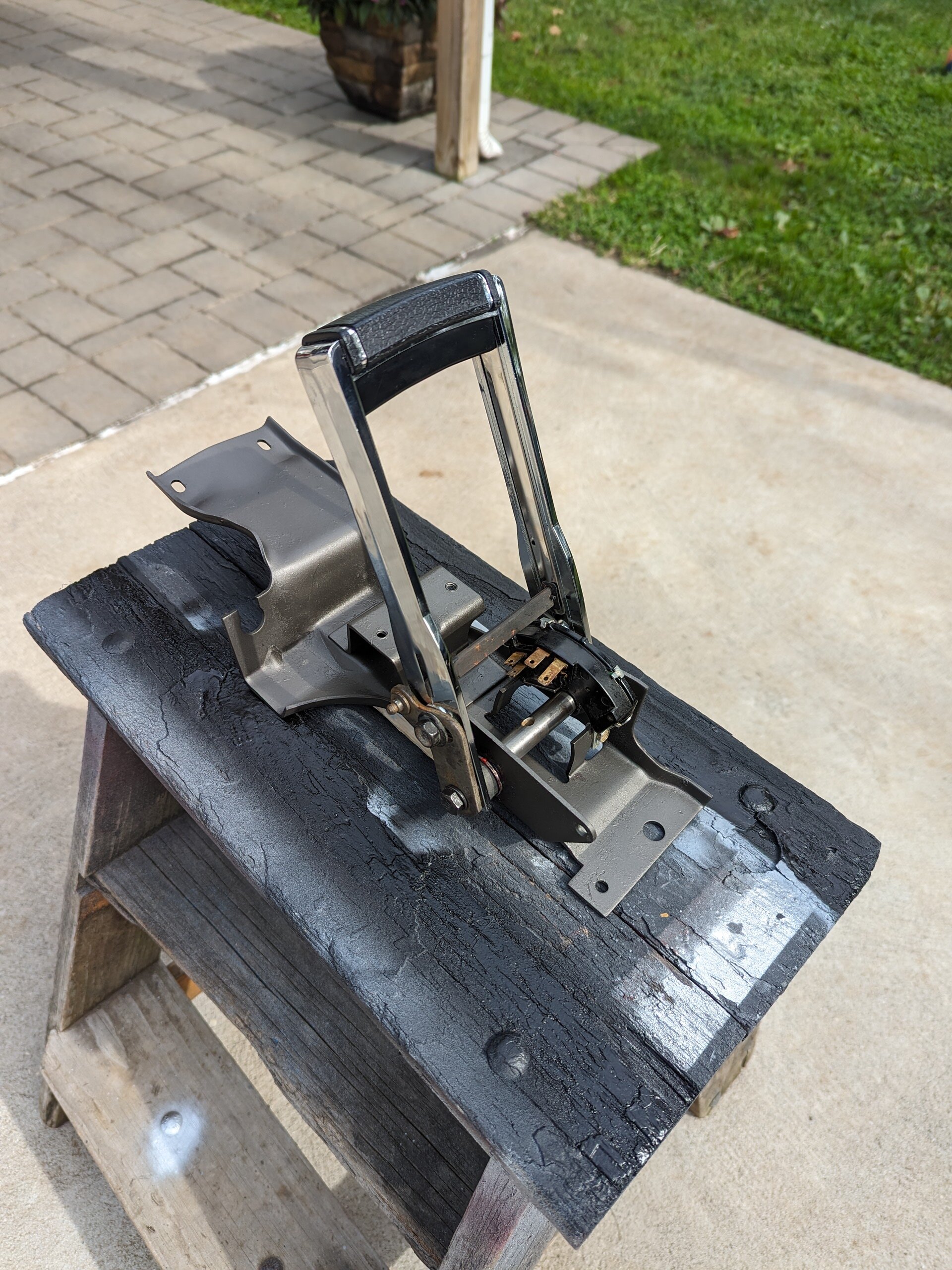

Scott S. Posted November 7, 2023 Share Posted November 7, 2023 No, it's a completely different switch.... I column switch is built into the white box that mounts on the top of the column behind the dash, (it's curved to fit the tube) and connects to the shifter arm with a rod. The console switch is simply a box with a contact that mounts onto the shifter mount and opens the circuit when not in park. Quote Link to comment Share on other sites More sharing options...
MC1of80 Posted November 7, 2023 Share Posted November 7, 2023 Here is the console, shifter mounted neutral safety switch. 1 Quote Link to comment Share on other sites More sharing options...
Paul D Valle Posted November 7, 2023 Share Posted November 7, 2023 I think you are referring to the ignition switch that is white higher up on the column. The neutral safety switch and integral back up light switch is as shown in the picture on a automatic transmission car. Its the same switch which is mounted on the lower column on a column shift automatic car. The neutral safety switch on a manual transmission is white and completely different but is connected to the clutch pedal . Hope this info helps to clarify this topic. Quote Link to comment Share on other sites More sharing options...
