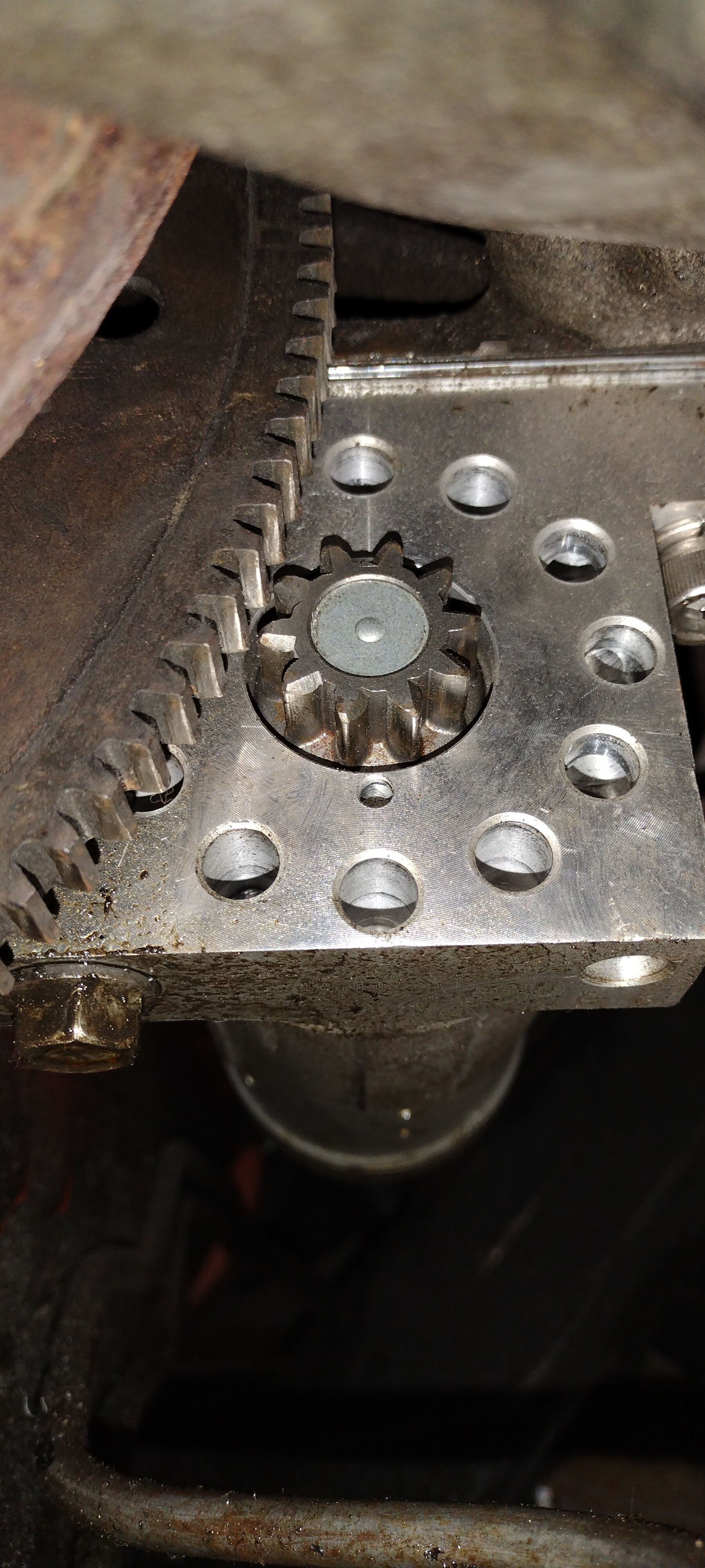

Last year the nose cone on my starter housing cracked, which lead me to replace it and also fix a tremendous amount of wiring (not me, previous guy(s); see below link if you're interested).  I've never gotten past the screeching sound that the new starter and ring gear make, and have always meant to address it earlier rather than later.  But here I am!
I bought the Procomp Electronics High-Torque Mini Starter PCE393.1032 from Summit Racing (link below).  I installed it with no shims, 2 thin shims, and then last night all the shims I've got.  But still I get that same screech.
The only thing I can think of is maybe there is a tooth-count mismatch.  But I dont have a good way to get better clarity on that.  Any thoughts?
Any other thoughts on what I might try, or whether this is just the wrong starter for the job?

I cant imagine that the starter / ring-gear engagement, or the starter itself, is supposed to sound like that.  It's that high-pitched, metal scraping sound that to me indicates a need for more or less shims.  I guess I will keep playing around with it.  And will keep ear plugs in each time I start it, ugh!!!
You can't just throw shims at it randomly like you're doing. You need to measure the clearance and go from there. You need to have proper knurled starter mounting bolts too.

Thanks for those references.  And you're right, I should go ahead and measure and be more quantitative about the shimming process.  I'm not sure if I can recall ever measuring the tooth clearance on any of my cars over the years, and there have been LOTS.  I've always just shimmed until it sounded right - always worked for me in the past.  And I've never done the half-shim thing, but the need to do so sometimes is obvious of course.  And again, you're right
The challenge (and resulting laziness) with measuring is of course the headers.  And also because it's pretty messy under there.  I've yet to degrease and hose it down from the previous owners usage and disasters over the years.  Excuses, excuses ... again, you're right.
I will get under there later tonight or this weekend and take some measurements.  I might even try and take some video with sound and post it here just everyone can learn from my laziness and impatience :)

Well, as suspected there is not really a good way to measure the clearance with this particular starter model. There doesn't seem to be a way to manually pop the pinion gear out and mesh it with the flywheel ring gear.
Any more thoughts here guys, before I start randomly trying the less, half-shim approach?
A few minutes later update - all of the shims have been removed. Still has that 'needs to be shimmed' sound, but maybe not as bad(?). I might just run with it for now. Or might start the half-shim thing tomorrow. We shall see
I had a few of those style starters (Power Master & NAPA). It's not easy, but entirely possible to pop that gear out, hold it in place, and measure the gap.
There is a simpler way that I used, but not for everyone I imagine....
At any rate, I ended up sending them all back. First, I couldn't get them to 'clock' properly for header clearance, and second, I forget the exact amount, but had to remove something like .030 from the mounting surface on one of them for it to fit properly. Sent it back as defective, the replacement was just as bad.
A big waste of time on that style starter, at least in my case.

@jft69zand @Scott S.,yeah I'm sort of leaning towards "is what it is" for this ProComp "mini, high torque" starter. I will have to look back but I had put a similar style starter (not sure the brand / model) on my '68 Lincoln Continental with a 462ci engine. I had 'heat soak' issues and the higher torque helped solve that. But I don't recall it having the "shim me, please" sound.
Anyway, I just put my MC down on all 4 for the first time all winter. Runs great! And the starter is what it is.
I will report back if I ever get a final solution here. But I will just ignore it for now
