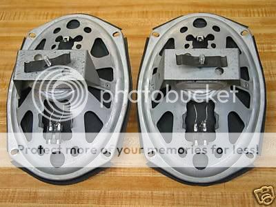

As Aaron stated, you will need a stereo dash, 2 front 4x6 speakers (1 driver side with offset magnet), 2 speaker brackets compatible with dash mounting points and 2 6x9 speakers (10 OHM) for rear package tray. Will need 2 speaker grill covers for rear and 2 baffles for rear to project sound up thru package tray instead of into trunk. The 2 rear speakers should be equipped with a mounting bracket that allows you to secure the baffles on the underside of the rear speakers.
Here some pic's to identify components.

REAR SPEAKERS

Hope this helps. Found most of what I needed on eBAY and had speakers reconned. The 6x9's & Grills are hardest to come by. You might use the For Sale forum here to locate them. I think there is a set of dash mounting brackets on eBAY that ends today.
