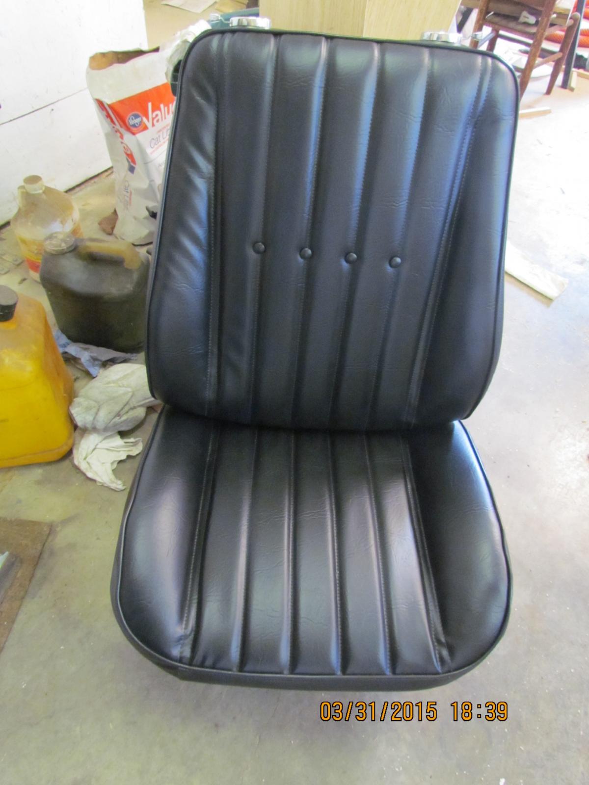

My upholstery guy had some trouble with the seat bottoms. There was a lot of puckering on the left side of the seat and I took it back and he redid that part. He had to stuff a little more foam along that edge and pulled the material a little it is now acceptable. On the back of the bucket seats he put the metal that hold the headrest latch under the vinyl and that gave him a few problems trying to stretch the material but with the headrest in place no one sees it.
