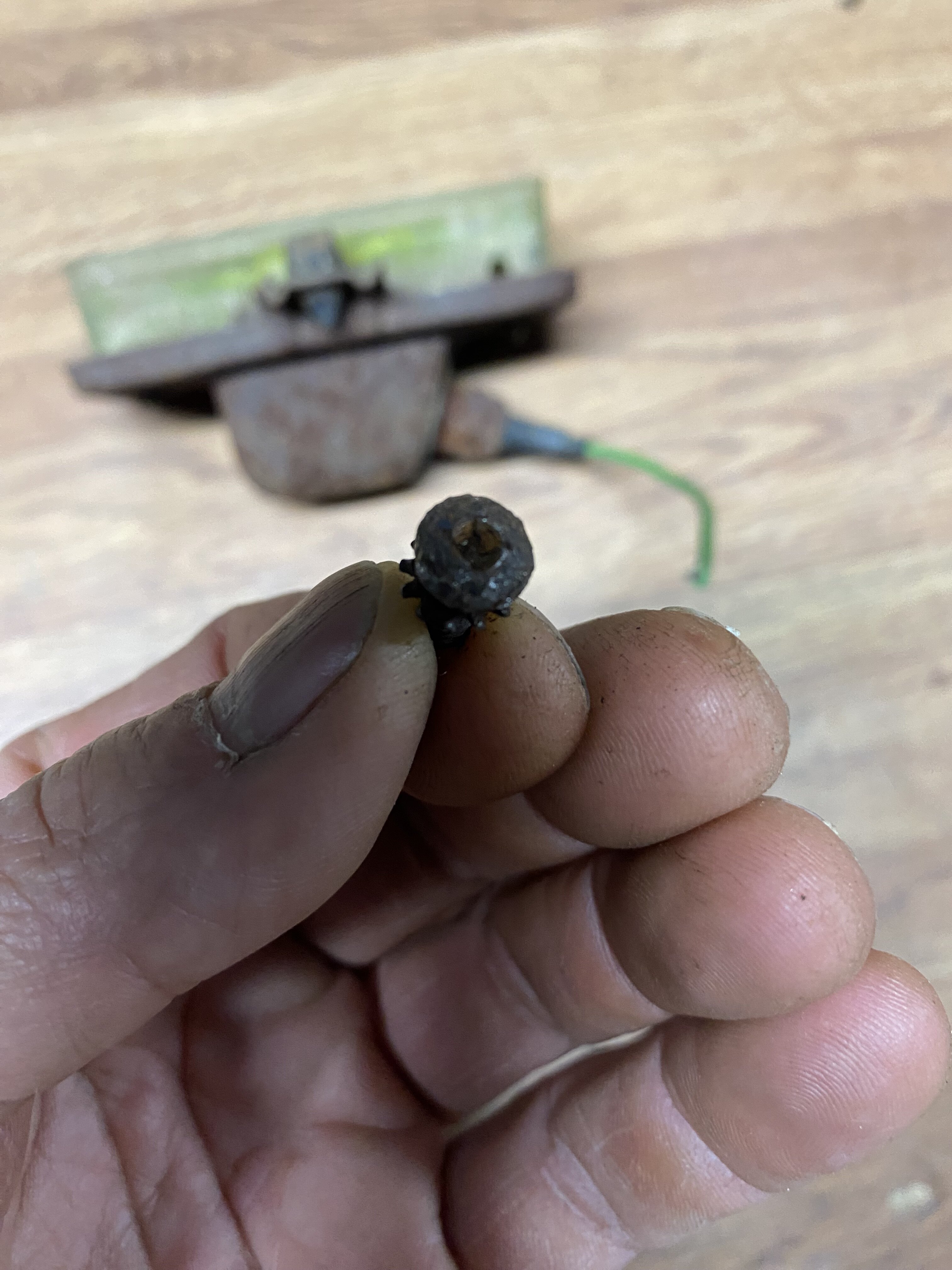

Crom Cruach Posted November 26, 2023 Share Posted November 26, 2023 Would any one know the thread and pitch of the two screws that hold the reversing light housing to the rear bumper? Or better still have a spare you would post to me? I sheared one off when I removed the bumper Quote Link to comment Share on other sites More sharing options...

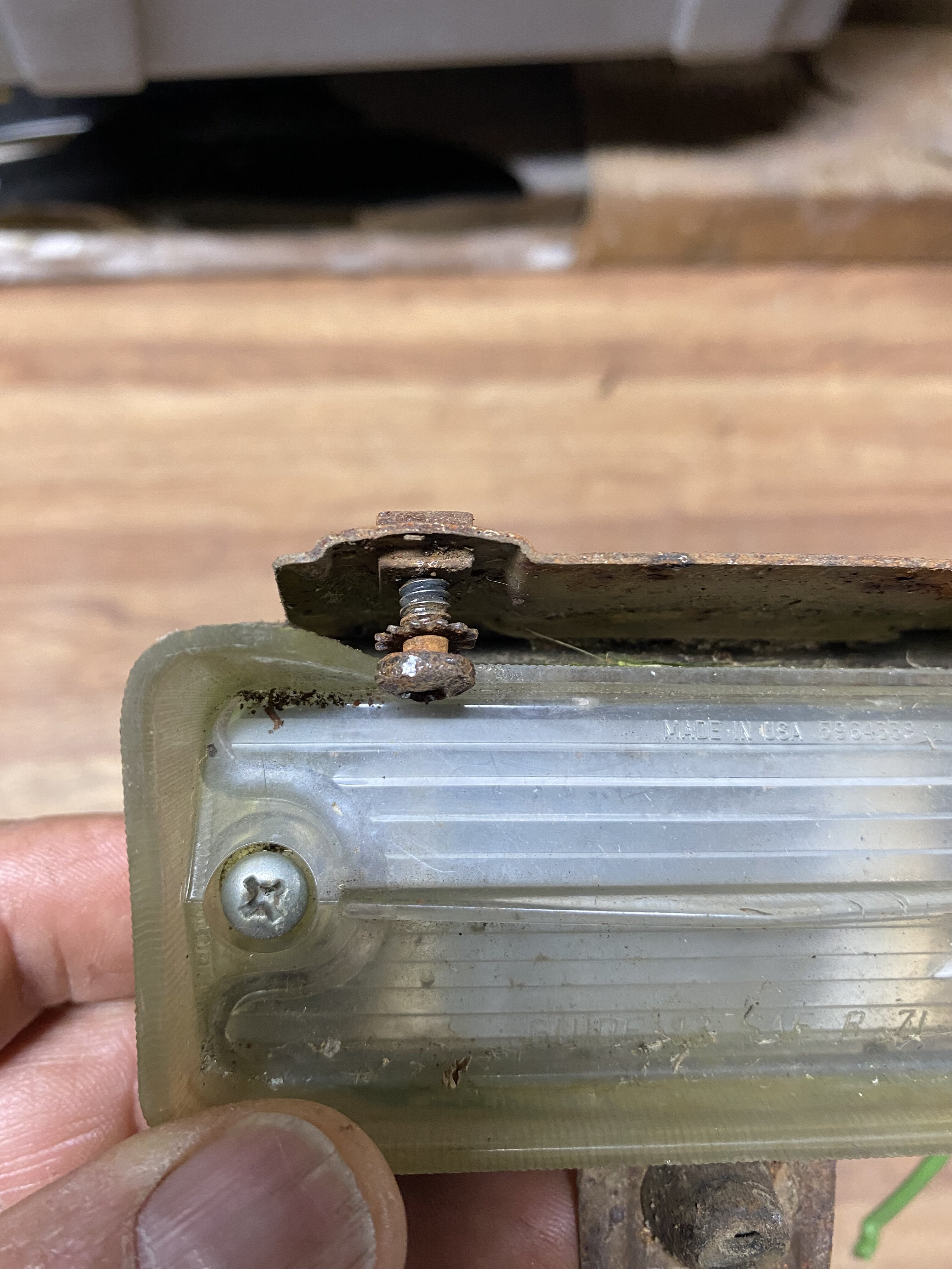

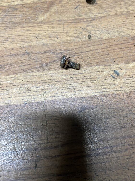

Dtret Posted November 26, 2023 Share Posted November 26, 2023 10x24 Phillips head, star washer. 2 1 Quote Link to comment Share on other sites More sharing options...
Dtret Posted November 26, 2023 Share Posted November 26, 2023 10 minutes ago, MC1of80 said: I believe he is looking for the screw that secures the housing to the bumper. Those are the screws for the lens to the housing. Good to know they make those now. I believe they are just a Philips head short screw for the housing to the bumper. I was loading pics when you answered. lol. 2 1 Quote Link to comment Share on other sites More sharing options...
Crom Cruach Posted November 26, 2023 Author Share Posted November 26, 2023 3 hours ago, Dtret said: 10x24 Phillips head, star washe That’s perfect Denis. Thanks for posting the photos I should have taken! In a rush as usual trying to get a bit done then get back to my other job 1 Quote Link to comment Share on other sites More sharing options...
