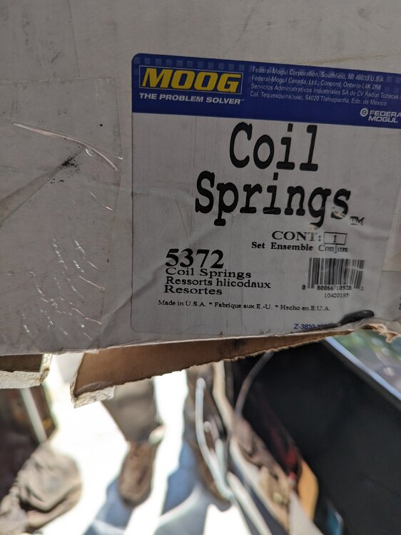

Here is a pic of the springs in "Barn Find" the spring rates should be on the moog website.
