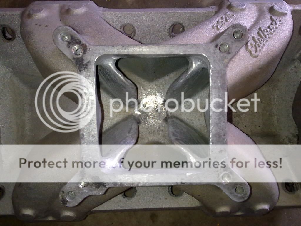

Winston Wolf Posted February 22, 2011 Author Share Posted February 22, 2011 Well, after a few months off, I decided to get working on my intake. I spent the weekend behind the carbides. The runners are now matched to a larger 1206 gasket and blended in nice. I really raised the roofs of the runners where they come into the plenum. Really opened up the intake. I can see why guys like Speier and Dr J charge $1000 for thier ported Super Victors. It is honestly a lot of work. Big improvement over stock. Still have a little clean up to do, then a fresh coat of orange for stealth and get it on the engine. Plan is to go back on the dyno as soon as the snow melts to see how it affected my power curve with no other changes. I'm putting the Air-Gap vs Super Victor debate to bed. Here it is so far. Â Â Â Quote Link to comment Share on other sites More sharing options...

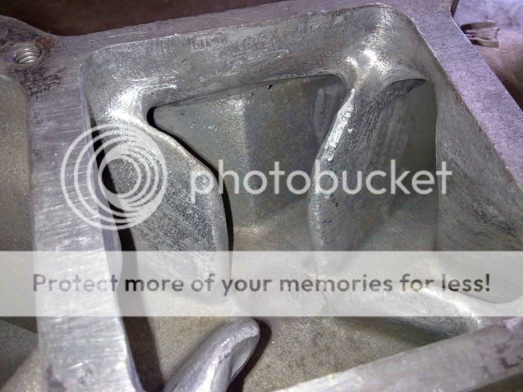

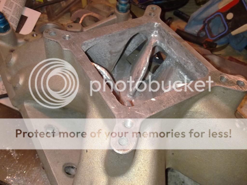

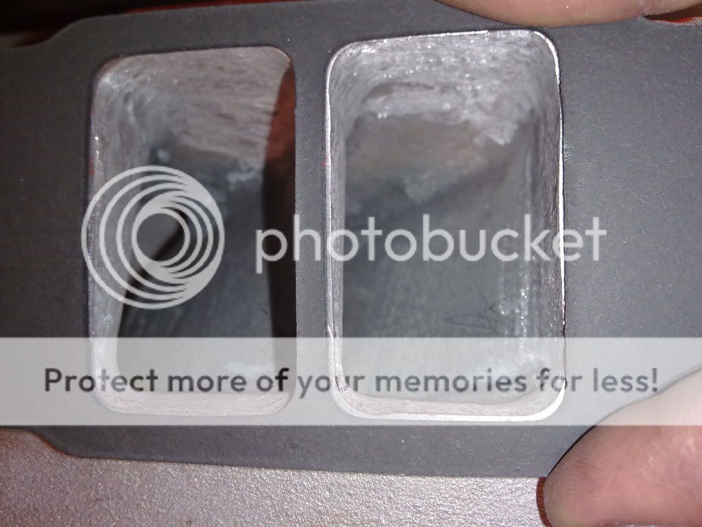

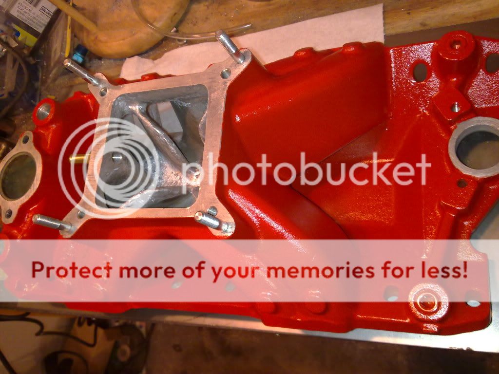

Winston Wolf Posted March 4, 2011 Author Share Posted March 4, 2011 Finished up the intake. Turned out ok I hope. I wanted it painted to attract less attention. Â Below you can see the plenum work and how the runners turned out. I did add a port at the front for the PCV valve. Â Â Â Â Â Quote Link to comment Share on other sites More sharing options...
