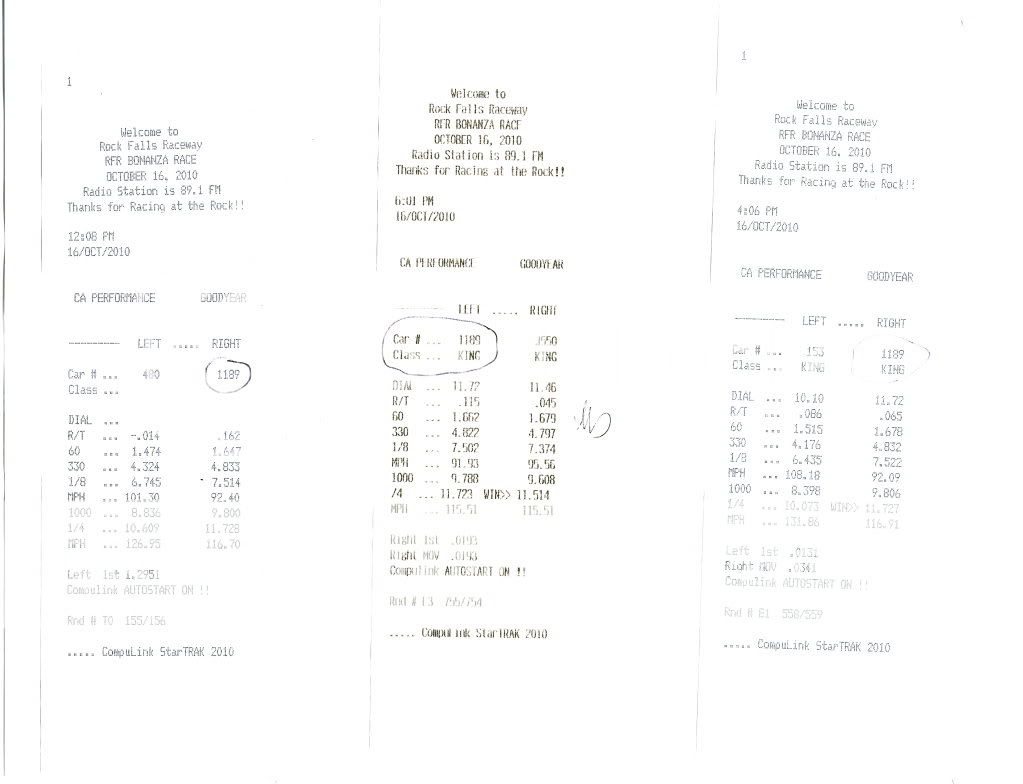

Winston Wolf Posted October 18, 2010 Author Share Posted October 18, 2010 Well, Got the car all put back together for one last trip to the dragstrip. I was hoping to do some tuning, but the day was a bit hectic and I didn't get a chance to do much. I fell 2 tenths short of my 11.50 goal for the year. Car is running consistant 11.72's right now. I didn't have a chance to do any jetting changes or play with carb spacers like I intended, so I was still running on Patrick's best guess jetting. Changed to a 4000 stall, didn't improve the ET any over the 3500. But that along with lowering the rear, removing the front sway and using drag shocks in the front; got it more consistant out of the shoot. 60' times are down in the 1.65 range now, a big improvement from the 1.8's at the start of the season. The shift light helped me to get the gear changes consistant at 6500 now. I used the data logger to fine tune each gear change on the light (allows 4 different shift points) and it's perfect. The car had run a tiny bit faster with higher MPH a month earlier, so I'm thinking the jetting needed some work. Guess it will have to wait until spring now. The weekends efforts would have been better rewarded with an 11.50 slip, but it was at least enough to get a plastic trophy. Here are some slips from the day and a video of the launches. Until next time.... Quote Link to comment Share on other sites More sharing options...

CrazyDavey Posted October 18, 2010 Share Posted October 18, 2010 Justin I think you've done a great job and should be proud of the numbers you're getting. 11.50 is just some tweaks away, just fine tuning the new combo to all work together. The car sounds great, it leaves clean and the shifts sound better than ever. When I first went up to a higher converter it didn't show immediate results but over time learning how to use it (playing with launch rpm's) did show improvement. Congrats young man!!! I don't care if the trophy is made out of paper..I'll take it...Dave Quote Link to comment Share on other sites More sharing options...
BowtieThunder Posted October 19, 2010 Share Posted October 19, 2010 Sounds and looks great NIce job Quote Link to comment Share on other sites More sharing options...
TommyP Posted October 19, 2010 Share Posted October 19, 2010 I think that you should be really proud of you times. My brother had a mild looking ,mid 11 second, small block Chevy II.We used to get a kick out of looking at all the race cars that were at the track that were slower than his car. There are a lot of guyes out there that would love to run those times with a streetable small block car incuding me. Quote Link to comment Share on other sites More sharing options...
dbreese Posted October 19, 2010 Share Posted October 19, 2010 Great job Justin! The cars suspension is really working well and the car sounds great going down the track. Congratulations on the win!! Well deserved! David Quote Link to comment Share on other sites More sharing options...
Mike 57 Posted October 19, 2010 Share Posted October 19, 2010 Justin, the car sounds great and looks good going down the track. I went up three numbers on jets all corners on my pro systems carb, and I think Dave is about the same Quote Link to comment Share on other sites More sharing options...
Andy's Auto Posted October 19, 2010 Share Posted October 19, 2010 Justin, you are definately running a number now. When I fist built my Malibus first big block it only ran 12.30 which at the time was beyond fast for a street car. nd that was a good compression 427. 11.70s for a street big block is an awesome number let alone a General built small block in a land yacht. Anyone can build a fast 3000 pound Camaro or Nova. And you are an excellent plumber, Those trans mods are awesome. Amazing what you can go with without 600 lbs of torque at idle. Love the trophy. Haven't seen one of those in ten years. But I was always deep in the street game. I'll bet you my 496 Monte aiint as fast as yours...... on engine. Quote Link to comment Share on other sites More sharing options...
