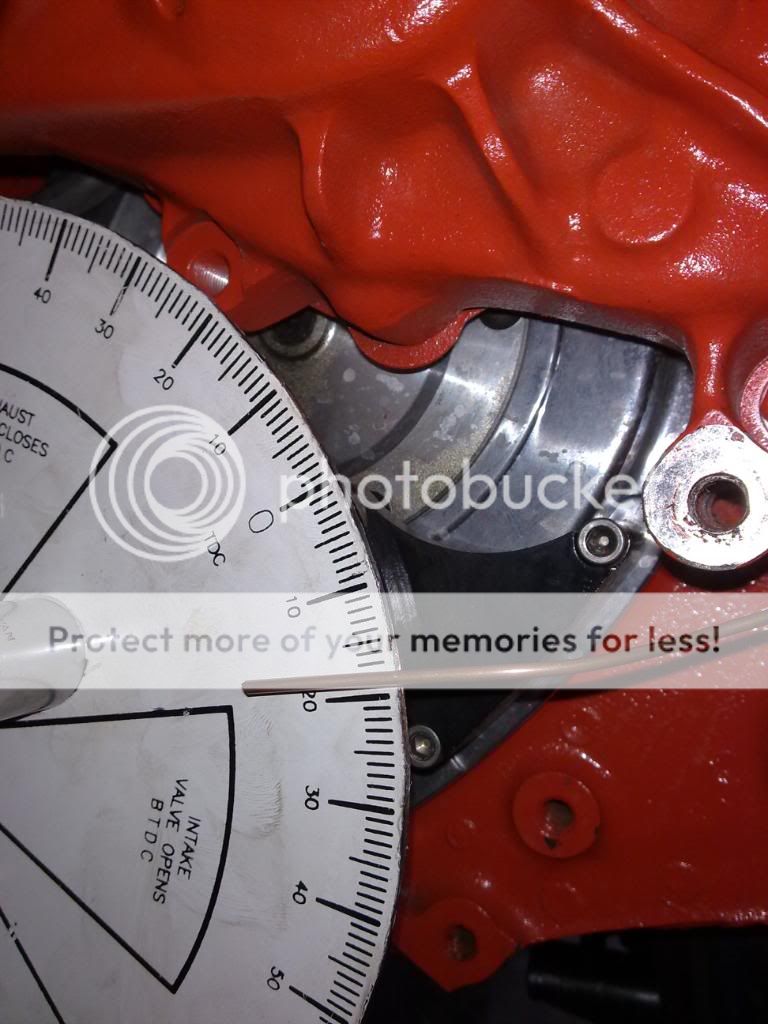

Well, ripped the engine apart again last night. Here is where the cam was:
As I remembered, I had to retard it a few degrees to get it installed correctly. It was dead on with the cam card.
I pulled the cam anyways, to look it over, all looks good.
re-degreed it and triple checked everything. Put the 1.6 rockers on the intakes tonight and set all the valves. I did have to slightly clearance 3 of them as they were hitting the valve keepers, which surprised me a bit.

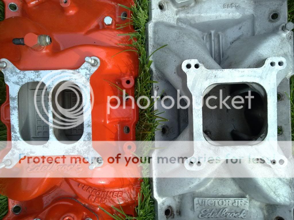

Now trying to make a decision on which intake to start with. I have the RPM, Air Gap, and Victor sitting in the garage. Porting is a bit of work, so I'd like to get it right the first time if possible. I set the Air Gap on the engine, and it does look like a nice piece, I'm really leaning toward it at this point. I grabbed the Victor for 75 bucks, so I don't really care if I use it or not.

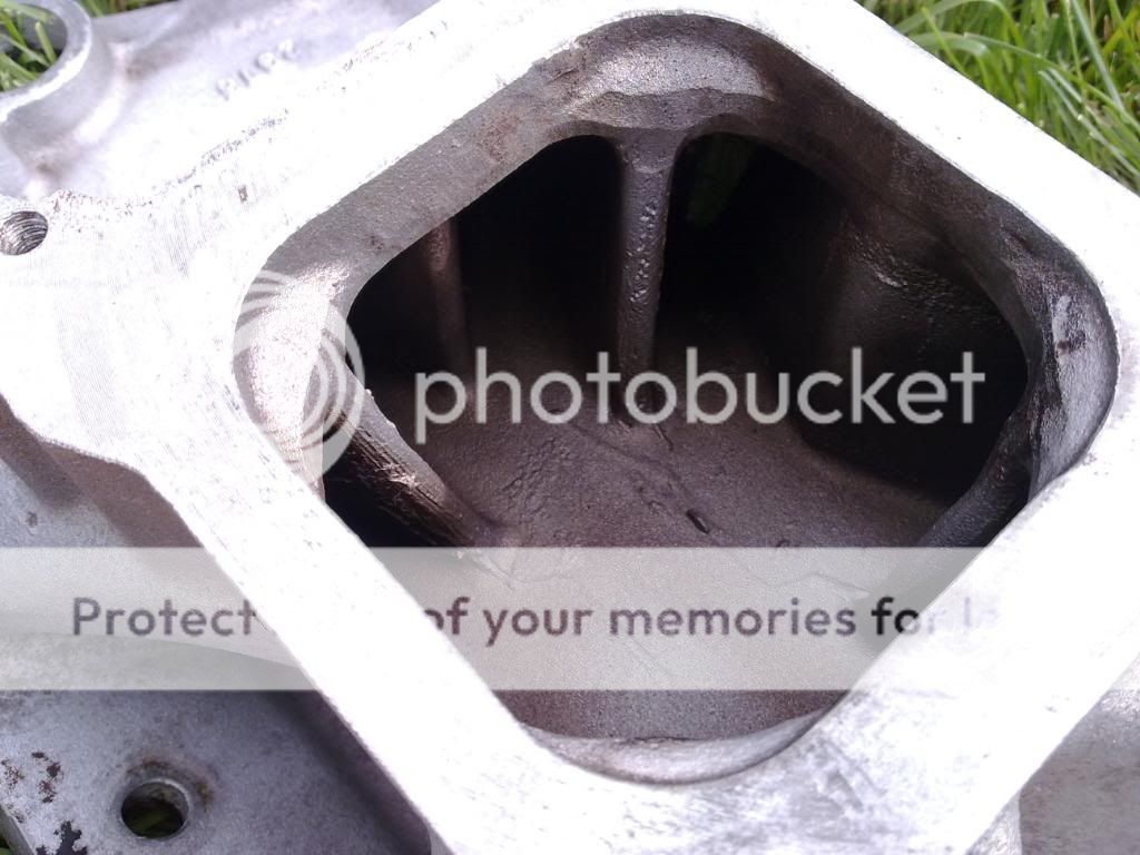

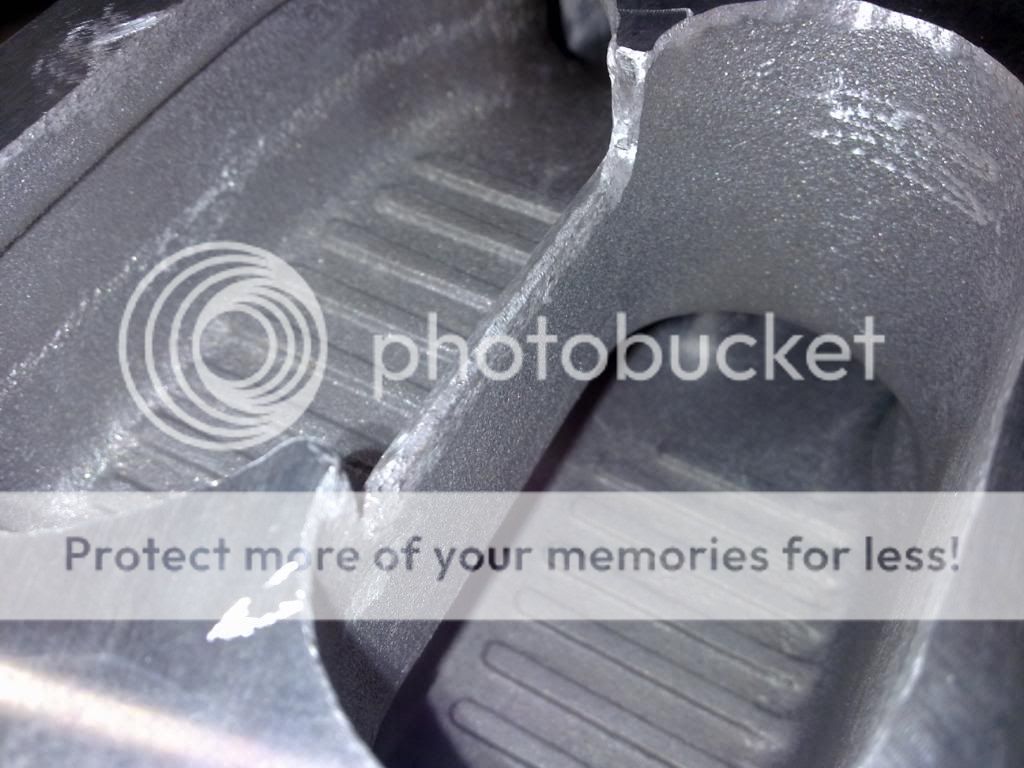

Here is a shot of the RPM that cam off and the Victor JR. The Victor needs some cleaning up, the casting has some crap in it. Notice how much smaller the ports are than the 1206 gasket that the AFR's need. I think just a port match will really help this thing breath....
Sometimes that stuff is hard to figure out: The heads might have big ports, but does the engine want them that big? I know with the BB chevy the rectangular ports are the big ones, but they are often not the best choice.
As for the port matching, there isn't a lot to be gained in flow numbers, but getting rid of that ledge will reduce the turbulence there. I personaly wouldn't go crazy and try enlarging the entire runner...I'd only do what was needed to get a smooth transition.

it's been proven time and time again that port matching only gains very, very small amounts, unless you are building an "all out" race engine....it's hardly worth the time

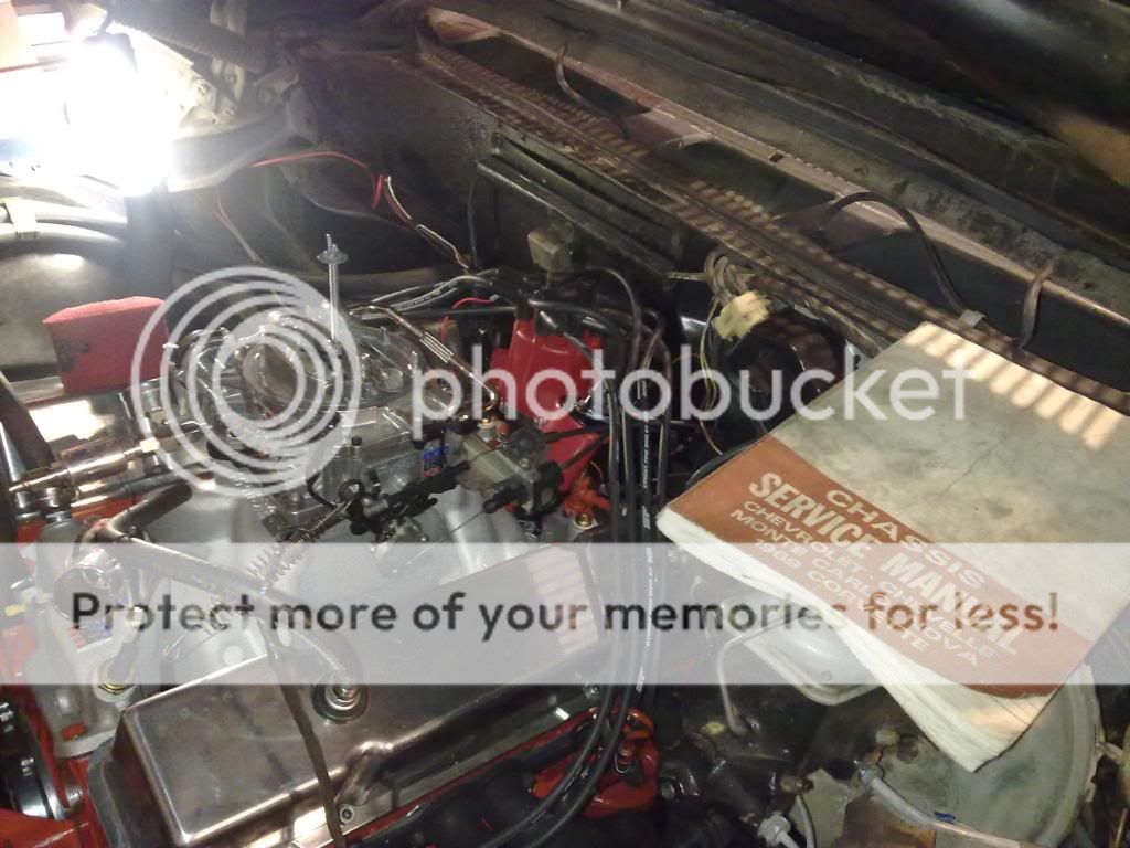

Well, got the engine back together finally. Ran it briefly to get the timing set and make sure everything was correct after installing the new distributor, coil, intake, and fuel pump.

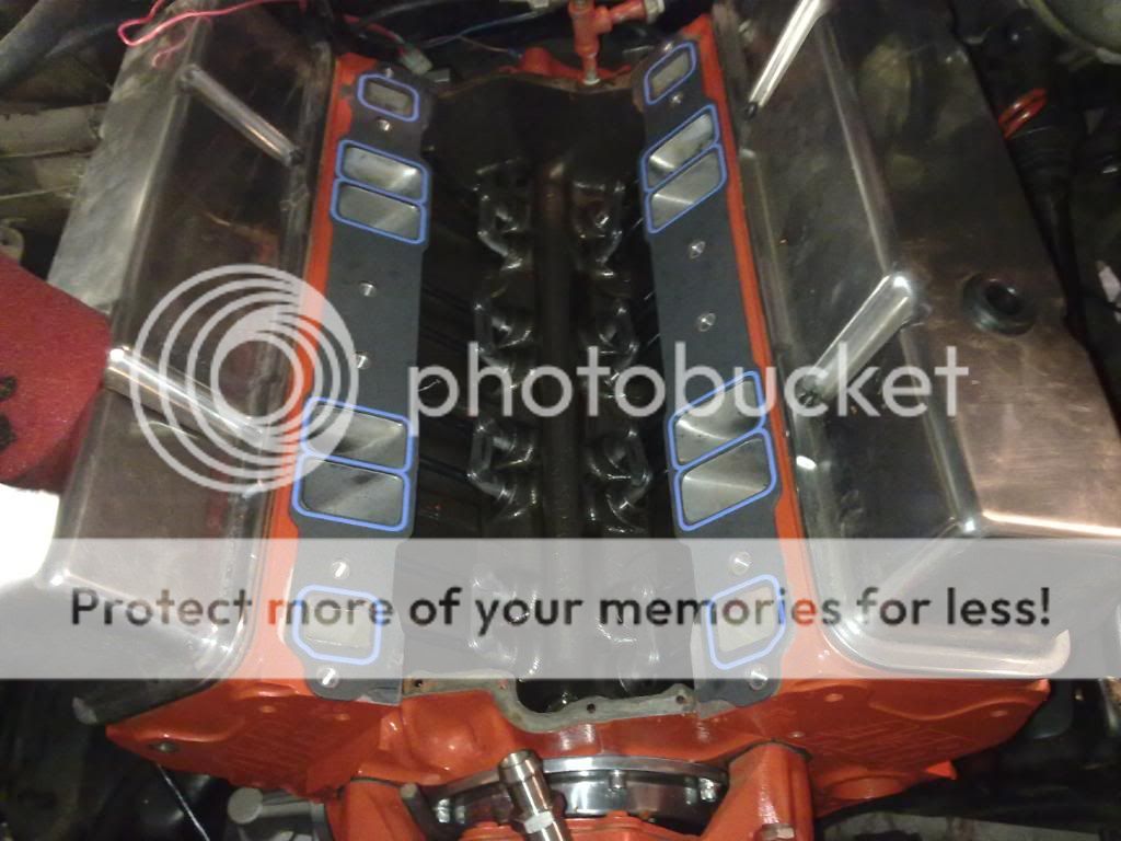

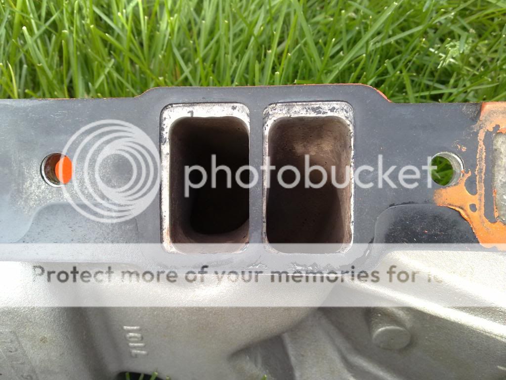

Here you can see some of the work in progress of the intake. The 1206 intake gasket and the AFR heads are much larger than the 1205 stuff from the old combo. I decided to go with the RPM Air Gap intake. The intake work took probably 3-4 hours. I basically port matched it and worked the runners in as far as I could (maybe 2 inches with the die grinder and rotary tool. Smoothed out the transitions. There was actually alot of work there. I didn't do much on the plenum, just smoothed out the divider a bit.

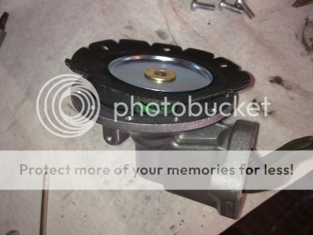

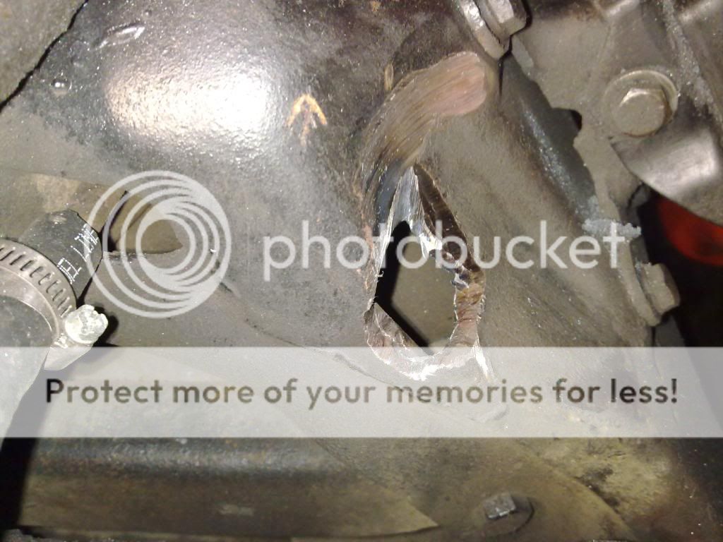

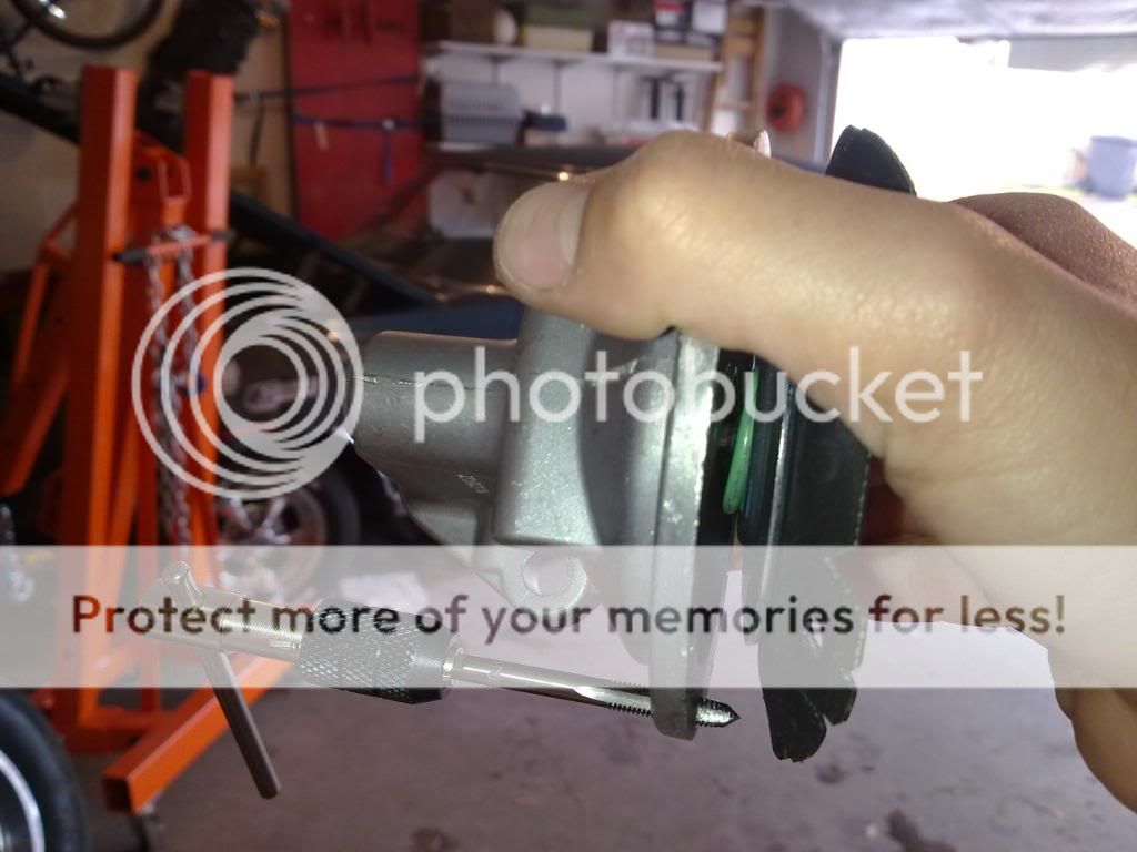

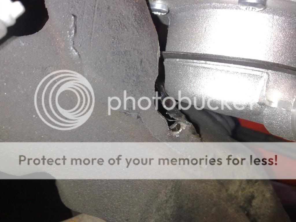

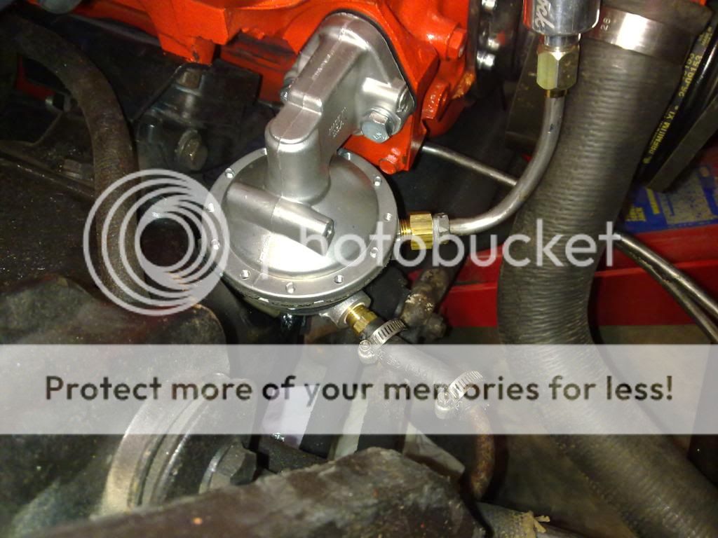

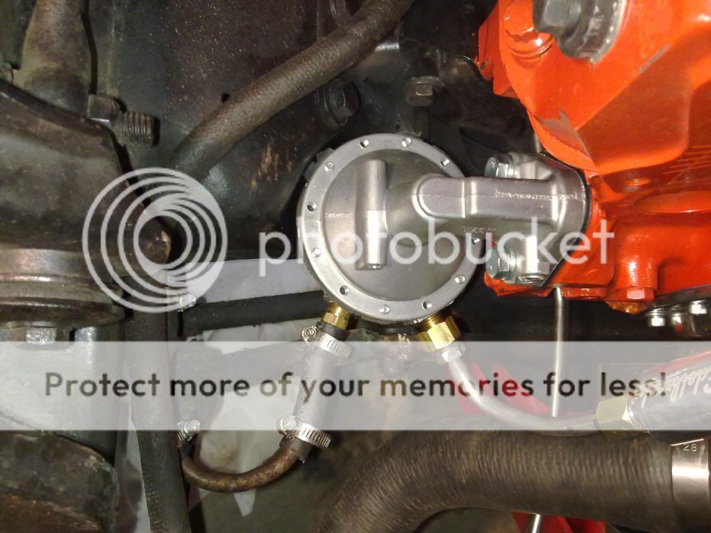

Here is the notching on the frame I had to do to get the Carter pump to fit. I wasn't too crazy about doing it, but oh well....
I actually had to rotate the pump body to a point in between where it was made to be. It had the holes, but they were not tapped. I ran a M5x.8 tap through and got it in the right spot. I'm changing out this tubing for some other line, but I wanted to get things going last night.
New MSD Digital E-Curve distributor. Really slick. Timing curve is very, very smooth on the light. I am excited about it. Right now I have it set up with a 15 deg "mechanical" advance that is all in by 2500 RPMs and I'm going to try and run a vaccum advance this time, with a 10 degree advance all out by 4" of vaccum. There is a port for the vacuum advance on the bottom of the dist. Really looks clean without the canister.
New carb should be here on Friday. I'll get that in right away and am planning on the Muscle Car only drag races this weekend to see if all this work payed off.
