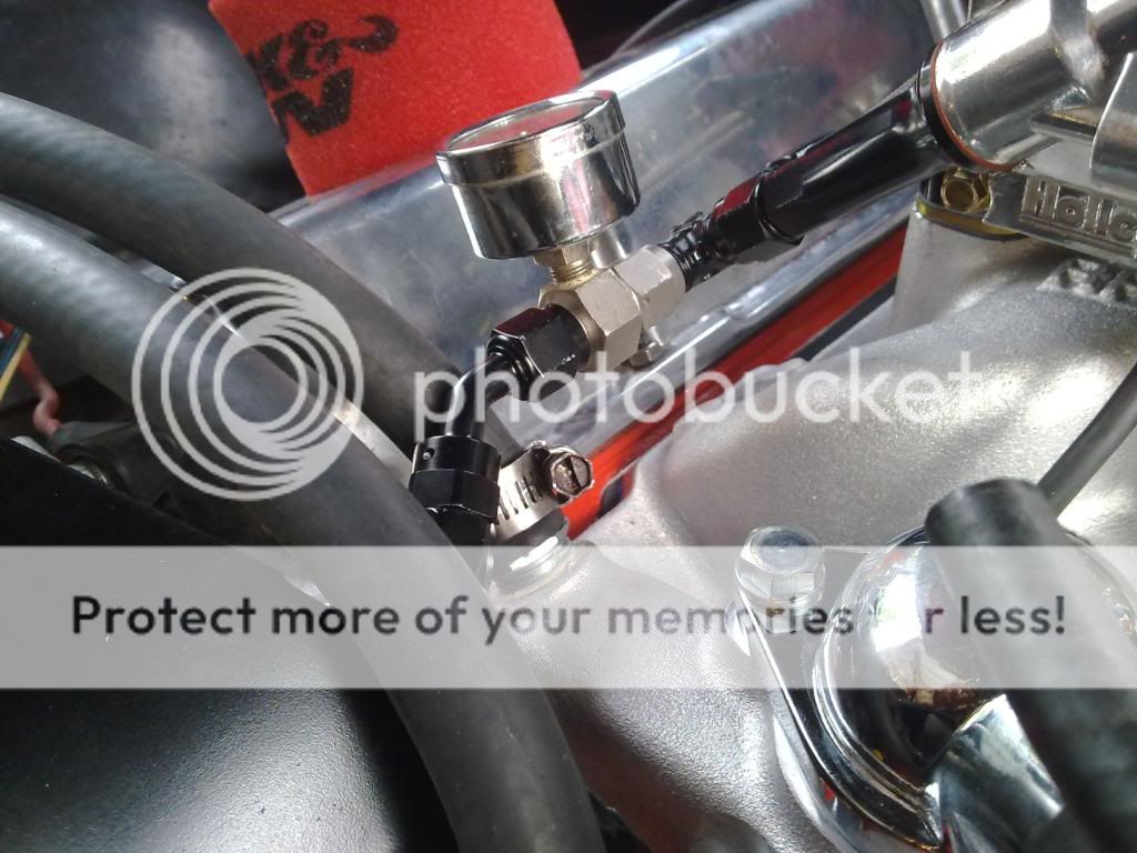

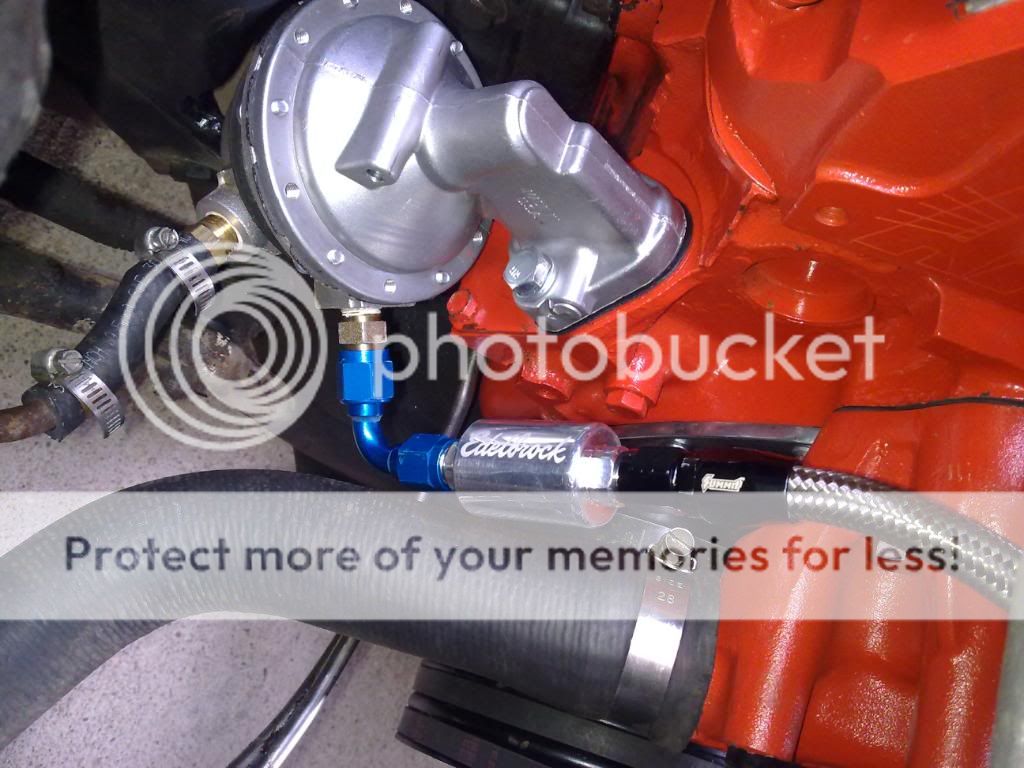

Well, I got the car back together and running. Had it going first with the Edelbrock on it, as I was still waiting on parts for the Prosystems. Took the car out the other day and it was running like crap. I thought maybe since I put the new fuel pump on and was using the Performer carb that the high (8 psi) fuel pressure was causing the stumbling under acceleration.
Got the Holley on tonight and it is doing the same thing. Runs terrible... I thought perhaps it was something to do with the rev limiters on both the distributor and the 6al, so I took the chip out of the box. No difference. Hot set all the valves. No difference, they were pretty close and most were right on. Checked the timing, changed it, nothing. Unhooked the vaccum advance, not it. Looked at my distributor settings, where I wanted them, cap looks new. Tightened the coil connections, nothing. It has never ran like this, so I'm not sure even what to check next.
I do not think it is a carburetor issue.
Listen to this video and you can clearly hear how it isn't right..... This is modern to light acceleration.
Anyways, here are some pics of the new carb....and I would appreciate any ideas on the rough running.

I have a LM2 a/f monitor hooked up in the car. I do not think it is a lean issue, in fact it runs on the rich side per the meter. A vacuum leak is unlikely, the carb only has 2 ports, the large in the back going to my brake booster and the small in the front that was to the vacuum advance, but is now plugged. The intake has one vacuum port that is pluged. All gaskets are new. Again, this seemed to do the same thing with my other (Edelbrock) carb, making me lean towards ignition issues.

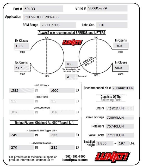

I don't know, but the lack of performance after the last round of upgrades and then further loss with this volley tells me this might be a symptom of the first changes. The cam timing is really bothering me for some reason. I know you degreed the cam, twice and originally you stated that the cam was "off" by 4 degrees out of the box, so you corrected that and then added steeper ratio rockers, which effects valve timings as well. I know its not like unzipping a zipper to modify it, but if it were me, I would go to a straight up cam timing and start there. Too many cam grinders put a very specific advance / retard on their grind so that you can install them dot to dot and get all of the performance that was expected.
That's my bit.
I agree with you Allan
Here is the cam card. It is installed so that the valves open and close at the exact degree the card says on both the intake and exhaust. I would call this "Straight up". The cam is ground with a 4 deg advance into it, but I did not advance it 4 degrees.
When the dots are aligned (and they did not perfectly align, but as close as it could be)and the adjuster was set at 0 deg change on the hex adjust the intake valve at .050 was at 22 degrees. I had to retard the cam gear 3.5 deg to get the intake to open at 18.5, which is what cam card call out. I can change my cam timing without pulling the engine apart with the Cloyes cover, but it is installed per the manufacturer.... Do you not agree? And even if the cam was installed a bit advanced or retarded, it wouldn't create the missing I have.
