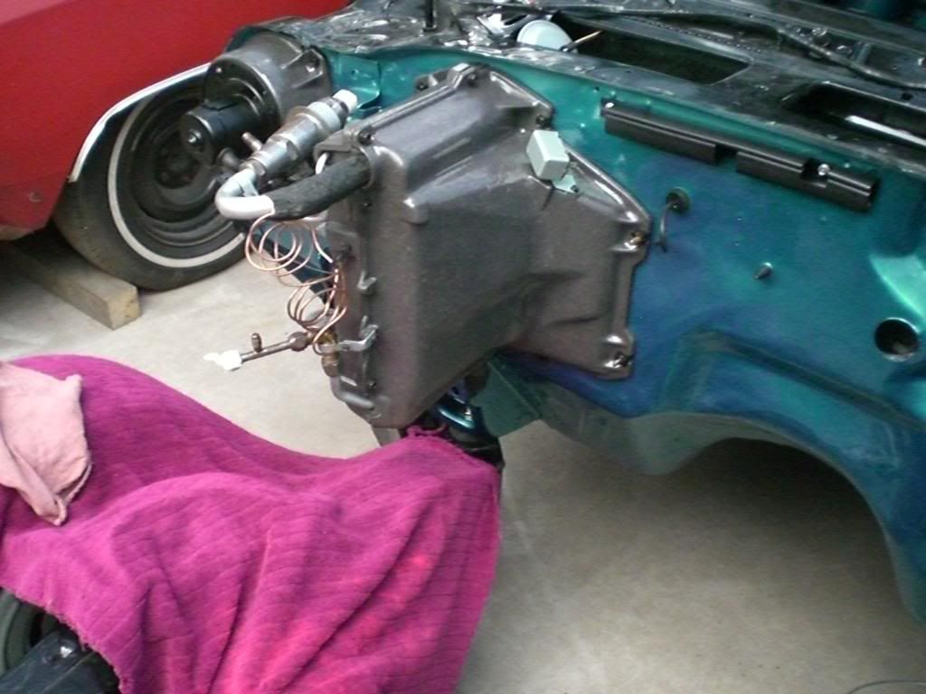

black07ss Posted July 2, 2012 Share Posted July 2, 2012 I am cleaning up things as I am taking them off. Not sure what to do with the evaporator & plenum boxes. What have you done with yours? Clean them up and use a detailer, clear paint or black paint? I'm not sure if a paint will stick to them right. Link to comment Share on other sites More sharing options...

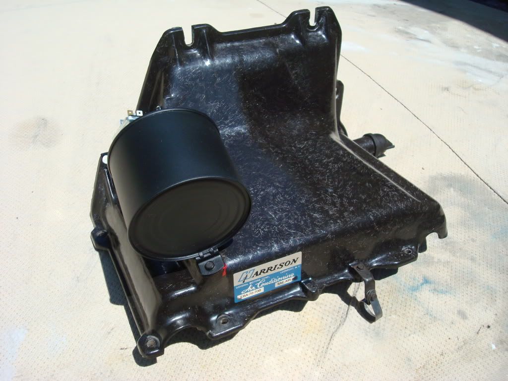

70mcarlo Posted July 2, 2012 Share Posted July 2, 2012 After cleaning mine up, I used Mother's plastic polish and a Powerball (actually their headlight restoration kit). It turned out a lot better than I expected. In order to clean off the accumulated grease, sealant, etc., I used either 3M adhesive remover or 100% mineral spirits - neither of which damaged the plastic/fiberglass. Link to comment Share on other sites More sharing options...
Leghome Posted July 2, 2012 Share Posted July 2, 2012 Cleaned it with a precleaner then sanded my box with 320 sandpaper, cleaned it with a precleaner again and then primed it with a lacquer based primer, lightly sanded it with 400 grit paper, cleaned it with a precleaner again and then used SEM trim black to paint so it matches the rest of the paint work under the hood. Link to comment Share on other sites More sharing options...

70mcarlo Posted July 31, 2012 Share Posted July 31, 2012 I wanted to keep the factory-look, so I just cleaned and polished mine. Some use a semi-gloss black to match the rest of the underhood area. As far as marching the factory dark brown, I don't think you could match it with any color, because of the visible fibers that are molded into it. Here are a couple more photos of the factory finish: Link to comment Share on other sites More sharing options...

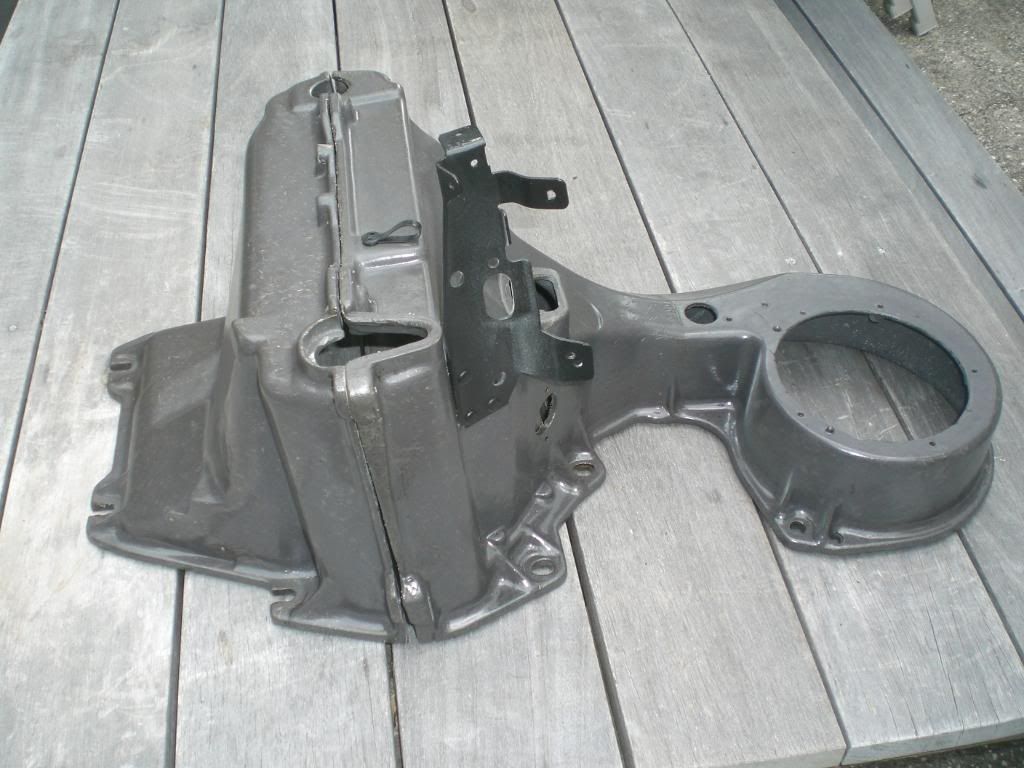

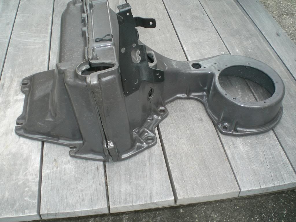

willie Posted August 1, 2012 Share Posted August 1, 2012 I am ticked i couldnt figure out how to get the pics to work last night. I will have to grab my son later. Sanded because i wanted to get some scratches and scuffs out. Link to comment Share on other sites More sharing options...
willie Posted August 1, 2012 Share Posted August 1, 2012 here they are Link to comment Share on other sites More sharing options...

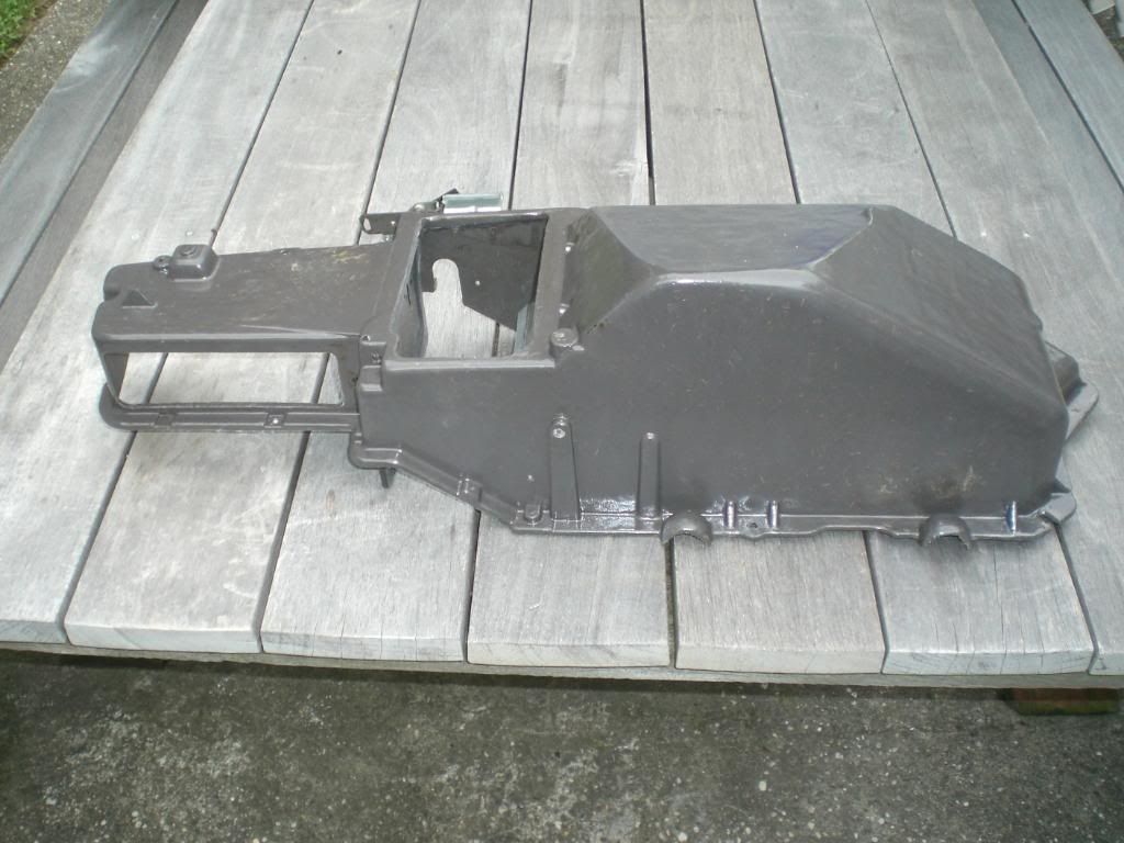

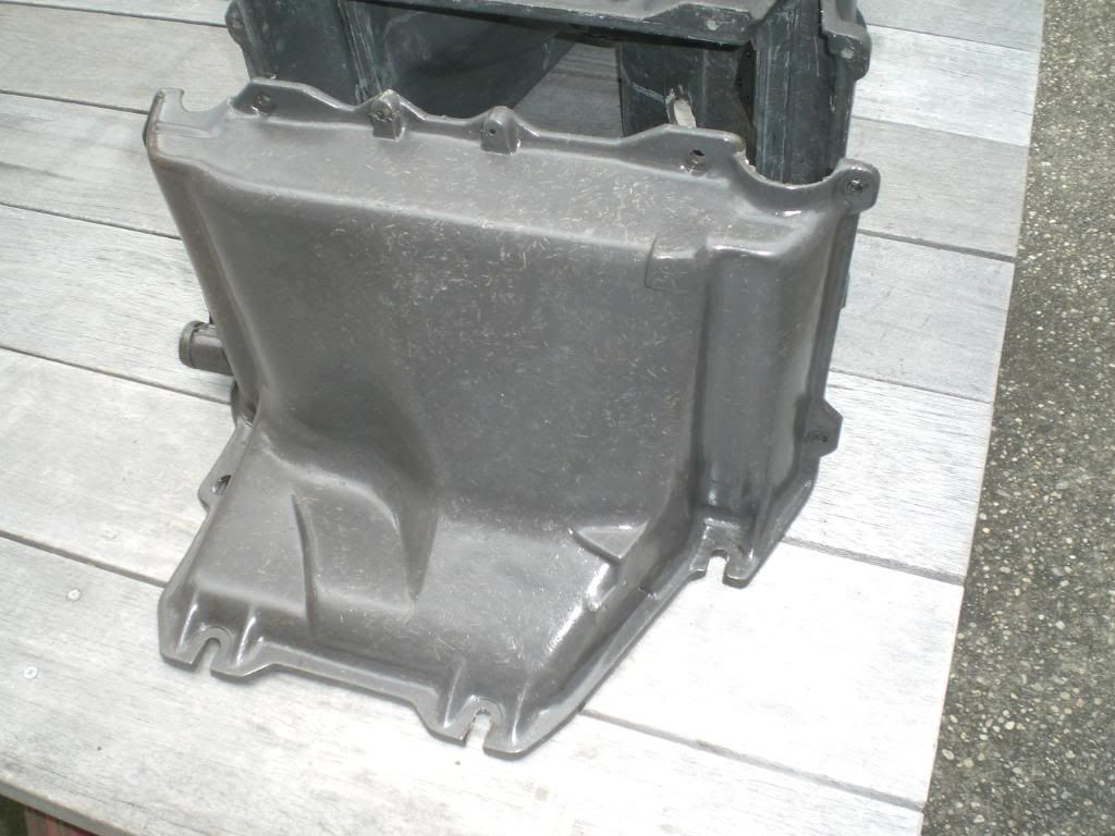

willie Posted August 6, 2012 Share Posted August 6, 2012 I did the evaporator box to match the heater core side. Holy cow i didnt realize there was so much stuff on it. Took me 3 whole days to clean it and sand it to where i wanted it to be. Someone painted it black, that made it hard because i want it to look stock. Then i cleared it to match the other side. Pics later, i am beet. Link to comment Share on other sites More sharing options...
willie Posted August 9, 2012 Share Posted August 9, 2012 Not as good as yours Bob, but here they are Link to comment Share on other sites More sharing options...

willie Posted September 24, 2012 Share Posted September 24, 2012 Thanks Guys, why is mine so much lighter in color than yours Bob? Yours looks so much better, deeper i think? Link to comment Share on other sites More sharing options...
black07ss Posted September 24, 2012 Author Share Posted September 24, 2012 I didn't take a pic of mine yet Link to comment Share on other sites More sharing options...
70mcarlo Posted September 24, 2012 Share Posted September 24, 2012 I think yours looks great, Willie. You've done a really nice job on it (and the rest of your car from what I can see in the photos). I don't know why the differences in color between yours and mine. Different suppliers? Different materials used in certain batches? Perhaps another member knows? Link to comment Share on other sites More sharing options...
