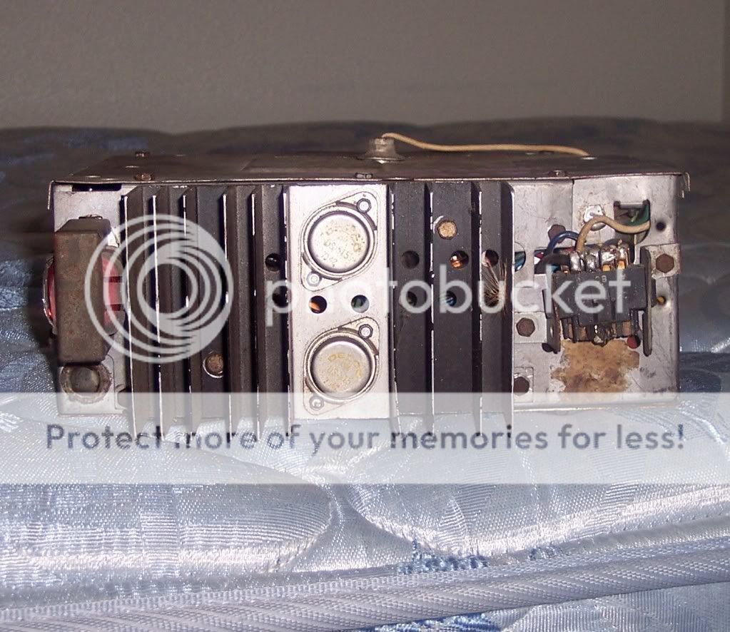

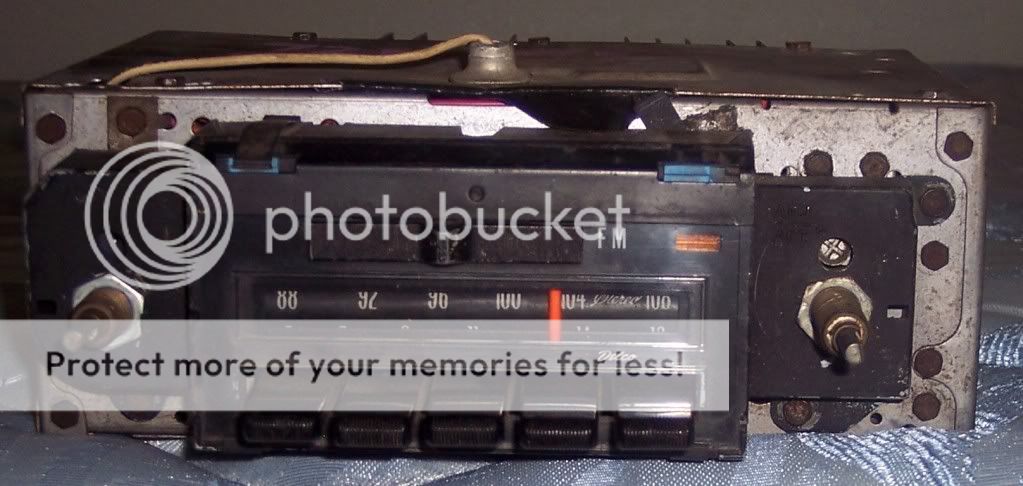

Here are a few pic's for what you are after.
There are several varieties to consider.
AM Radio only - I Front center speaker (w/o A/C)
Easiest and cheapest to find (uses 10 Ohm speaker(s) only)
Not certain of speaker dimension or if speaker bracket is
unique with 1970/71/72 Montes!
AM/FM Mono Radio - 2 Front & 1 Rear Speaker
(Uses 10 Ohm speakers only) front are 4X6 and rear 6X9 oval
Driver side speaker bracket is unique to 1970/71/72 Monte Carlo only for Mono and Stereo!
AM/FM Mono Radio (w/ built in Fader Control) 2 Front & 1 Rear (Uses 10 Ohm speakers only) front are 4X6 and rear 6X9 oval
AM/FM Stereo Radio - 2 Front & 2 Rear Speakers
(Uses 10 Ohm speakers only)front are 4X6 and rear 6X9 oval
(Must use 10 Ohm speakers or damage to the radio will occur)
1971 & 72 has blue light illumination & uses the symbol knobs
1970 has green light illumination & knobs unique to 1970 only
All use the deep chrome controls found behind the knobs often called SS controls.
Mono radios display 1 diode on back while Stereo have 2 diodes displayed on rear. Stereo also identified as such with stereo script on r/h side of tuner
Wiring harnesses are different from AM, AM/FM Mono and AM/FM Stereo radios
Pic's show Stereo version & is correct look for application.
Hope this hepls!

Awww, the mattress isn't all that nice!
