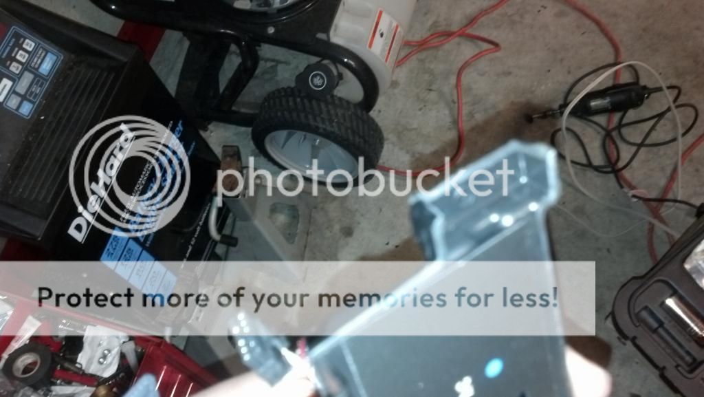

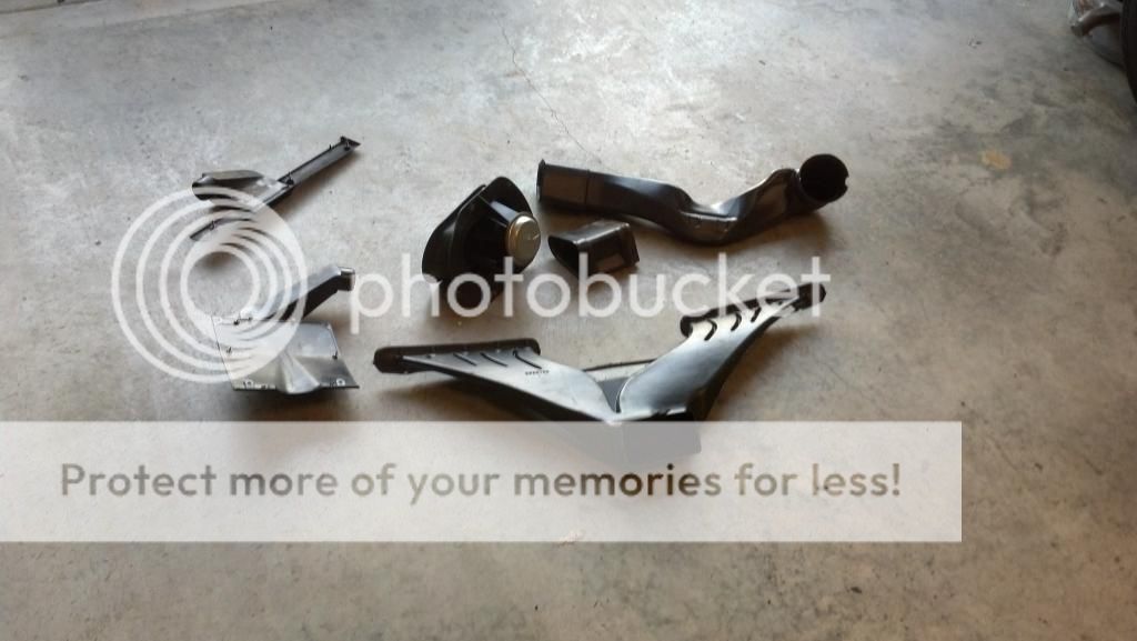

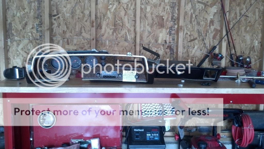

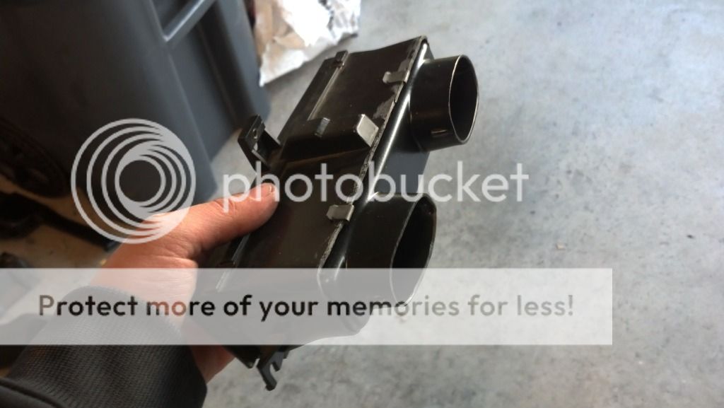

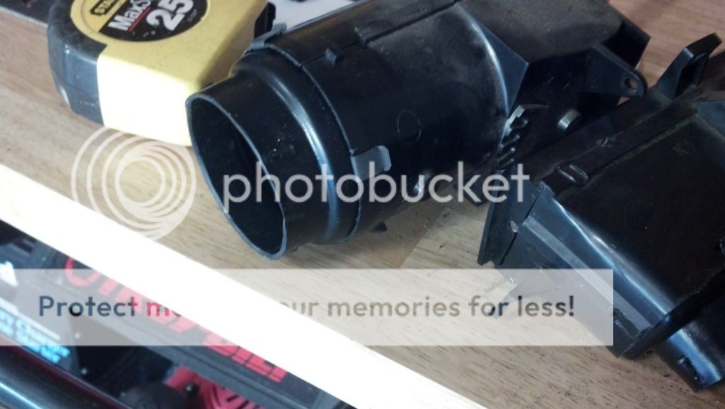

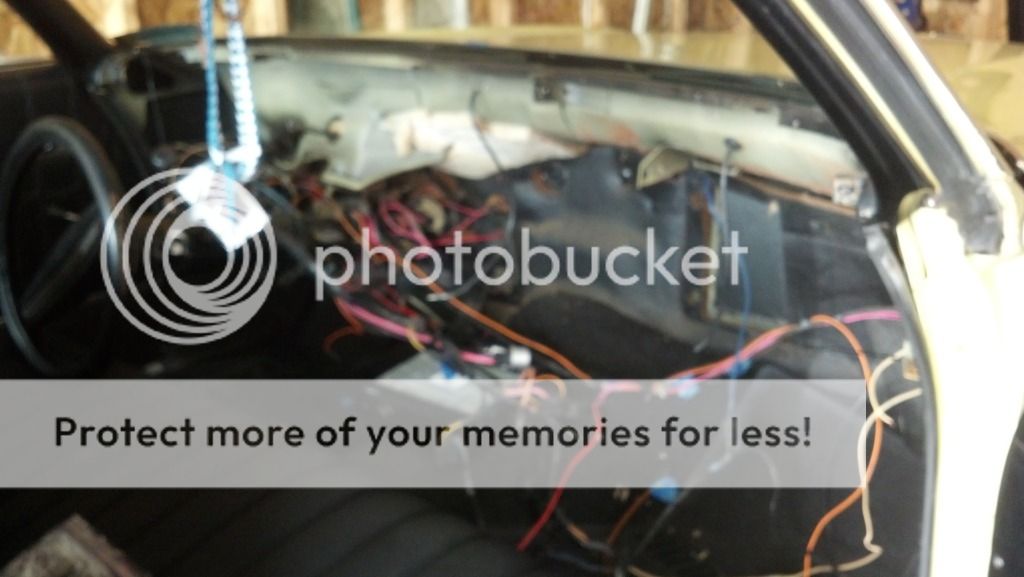

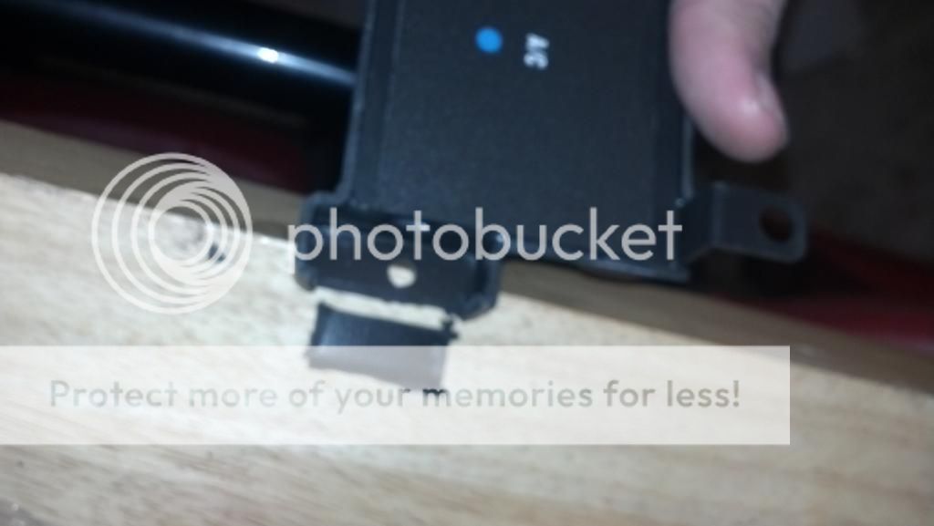

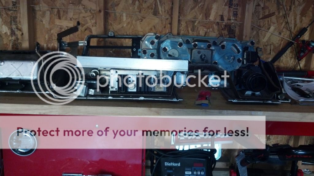

NewTimer Posted March 6, 2014 Share Posted March 6, 2014 Blurry but you guys get the point dash is out! I highly advise using two people before you unbolt the last two bulkhead bolts.   Safely on the workbench   How much you will need to cut off of the glovebox, comes with a new back plate with s clips to hold it on. the clips have tabs that dig into the plastic, that prevents it from coming back off   center vent cut for Vintage Air    Adapters for driver and passenger vents   Parts I won't be needing, may put them up for sale if any interest you can PM me   Fresh Air vents and ducts  Link to comment Share on other sites More sharing options...

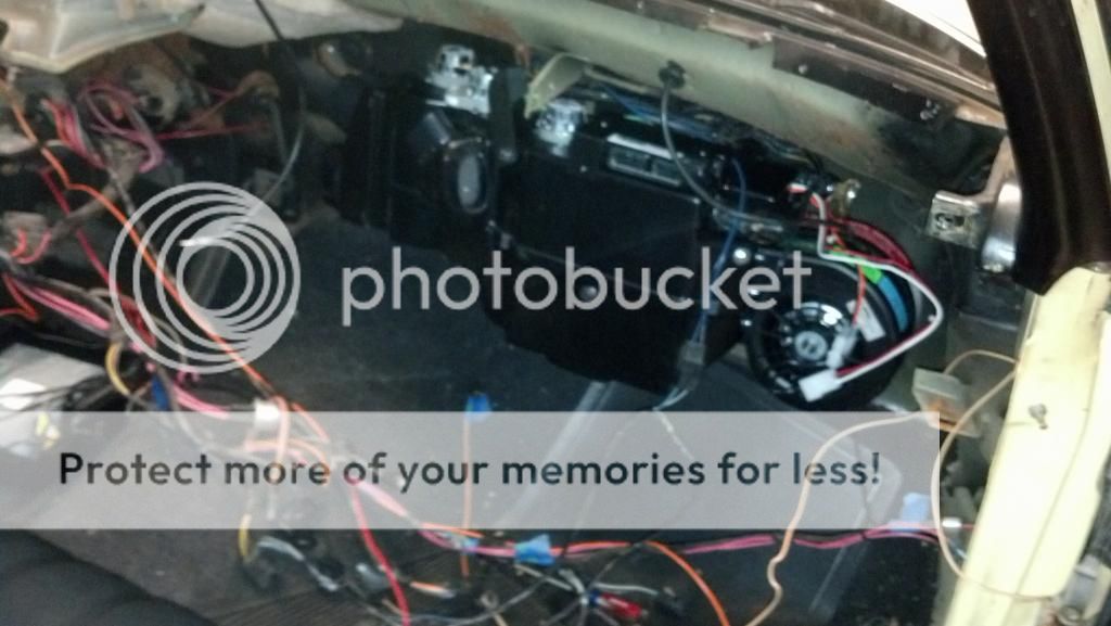

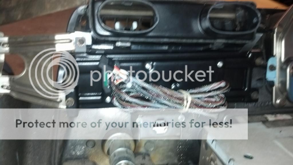

NewTimer Posted March 9, 2014 Share Posted March 9, 2014 Installed the evaporator, kind of been slacking and need to clean up wires behind the dash and then re-installed it.      Had to cut a portion off to get the panel to sit flush      Link to comment Share on other sites More sharing options...
