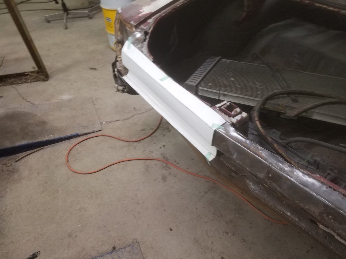

72RustBucket 37 Posted January 4, 2020 Share Posted January 4, 2020 So my tail panel needs to be replaced. I've done lots of searching on the forums for as much info as I could. I think I'm ready to tackle it. I've got some 20 and 18 cold rolled to play around with. I think if i do it in 2 pieces meeting in the middle it will be doable. I'm just making this thread to keep track of how it turns out. I wouldn't mind if anybody else had pictures of how they repaired their's for comparison...being that this isn't reproduced we gotta help each other out! I already made a quick rough template and I think it will work. I will update with any progress! Quote Link to post Share on other sites

72RustBucket 37 Posted January 6, 2020 Author Share Posted January 6, 2020 I'm having some fun. Not there yet but looking better and better. Going slow but I have enough steel for a few attempts. I've talked to Leo, and I'll cave if I think I have to. I think this can be done ! It just wont look exactly like factory but I don't think it needs to. Quote Link to post Share on other sites
72RustBucket 37 Posted January 6, 2020 Author Share Posted January 6, 2020 Well we will call that first one the practice patch lol. It actually went in extremely nice after cutting out that half of the original...but it turns out one of my bends was slightly off making the face of the panel a tiny bit taller. This wouldn't have been such a big except I already did the first few bends on piece number 2 and they are spot on with the original. So next thing to do will be cut another piece and bend it at the same time as the other, so I know I have identical bends. More to come! Quote Link to post Share on other sites

72RustBucket 37 Posted January 11, 2020 Author Share Posted January 11, 2020 On 1/5/2020 at 9:54 PM, Rancid87 said: What gauge steel are you using? 20. I have a sheet of 18 but with the bends 20 is very sturdy . I started on attempts numbers 2 and 3 . Took my time and did everything to both pieces simultaneously to ensure they matched this time...they are identical enough for me now. They need to be trimmed a bit still before tacking in. Hope to get at least the one side in by Sunday. Quote Link to post Share on other sites

72RustBucket 37 Posted January 13, 2020 Author Share Posted January 13, 2020 Well I spent the week slowly but surely making 2 identical pieces. Today drivers side went in. I think it's looking good! Definitely have some issues that I'll have to make sure to address. I'm thinking I might buy the lower section of the gutter from beldenspeed.com. that way I can line it up with remaining gutter(upper half should be salvageable) and then know where additional patches should go. It may not look exactly stock but it will still look good! Let me know what you think! 71MonteCarloMD 1 Quote Link to post Share on other sites

72RustBucket 37 Posted January 15, 2020 Author Share Posted January 15, 2020 Last night I trimmed the passenger side and got it clamped in. Waiting to tack til I have a second set of eyes and hands lol. Quote Link to post Share on other sites

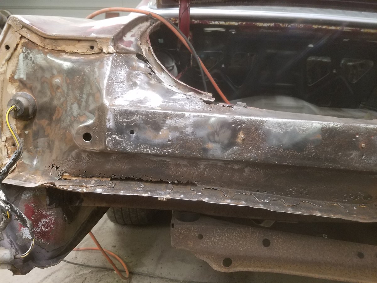

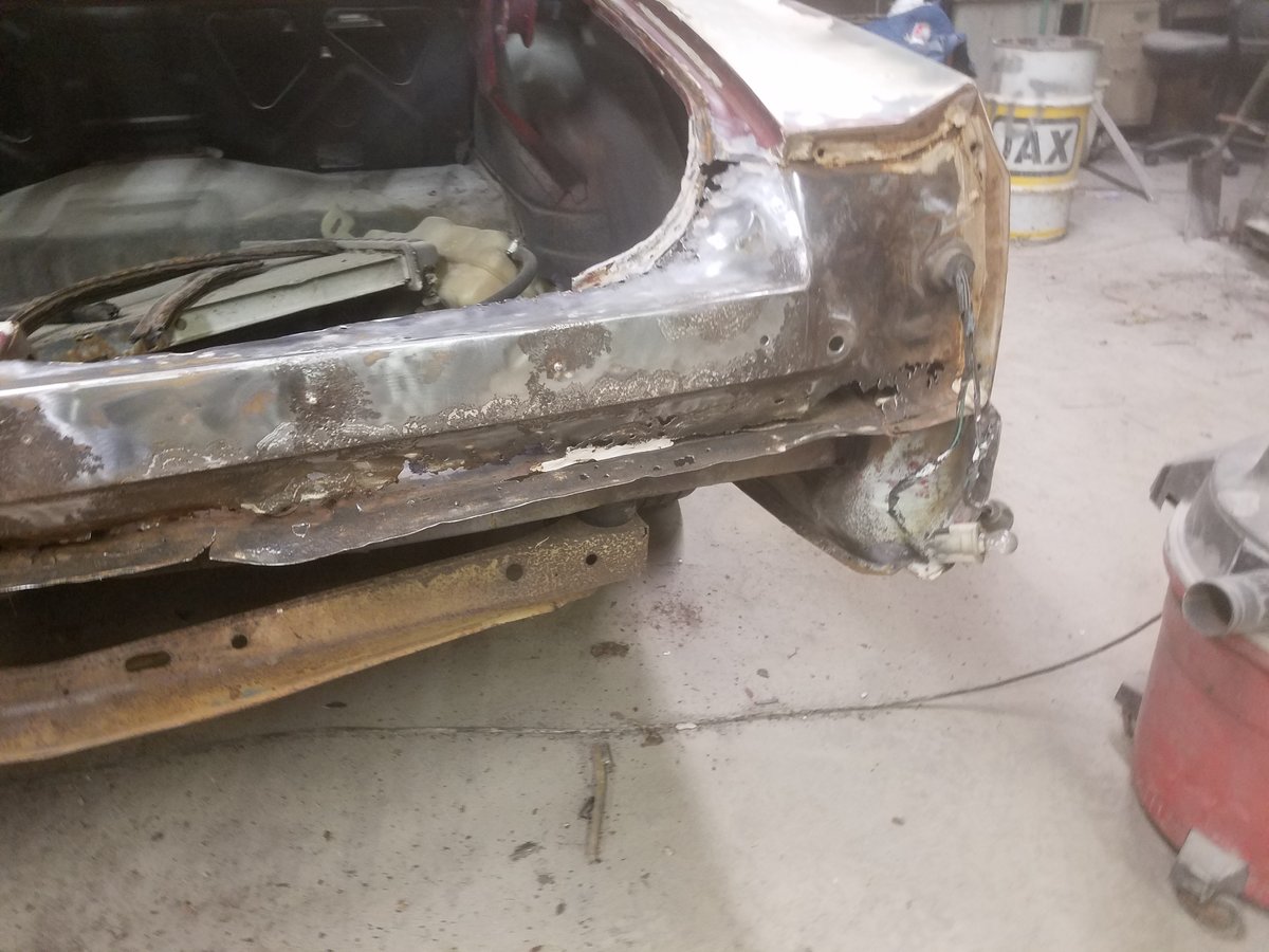

72RustBucket 37 Posted January 19, 2020 Author Share Posted January 19, 2020 Tail light extensions on., cant put bumper on until its tacked, but I think it looks good. Measures the same on mirrored sides, so I should be even. Quote Link to post Share on other sites

72RustBucket 37 Posted January 20, 2020 Author Share Posted January 20, 2020 Passengers side is in. I think it looks good! Still have to put the bumper on, but it looks ok holding it up. Waiting to clean the welds/ re weld until I've got the lower trunk gutter. Want to make sure I don't need to re do anything. overdrive 1 Quote Link to post Share on other sites
