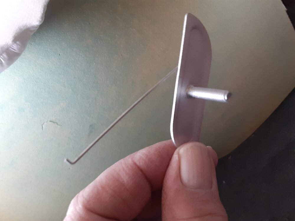

This is kinda what the cips look like. Not the exact clips but the closest I could find. My lower fenders are shot so I actually had to screw mine on but have since got new fenders but haven't got around to putting them on. You may be able to find some pop on clips to get you by for now.
Yea, those are the clips I am struggling with. I will try and find some pop on clips then. Thank you!
