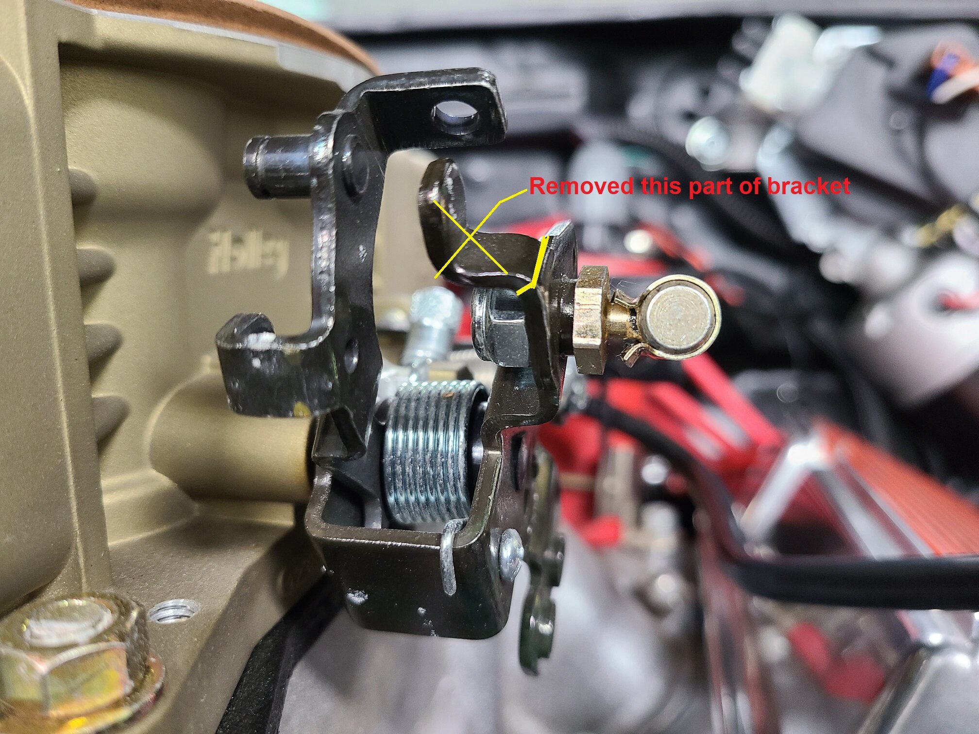

Also, I found that the linkage attachment point on the EFI throttle body of the Stealth T.B. (throttle body) has a shorter pivot point vs. an actual carb. That, combined with the 1:1 action of the primary & secondary throttle plates (they both open equally, at the same time, as opposed to a progressive operation as a carb does) makes for a rather abrupt opening sometimes. The springs on the TB itself are a bit heavy too, which doesn't help.
Holley makes an EFI throttle linkage extension, part number 20-16 that moves the lever point up higher. I did it on my Z/28, but haven't done it yet on the Monte. I did modify the TB linkage, and the extension arm a bit to make it all fit under the air cleaner lid. I think I drilled another hole, a little lower than the top one though, for air cleaner clearance. I also used button head bolts to attach extension arm for cleaner look, but you can probably use the hardware they include with the part. I think I drilled another hole, a little lower than the top one though.
(Some of that extra work may not even be necessary if just using the ball socket mount for the throttle cable, but the Camaro uses a mechanical linkage and needed the extra clearance for attachment. Guess I'll see how that works when I add it to the Monte. In fact, I'll order an extension today from Amazon and see how it works out. It'll be here tomorrow).

Linkage part I removed for clearance on Z/28 (this is the Monte T.B., may need to do it when I add extender to this car):
Mods to Z/28 Throttle Body:

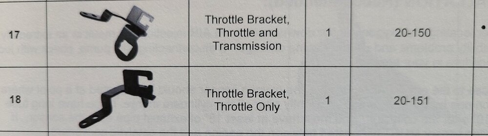

I didn’t get the throttle bracket in my kit, doesn’t come with. I need the 20-151 as I’m running an 80E. The round grommet on the throttle cable fits the square hole on the bracket? Had to ask…

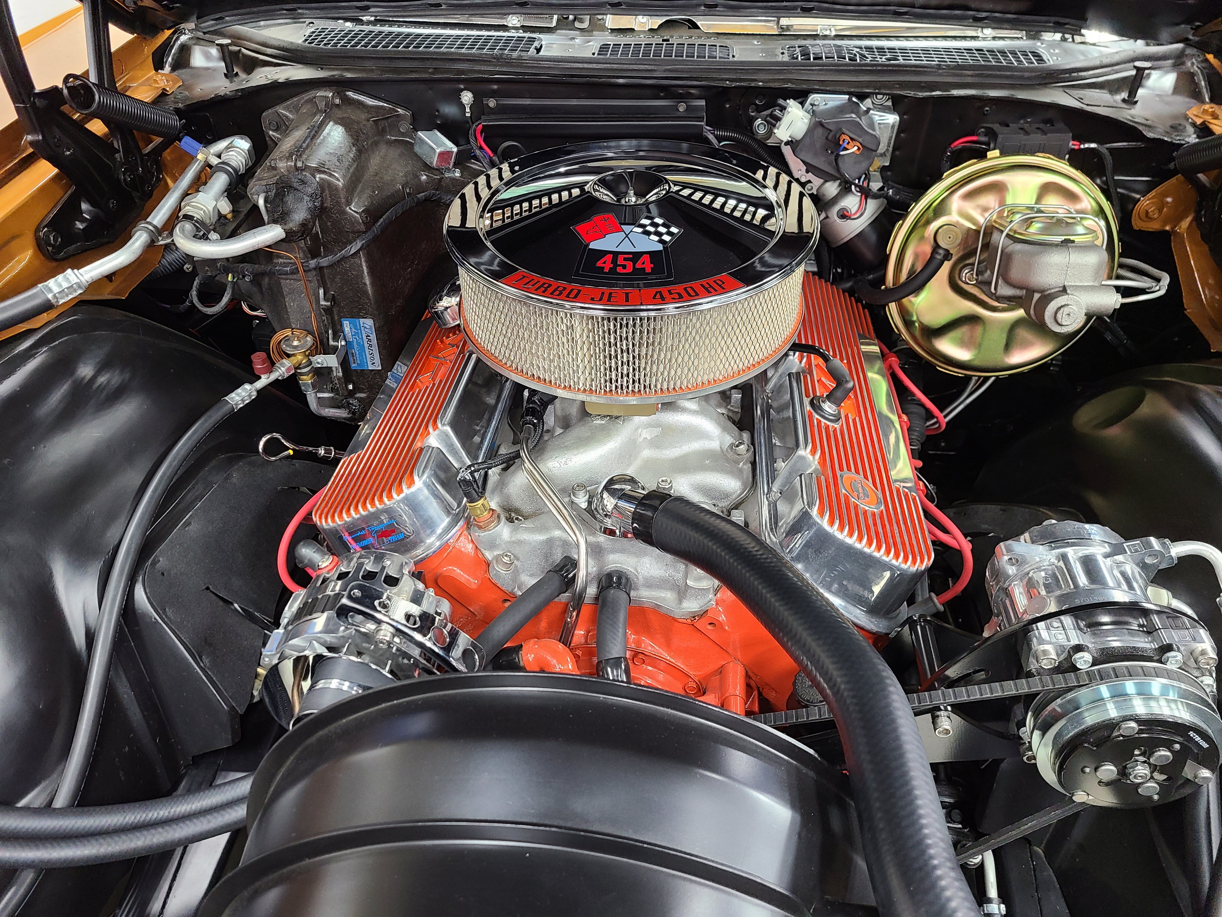

 - Couldn’t help but notice the PCV tube going to the back of the throttle body, is that something that you made or purchased?
  -  Does your breather on the right side connect to the air cleaner?  If so what did you use?
 -   The carb base gasket looks like an upgrade compared to the one that came with the kit. What did you use?
-    How did you connect the brake booster hose to the high rise intake? It’s a tight fit for a fitting on mine.
-    Are you running Hyperspark on your set up? If so where did you mount it?
 - Just curious where did you put the       X-MAX ECU and did you run all of the power and grounds directly to the battery?
-    What did you use as far as a battery. Side post, dual post?
-     Mega fuse set up ?
-     What did you use for the fuel lines that go up to the throttle body?
-      What set up did you use for a fuel filter?

The single hole throttle bracket works perfect in my case with the GM accelerator cable. It slides right in from the side. I don't know if that bracket came in my Z/28 setup (I got that a couple years later). I looked in my box of parts and didn't see one, which is kind of crappy if they're not included now. I'm certain the one on the Monte came with the EFI though.
EDIT: Do you have a Terminator X setup? If so, that's entirely different than the kit I have. That may be why yours didn't include the throttle bracket? Looking at the online instruction manual for yours didn't show a parts list, like my system instructions have. Mine also uses the Dominator ECM:
     I made it out of 3/8" plastic fuel line. Heated it up and bent it to the shape I wanted
No, just a breather on the passenger side valve cover. The PCV pulls in on the driver side
It's a Holley gasket. Same as the one that come with my EFI kit.

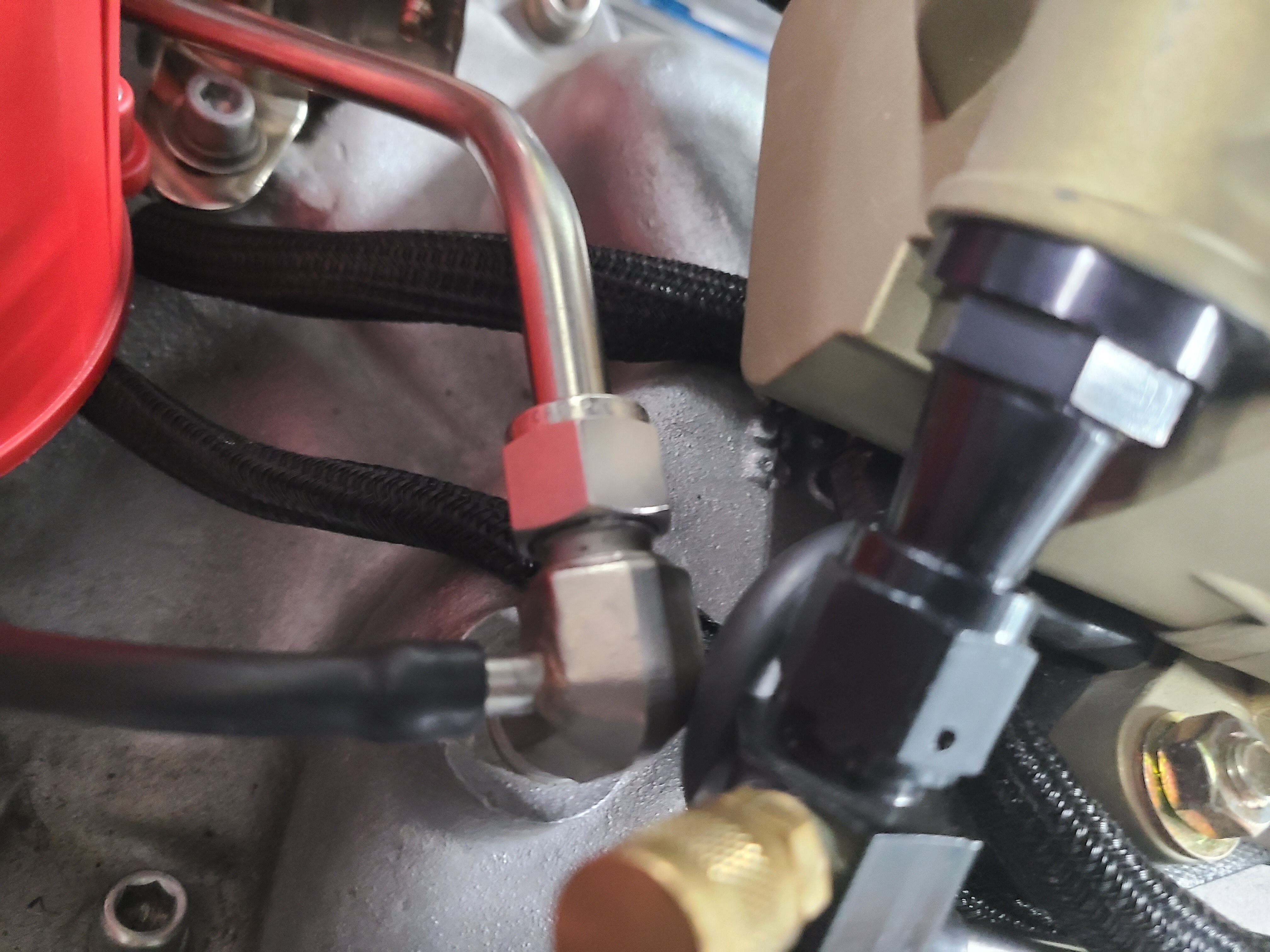

I made it out of Stainless tubing and a modified Swagelok fitting, to feed the HVAC vacuum source.. I also have a Leeds Vacuum pump buried under the left fender. That's Tee'd in with check valves, to isolate the engine vacuum from the pump vacuum. In the Z/28, I just used the Leeds pump.
Initially, I used the Holley/MSD dual sync distributor. Those are failure prone, so I rewired the system, and now use a MSD Small Cap HEI distributor. I have the EFI control the timing, plus have a 'MSD EFI Ignition' CD Spark box, also buried under the left fender
I put the Dominator ECM (because it has trans control) under the dash, above the glove box. I made custom brackets and welded them on to the underside of the cowl. Made sure to isolate it from ground as they intended as well. I wired it up according to the instructions, if it says go directly to battery, do it. I did add extra fuses along the way.
AC Delco Professional, side post.  800CCA, 78VPG. GM part number 88861747
Yes, all part of the American Autowire harness I installed
I fabricated the entire fuel system from scratch. Used 3/8" Cu/Ni feed and return lines to tank, Aeromotive 10 micron filter mounted to the right rear frame rail, Aeromotive fuel tank with fuel pump, and made a 3/8" stainless feed and 1/4" vacuum signal lines to go from the Holley fuel pressure regulator that's mounted below the water pump, to the throttle body.
Most of the fuel system is plumbed with AN fittings as I have the tooling & correct dies to form the hard lines with the 37 degree flare.
Aeromotive 10 micron filter, with -6 AN fittings. Part number: 12347
Aeromotive Fuel Tank: Part number 18108. Stealth Gen 2, 71-72 Monte Carlo. *** They may have a different number for a 1970 ***
Holley fuel pressure regulator: Part number 12-880. Adjustable, bypass w/idle , return style, 4-65 psi

Here's the vacuum fitting I made for the power brakes. Drilled a hole in the side of the Swagelok fitting & silver soldered a piece of 1/4" stainless tube for the HVAC controls.
You can also see the adapter fitting I added to the rear fuel inlet, to add a provision for a fuel pressure gauge (helps when setting the regulator), and also a place to release pressure if working on it.

-I purchased the G-Force crossmember for the 4L80E but that didn’t work out. I had issues with way too much flex in that crossmember which was causing the frame to flex. Not good at all! I did call G-Force and they told me that it is intended for an A-body that has a boxed frame such as a convertible. Not stated when I purchased it. They did give me the option to return it. I’ve decided at this point to use the factory crossmember and modify it.                                      Can you elaborate a little bit more on your re-engineering of the stock crossmember? The stock crossmember is rubber mounted. Did you eliminate the mounts and bolt directly to the frame? Did you keep the crossmember facing the same direction as factory or did you flip it around? Any details will be helpful.
I looked into the G-Force route. The driveline angles alone would have put it way out of whack. I sort of documented it in my thread, but this link will take you right to it. Scroll down 3 or 4 more posts from that & you'll see the finished product.

-Where did you purchase your fuel/transmission lines from? Did they sell them in long lengths?
I buy it by the spool, all sizes for brake lines & fuel lines. I've been using the 4Life Time Lines brand with good results. No issues bending, flaring, forming the ends etc. I usually got if from Amazon, but the prices have went up a lot. I see they offer 2 rolls of 3/8 direct from the manufacturer for less than Amazon. Plenty of other vendors though that sell the same type of tubing. I got the AN fittings from Summit, and also some from Amazon.
Here is an example:
https://4lifetimelines.com/products/copper-nickel-brake-line-tubing-2-coils-3-8-x-25
https://www.amazon.com/Brake-Line-Copper-Nickel-Tubing-Universal/dp/B07C8N5K95

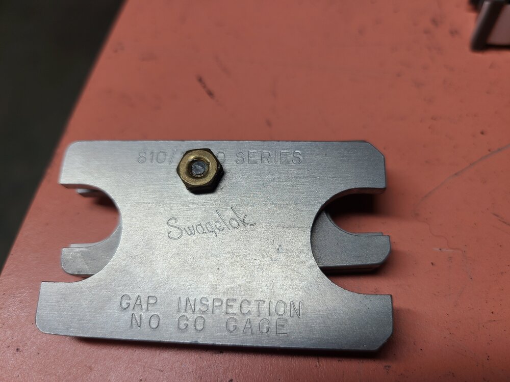

Swage lok
Really? Trying to correct my spelling, John? 😁
I have thousands of those fittings, valves, adapters, etc on hand. Used to work in the chemical industry. Brass, stainless, titanium, monel, etc.
