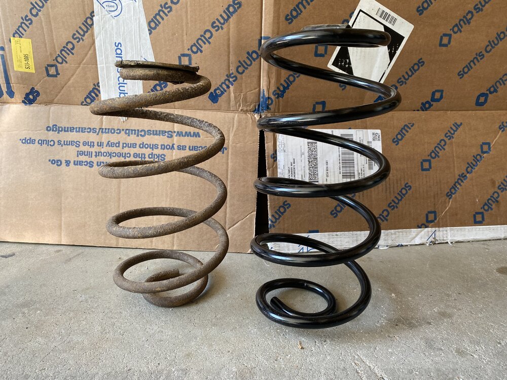

Today was a busy day. Started off by replacing the rear springs, she had a lean to the passenger side so I’m hoping this will correct that. Shocks were also toast so those had to goIMG_8277.thumb.jpeg.ed1ff4033bf194ce95db41108712bfee.jpegIMG_8265.thumb.jpeg.61b359a4469c7020fe63351700b30989.jpegIMG_8278.thumb.jpeg.8ef2013cd5efd9e2ae506d716e2a92db.jpeg

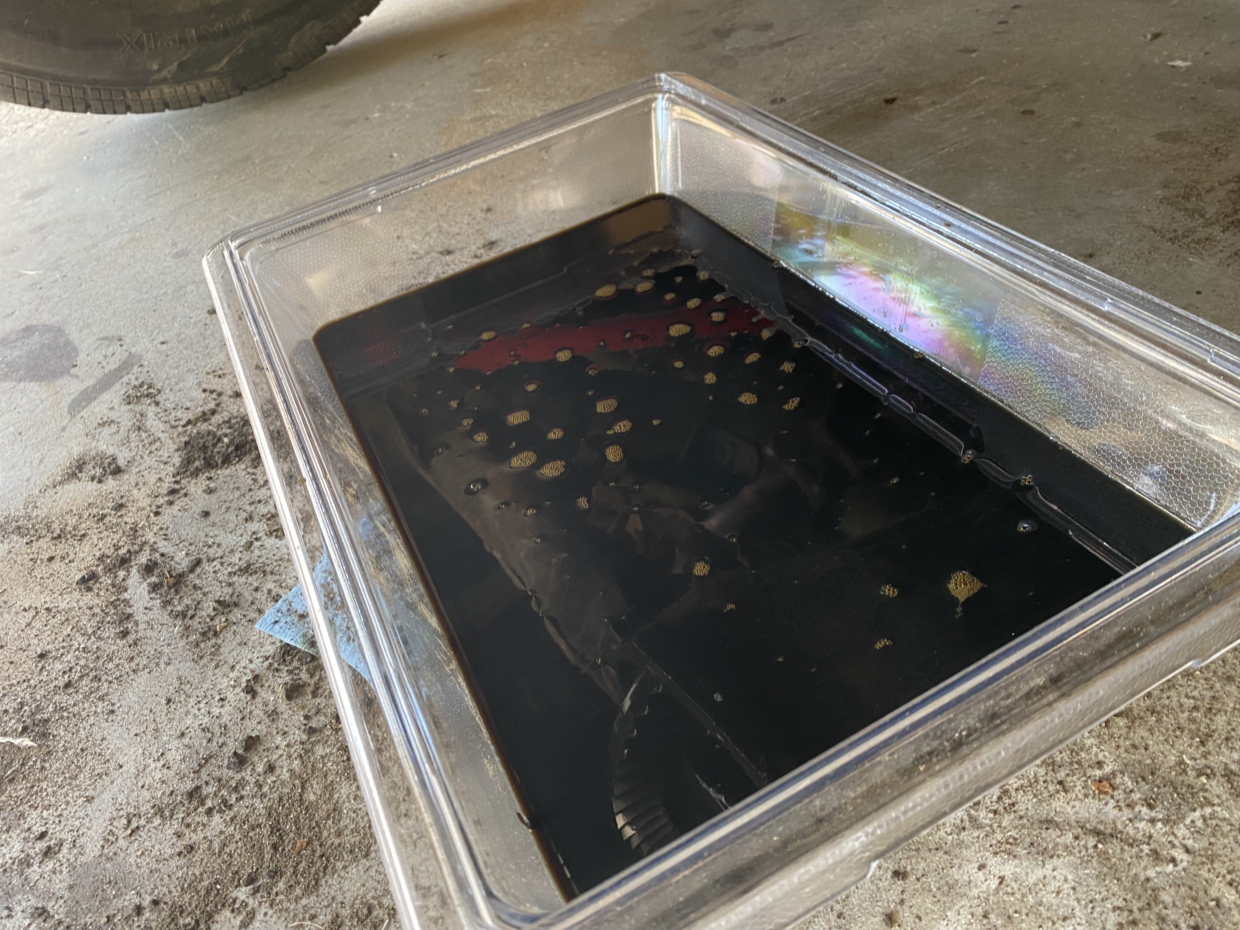

While I was back there I pulled the cover off the rear diff and replaced the oil. Don’t forget to change your diff oil once in a while or it will look like this! Cover was full of slime so that had to be cleaned too. Not showroom ready but much betterIMG_8267.thumb.jpeg.7d4f8e706fa14ec9f93d8bade8ee6e84.jpegIMG_8266.thumb.jpeg.d3f4d1349bf689d27e60f4029511003a.jpegIMG_8268.thumb.jpeg.c0f1b5215a7ab03b37ab910973c2cd73.jpeg

Moving forward I had noticed the trans pan leaking so I dropped it and changed the filter. Here is a tip for everyone, if your trans pan bolts are all finger tight it’s going to leak…. Whoever had this car should not be touching cars. Anyway the pan was just as bad as the rear diff cover, but the fluid was nice and clean…. So someone dropped the pan but didn’t bother to clean it? No idea. Anyway it’s clean now and back in 👍IMG_8275.thumb.jpeg.894d3ac1580b8aad7fbcbf8871e0dc25.jpegIMG_8276.thumb.jpeg.f6783b2223d2d5a2fc852df3ab1d6bb7.jpegIMG_8279.thumb.jpeg.528a3f2f54e07006ac33e7e801f35fa8.jpeg
 Sorry to inform you of this but, that transmission doesn't have a long life left. And I'm sorry, there is no way the fluid was cherry red. Maybe slightly reddish at best.  Way too much material in the bottom of the pan and trans fluid acts like a detergent.
Oh ok thanks for correcting me. I must not know what I’m talking about.
Andrew please don’t take offense to Tom’s comment. I get what he’s saying. The picture of the dirty trans pan tells the story. That’s a lot of fiber material in there. Is it possible that the previous owner may have started to have slippage and just did a quick fluid change to see if that would fix the issue?

2 hours ago, Dtret said:
.... and just did a quick fluid change to see if that would fix the issue?
And that almost never results in a good outcome, especially if there are a lot of miles on a transmission.
If a vehicle came in with a lot of miles (say over 100K) without ever having transmission service/fluid change, I wouldn't usually touch it. Especially if it exhibited signs of trouble. That new fluid with all those fresh detergents tend to be the kiss of death shortly after.
I've personally seen it, plus it's backed up by my a cousin-in law with many, many decades of experience as a father/son owned transmission shop.
Look on IATN ("International Automotive Technicians Network", I've been a member since 2006) , you won't find too many experienced techs that'll recommend a high milage fluid change either.
That being the case Andrew, as with the car being new to you, I would have changed all the fluids too. Hey, if something happens down the road, you deal with it. If it runs great for a long time, even better.

Seeing that drain plug, they probably never even removed the pan. I could be wrong but I don’t remember GM putting drain plugs in the pans. I always felt it was intentional to force pan removal for cleaning and more importantly, filter replacement.
