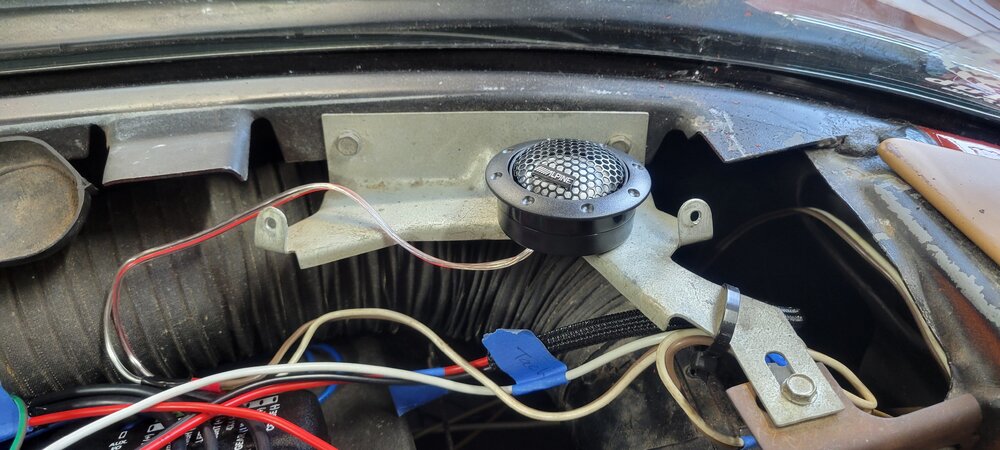

BobW Posted February 28 Share Posted February 28 While I am happy with the kick panel speakers, I hoped I could do a bit better. Talked with a friend that does hi-power stereos. He'saware of my hearing difficulties and understands that pure volume is not the answer for me. He suggested I try some tweeters in the dash position, and he was right on! A pair of Alpine tweeters fit with no intereference and deliver the sound quality I wanted. 3 Quote Link to comment Share on other sites More sharing options...
