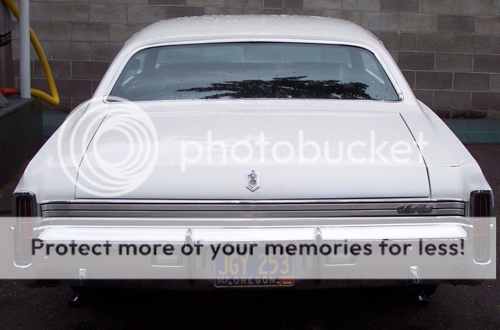

72-CLASSIC_RIDE Posted June 13, 2012 Share Posted June 13, 2012 Here is how I installed Rear Bumper Gaurds to a replacement ReChromed Rear Bumper. (Note: Holes were not predrilled). The surface area on the inside of Back Up Lights is location for Rear Bumper Gaurds. There is limited surface area for installing them as the contour of the bumper changes for the fuel door/license plate application. Used masking tape to cover area where gaurds would be placed. Used bumper gaurds to pencil around them and locating holes to be drilled. Identified a centerline to measure out each side for parallel/vertical alignment. Repenciled borders for fine tuning alignment/hole centerlines! Once those measurements were identical from my centerline top/bottom/center and verified where my holes needed drilled, I then proceeded with the installation until secured to the bumper. I did this with the bumper off of vehicle and made it much much easier to get the dimensions I desired. Worked very well for me! Here is a pic of the masking tape marked up and centerline for holes needed drilled. May not be optimum for your installation but hopefully will provide some guidance. Just check & recheck your dimensions for accuracy before drilling the mounting holes. Once satisfied, you can't go wrong. I had noticed where the mounting hardware was welded inside the bumper guards are not necessarily flush/flat to bumper and can cause bumper gaurd(s) to angle inward or outward. If needed, a little shimming can correct this possible condition. One of my front bumper gaurds is slightly angled in and have not attempted to correct this as yet. I don't have any info as to correct placement of the front gaurds. But again, here is a pic as the fronts are fastened now. Can't say if either front/back were originally factory installed/dealer installed or were added sometime after intial purchase. However, where they are placed makes sense as they are in far enough to protect the rest of the bumpers from impact if backing straight into or hitting forward. Oh yeah, here is a pic of the Rear Gaurds after installation! Doug Link to comment Share on other sites More sharing options...

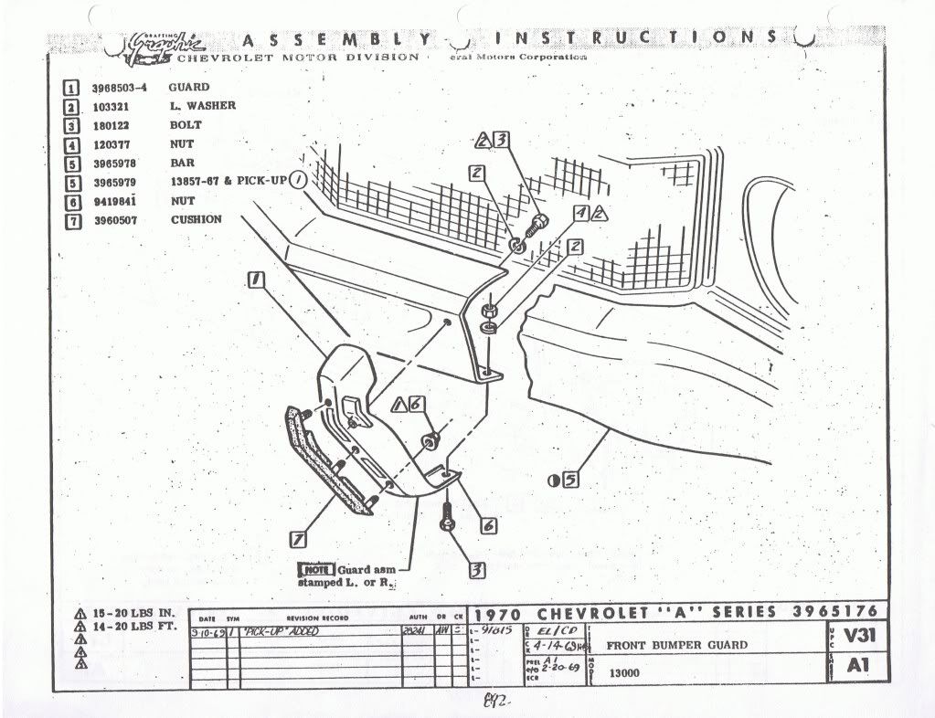

70mcarlo Posted June 13, 2012 Share Posted June 13, 2012 Abe - here are the instructions included with my NOS set of rear bumper guards (it also shows the front guards - I don't know if or how many Montes actually have the top bracket depicted). A very basic template was also included - I'll mail copies to you - I still have your address. Link to comment Share on other sites More sharing options...

Canuck Posted June 14, 2012 Share Posted June 14, 2012 Abe - here are the instructions included with my NOS set of rear bumper guards (it also shows the front guards - I don't know if or how many Montes actually have the top bracket depicted). A very basic template was also included - I'll mail copies to you - I still have your address. Very interesting. My 72 front bumper guards use that top bracket as shown. I actually thought it was not stock until now. The front guards are held on with the bottom hole and the bracket on the top. My 70 front guards are held on with the bottom hole and the hole halfway up the bumper. I like they way they are mounted on my 70 better. Link to comment Share on other sites More sharing options...
