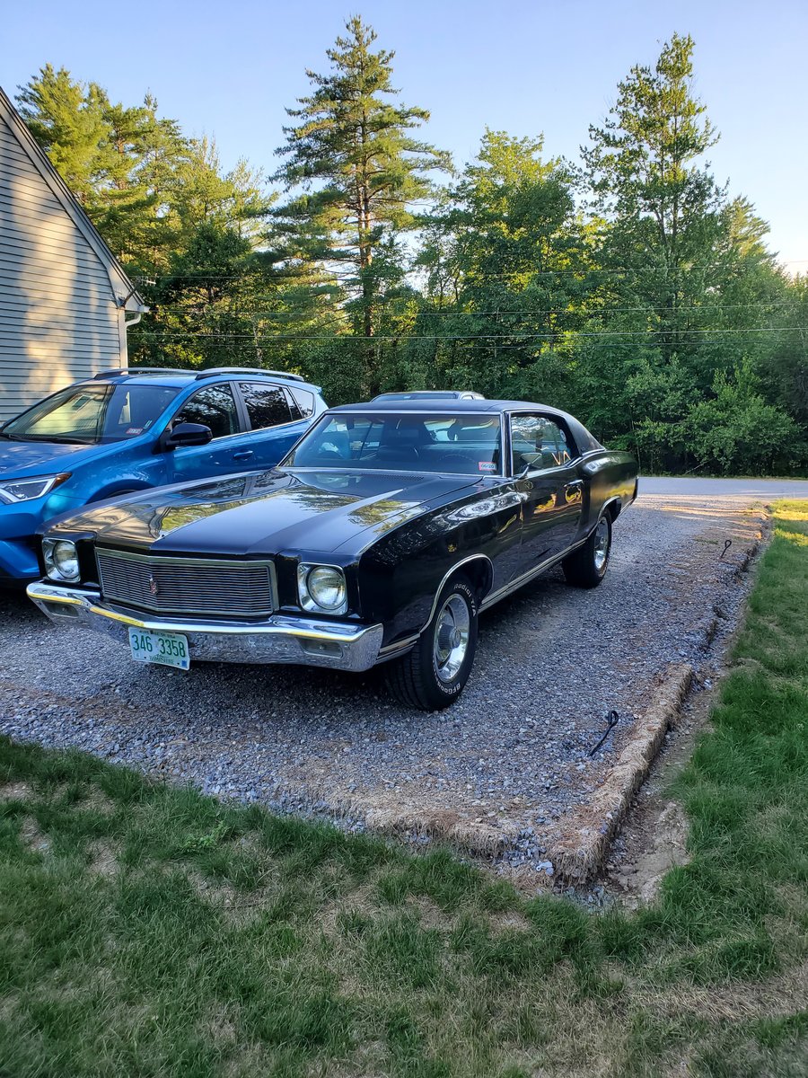

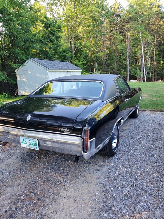

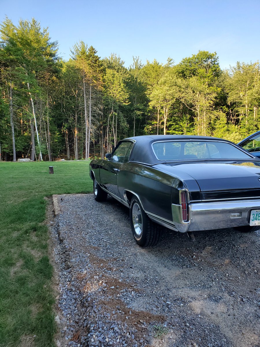

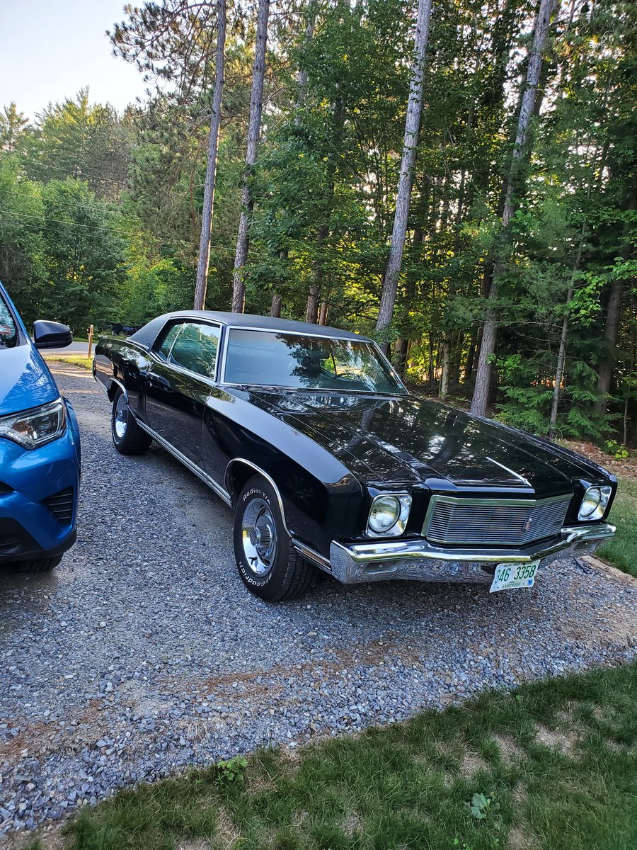

I cut my automotive teeth with Monte's back in the 80's and decided it was time for another. Previously, I owned a 70', 73, 74 and a 2001. My father had a couple of '76's he bought new (one was stolen a month after he bought it).
So today, this black 71 followed me home. It's a pretty good driver and a decent 20 footer and I plan to undo some odd "modifications", freshen up the interior and address some iffy body work on the drivers quarter panel. Under the hood is an 8 year old 350 with a mild cam and a 650 Holley, headers and MSD ignition. She's got some spirit but I'm pretty sure there's more power lurking in there after a tune. The front end seems loose as it does tend to wander a bit and there's some slop in the wheel so that will be first on the list.. I'm sure I'll find more but it's a great project that can be driven for now.

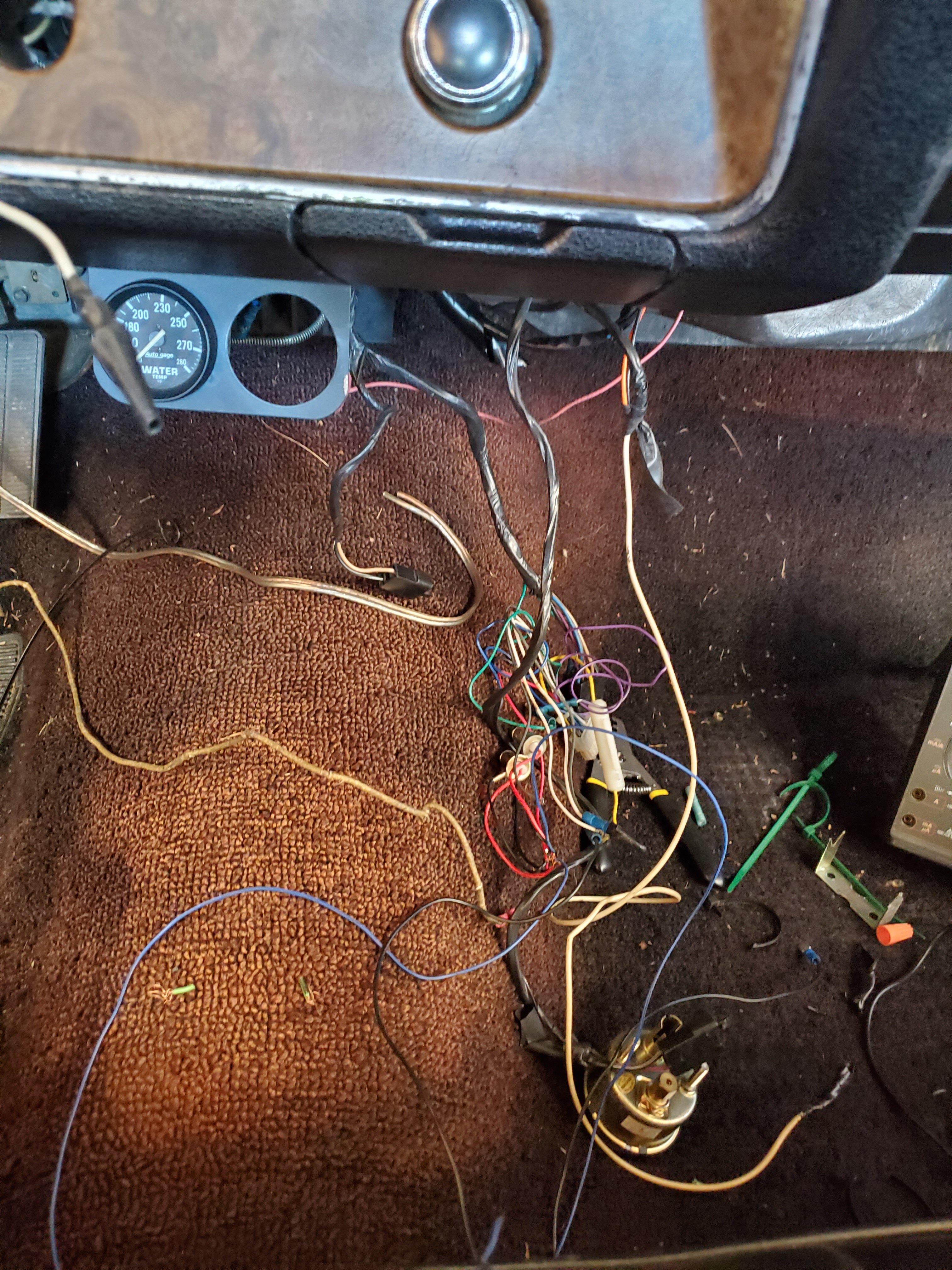

Next I started looking at the disaster wiring job. A previous owner had installed an aftermarket "system", using a harness that can only be described with a hearty "WHAT?". I was able to successfully extricate this mess, but unfortunately, the original wiring harness has been butchered to the point it will need to be replaced. All of the original connectors are gone and some has been re-routed to parts unknown.

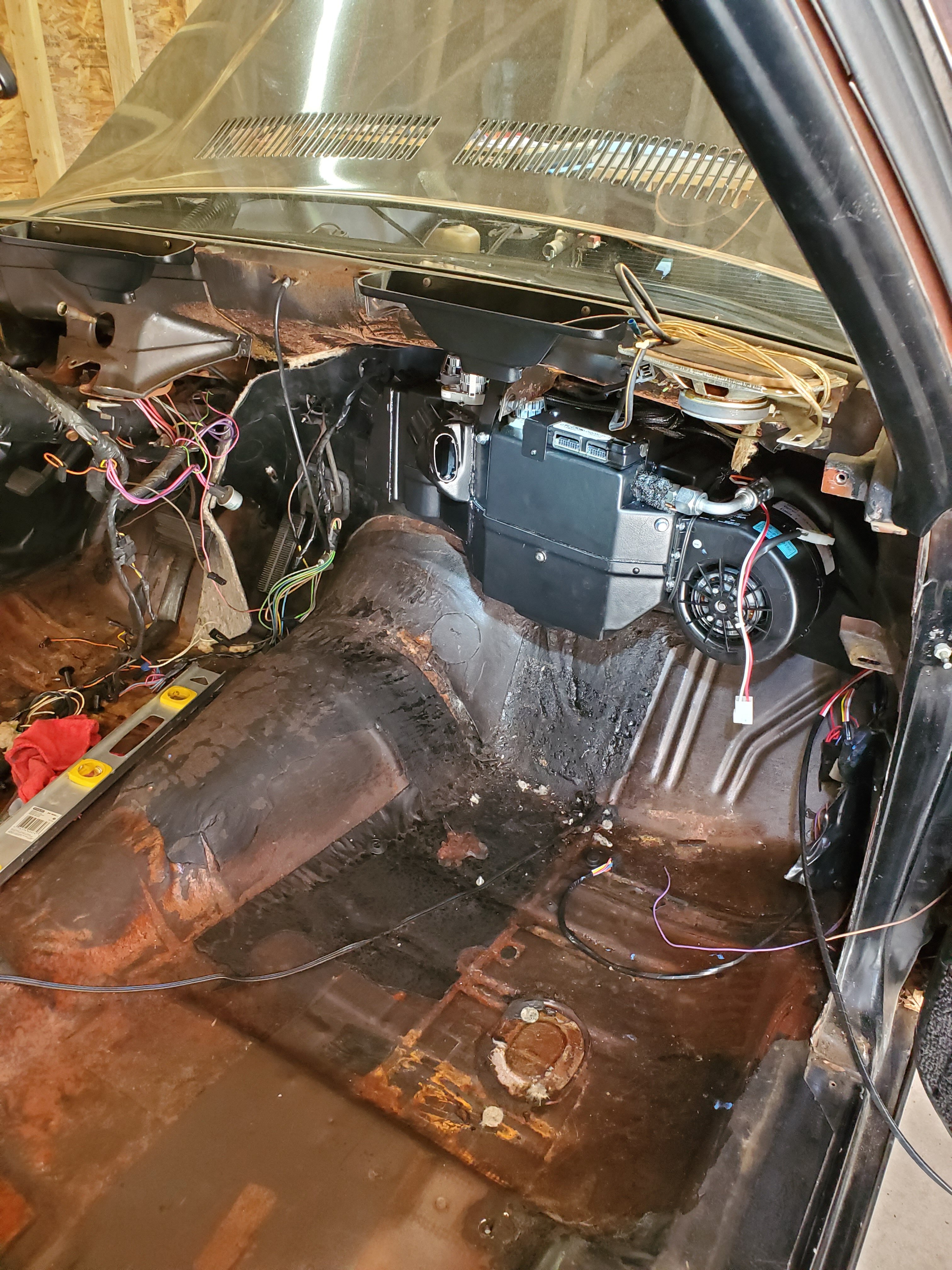

Last weekend I replaced the rear lower control arms and this weekend, I decided to rip the interior out and get started on the Vintage Air system.
I was able to get the hoses routed and the evaporator case installed, and the firewall insulation replaced. A little tip to anyone contemplating one of these systems, both heater hoses need to be 5/8", so you'll need to replace the 3/4" nipple as well. I wasn't aware of this until it was almost too late.
The only issues I found under the carpet was this area under the passenger side of the rear seat. I'll be replacing that section sometime in the next month or so.

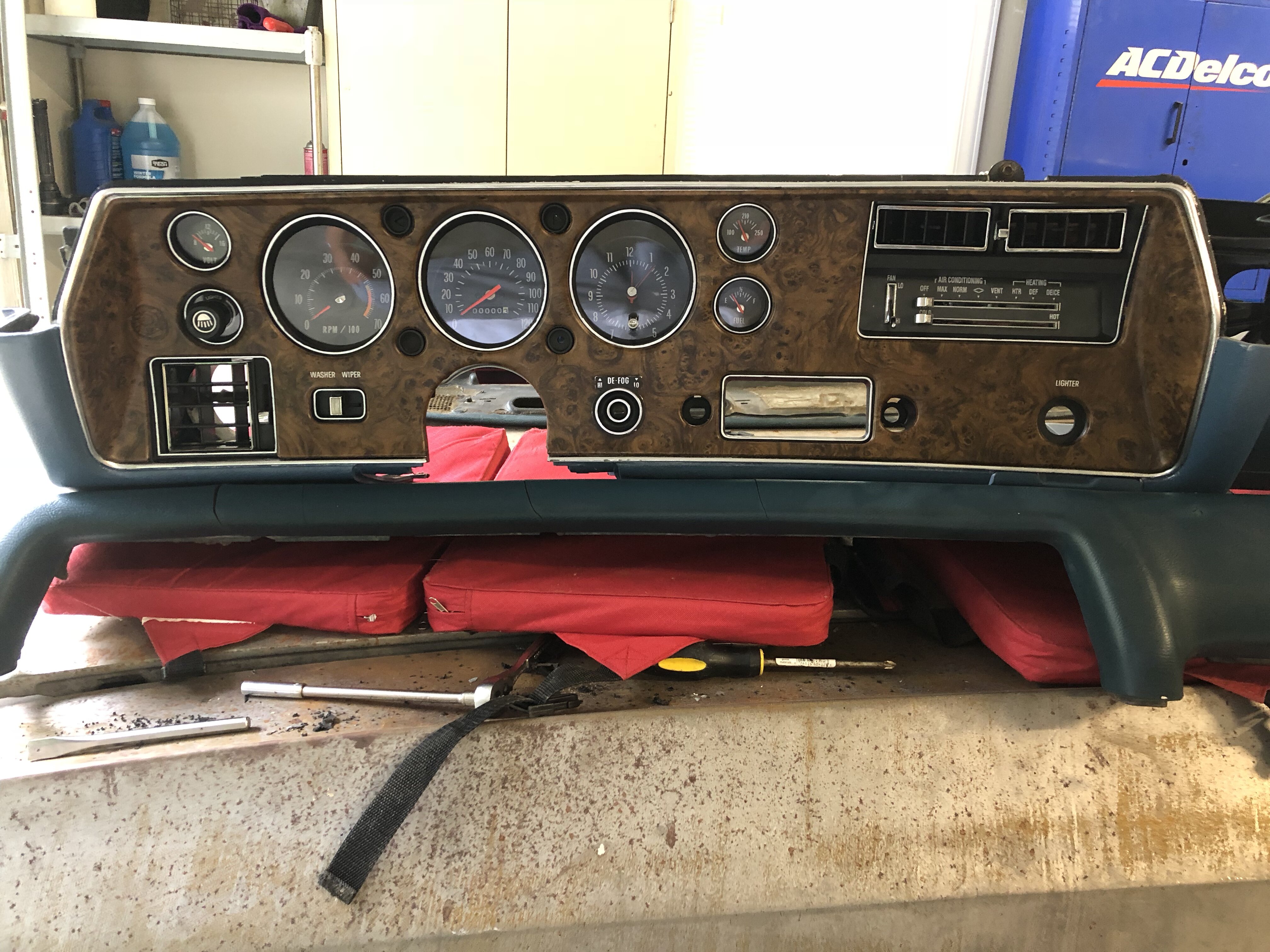

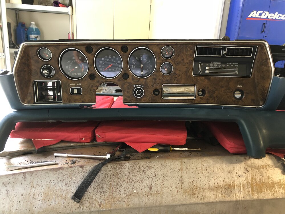

The instrument cluster looks pretty rough. My plans were to replace the clock with a tach and insert guages in place of the idiot lights, but now that it's apart, I'm thinking I may go with a Dakota or something similar.20201011_152542.thumb.jpg.0b5fefb92264181495f6a54359a6e0c0.jpg
As usual with these older cars, one project turns into several. Fortunately for this car (and me) there are more wants, than needs which makes it a lot more fun.
2 hours ago, Leghome said:
I love my Dakota Digital gauges
Me too, you won't be sorry if you go that route.
