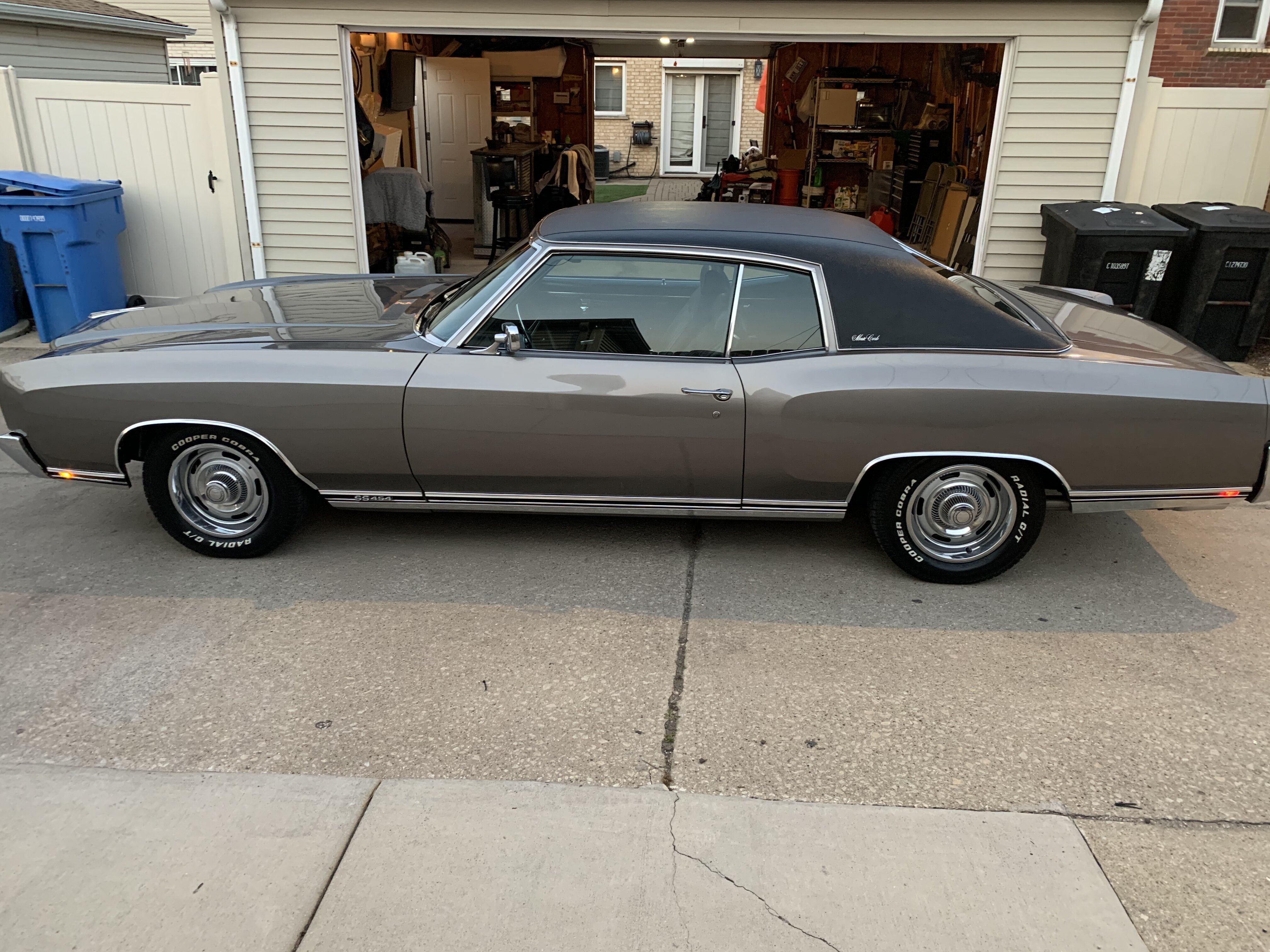

Spent four hours applying elbow grease to the Monte this afternoon in preparation for a nice drive to meet friends for dinner this evening.
Washed, tires bleached and dressed, vinyl top conditioned, windows cleaned, chrome polished and a final wipe with quick mist detailer... or so I thought.
I noticed the horizontal surfaces were rough to the touch. Broke out the clay bar and put two and two together... car must’ve been in close proximity to where the valve covers were painted (see the picture below - sure looks like Chevy Orange!).

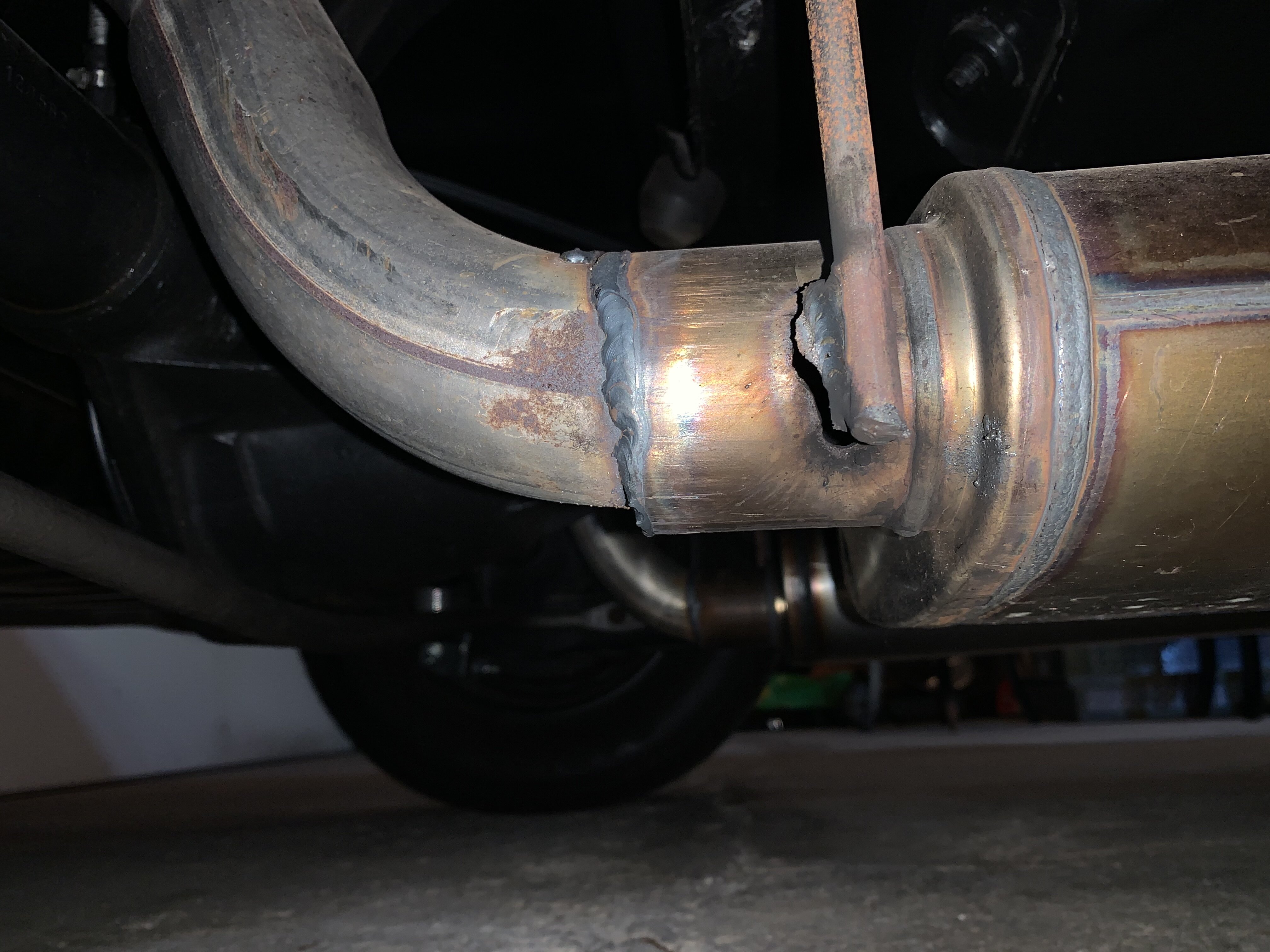

Car looks terrific, rode awesome and got a ton of looks. But pulling into the garage I noticed the exhaust tone was different. Suspected a leak somewhere on the passenger side and sure enough I found it immediately. Easy enough fix, but it’s always somethin’...

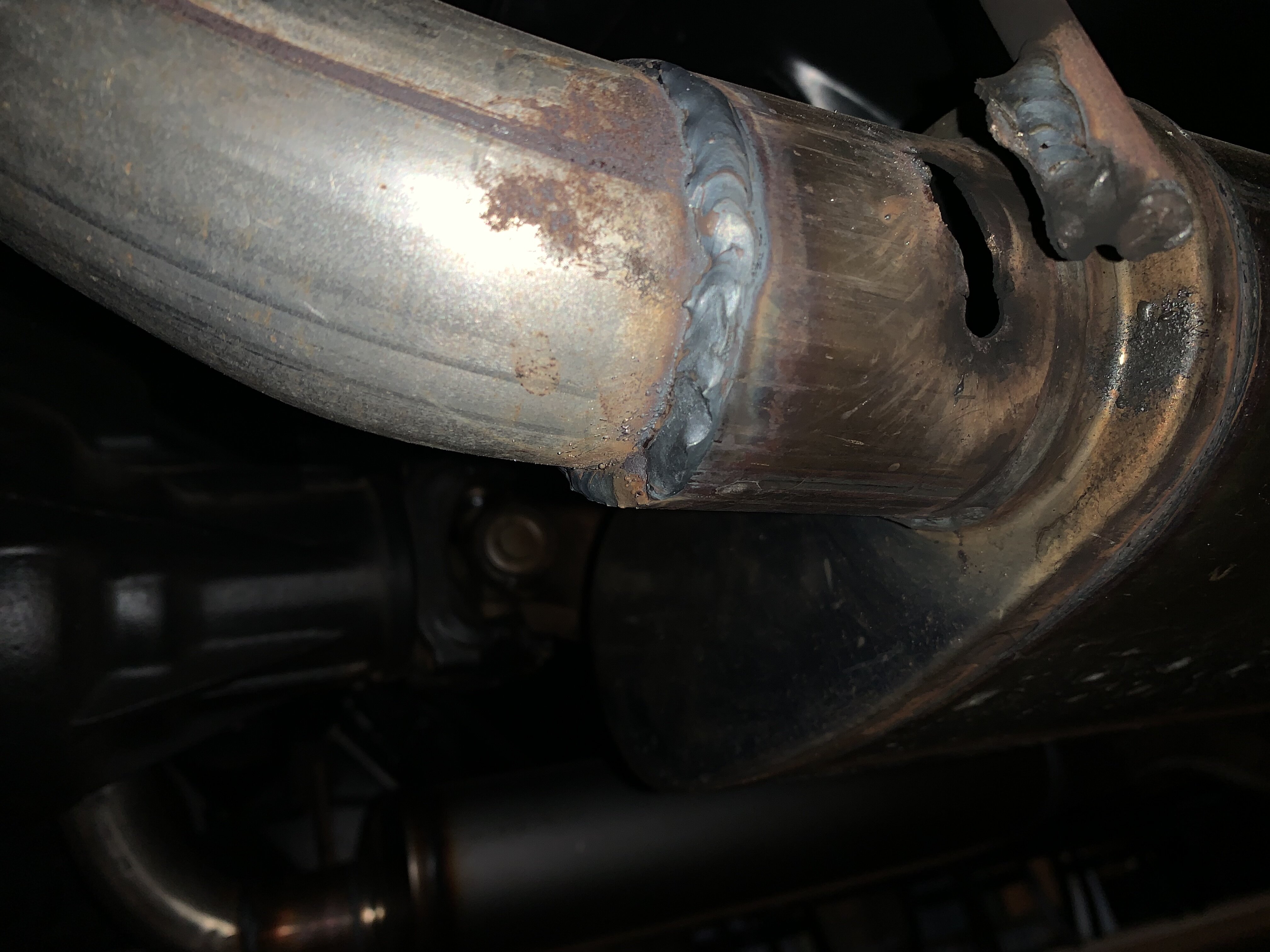

My exhaust broke in the exact same place with the weld on exhaust hanger breaking off. Repaired it with wire feed welder and used factory exhaust hangers and clamps to repair

Looks great and sounds good too. I was never a fan of welded on hangers. Welding them on the pipes always seems like it makes a weak spot. Clamp it.
Thanks Dtret. I didn’t have a choice as the car arrived with this exhaust, but I was also leaning toward a traditional hanger as the fix.  Don’t get me wrong… I really love the way she sounds, but you’re absolutely correct ... this mounting process obviously leaves the metal compromised.

This is what I did to repair it you can see the repair that I built up then ground down.
John S
Well done. Are you going to do the other side also?  Cause you know it’s coming. Get it on your terms. Lol.

Yes the other side is done also. And I also took the other weld on clamps off in the rear and put the original clamps back on. I’ve done this long enough to know that if one side breaks the other is not far behind.
