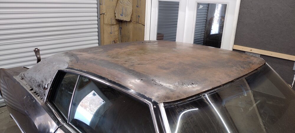

B-Man Posted February 18, 2024 Author Posted February 18, 2024 I've got the vinyl top, butyl rubber tape and major rust removed and cleaned up. I went through a bunch of heavy wire wheels and flapper discs. I picked away at it over the last couple of months, not having near as much time to work on the car as I would have liked (typical). I just cleaned it all up with acetone before I took these pics. Next step is to apply the rust reformer / primer to the whole top. I want to keep as much of the metal, and particularly the shape, as I can. It will make it easier to form the fiberglass correctly. It won't be perfect in the end but it will be A LOT better!!! Here we go ... 2 Quote

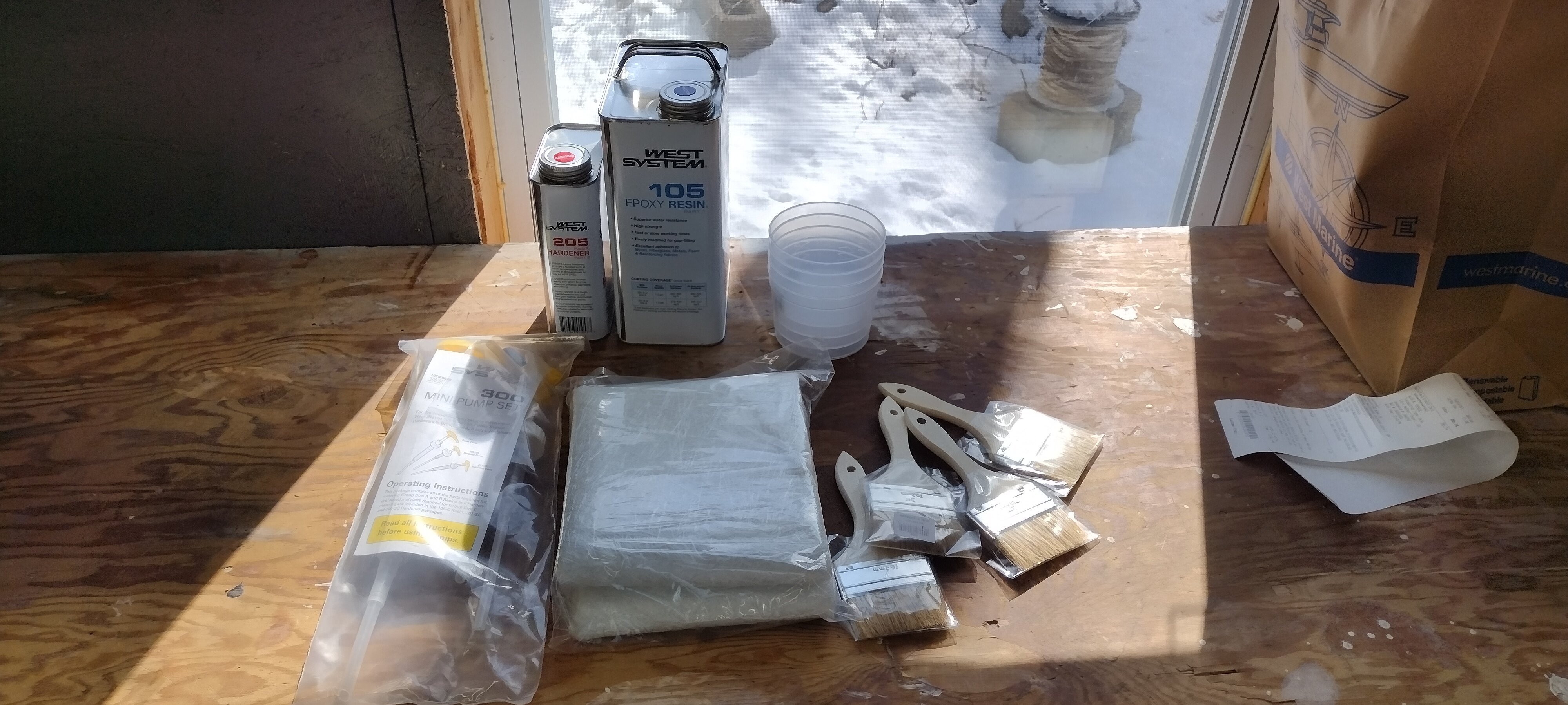

B-Man Posted February 18, 2024 Author Posted February 18, 2024 $285 at West Marine. Let's go!!!! Quote

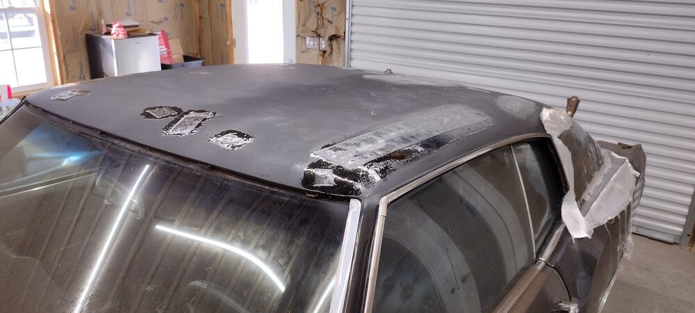

B-Man Posted February 18, 2024 Author Posted February 18, 2024 Ok, I've got the patches and first layer of fiberglass on. This stage always looks incredibly messy but it's actually a good start. Just wet the prepped metal with some resin, lay some fiberglass on it, then tap it with the tip of the resin-wetted brush. Tapping with the brush will push the resin into the cloth and get rid of any major air bubbles. From here I expect to go at with a 60 or 80 grit DA. After I get all of the high spots and edges down it will be prepped for the next layer. I'm hoping the next layer can be a full 4ft wide layer that will cover the whole roof. But I will probably have to fill some areas and build up and shape the big holes that we're missing so much metal. More later 1 Quote

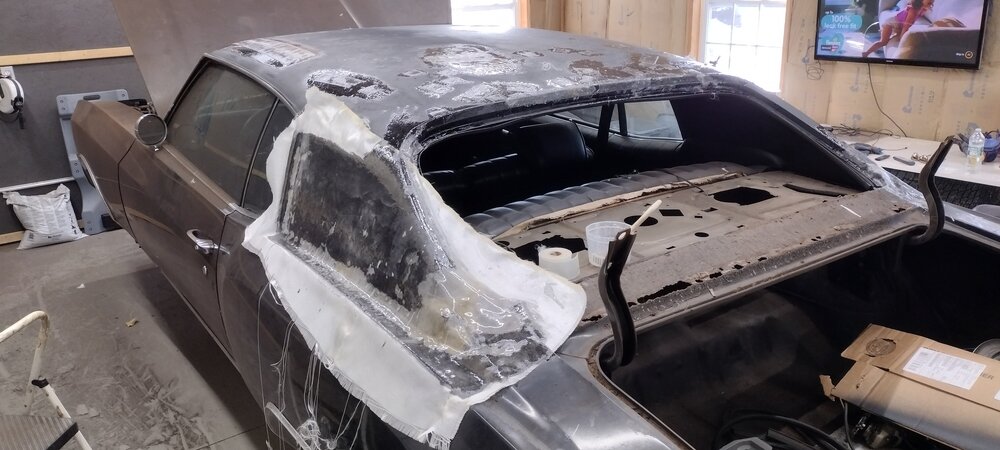

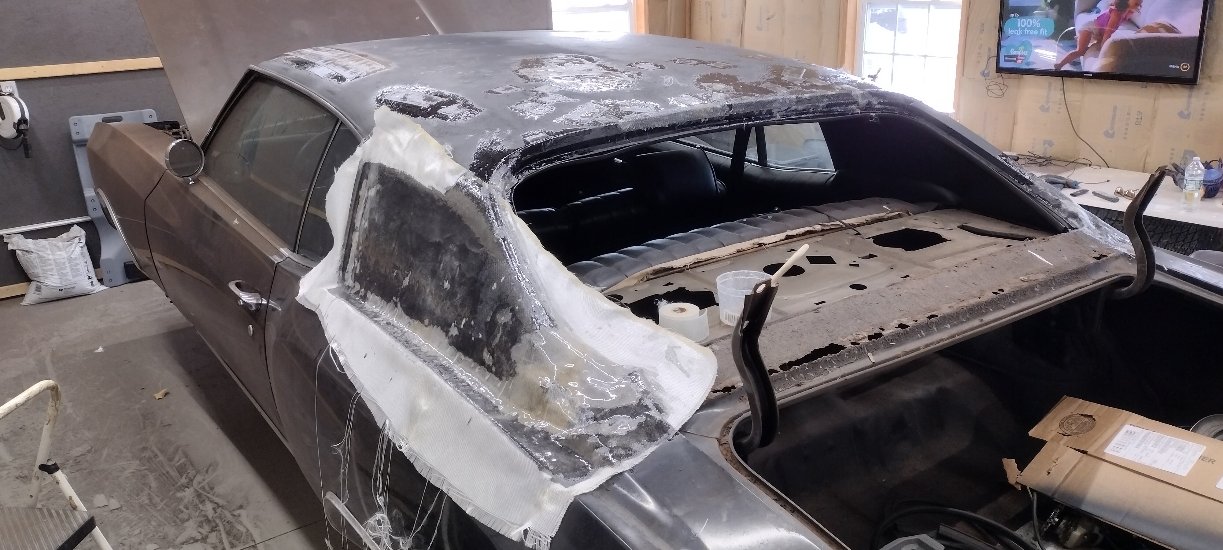

B-Man Posted March 1, 2024 Author Posted March 1, 2024 A quick interim update. The first go at patching the holes with fiberglass went very well! I wasn't happy with a few spots so I cut the hardened glass out and filled with flox (resin with cotton fiber bonding). And I put a first layer of micro (resin with microspheres) over the glasses areas. I will be sanding them in a few minutes here and will report back. I'm only working the passenger side for now. The resin sets up too quick to work too large an area at once. Happy with where I am so far! 3 Quote

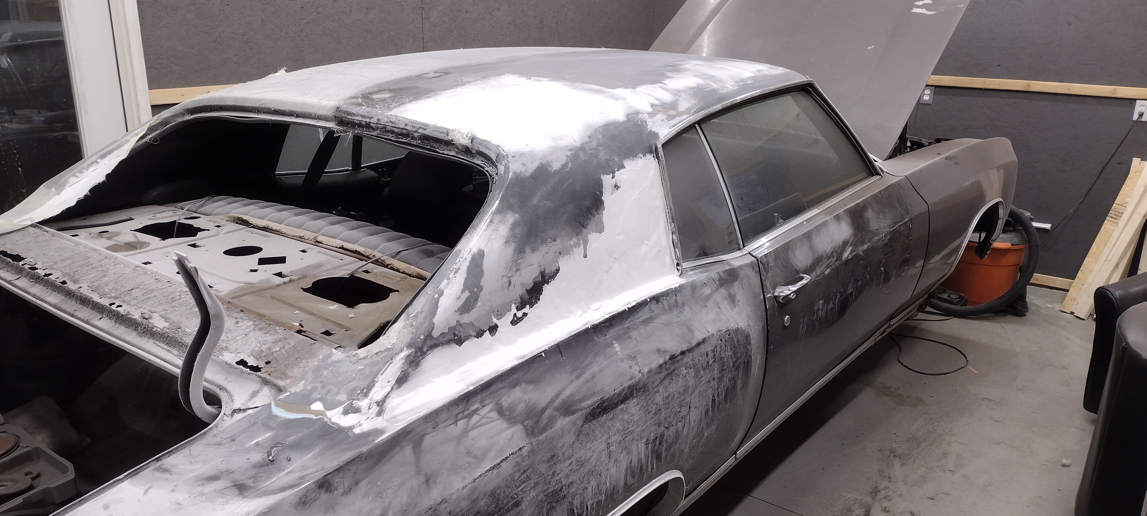

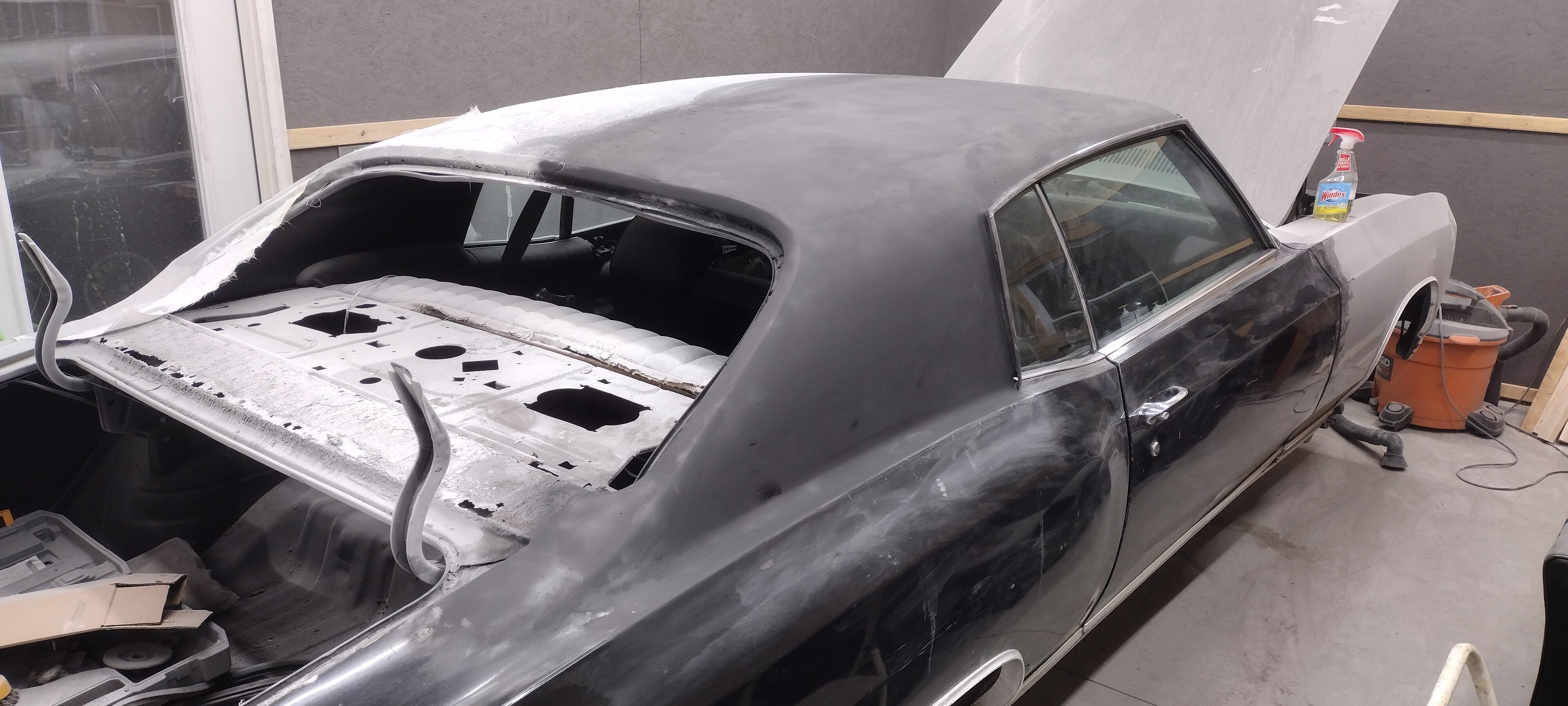

B-Man Posted March 8, 2024 Author Posted March 8, 2024 A couple of small spots to fill and resand, but for the most part the passenger side is all done. On to that GIANT hole in the driver side!!! I haven't used any of the thick fiberglass mat that I bought yet. And only about 1/4 of the resin. I'd estimate that I'm about $100 to $150 in materials into this, and about 6 to 8 hours of glass and sanding work. Certainly a big $$ savings, but a good amount of time. 4 Quote

B-Man Posted March 14, 2024 Author Posted March 14, 2024 @Robert, yeah man, will do. I'm out in my garage right now. I just put the final primer-filler coat on the passenger side. And getting ready to do the initial 'gross sanding' on the driver side. I do think I will end up pulling the glass off that giant hole in the driver side sail panel and rethinking my approach - it needs more structure under it than what I was going to end up with on my initial approach. We shall see. Something creative will come to me! having fun, and looking forward to some spring driving!! 2 Quote

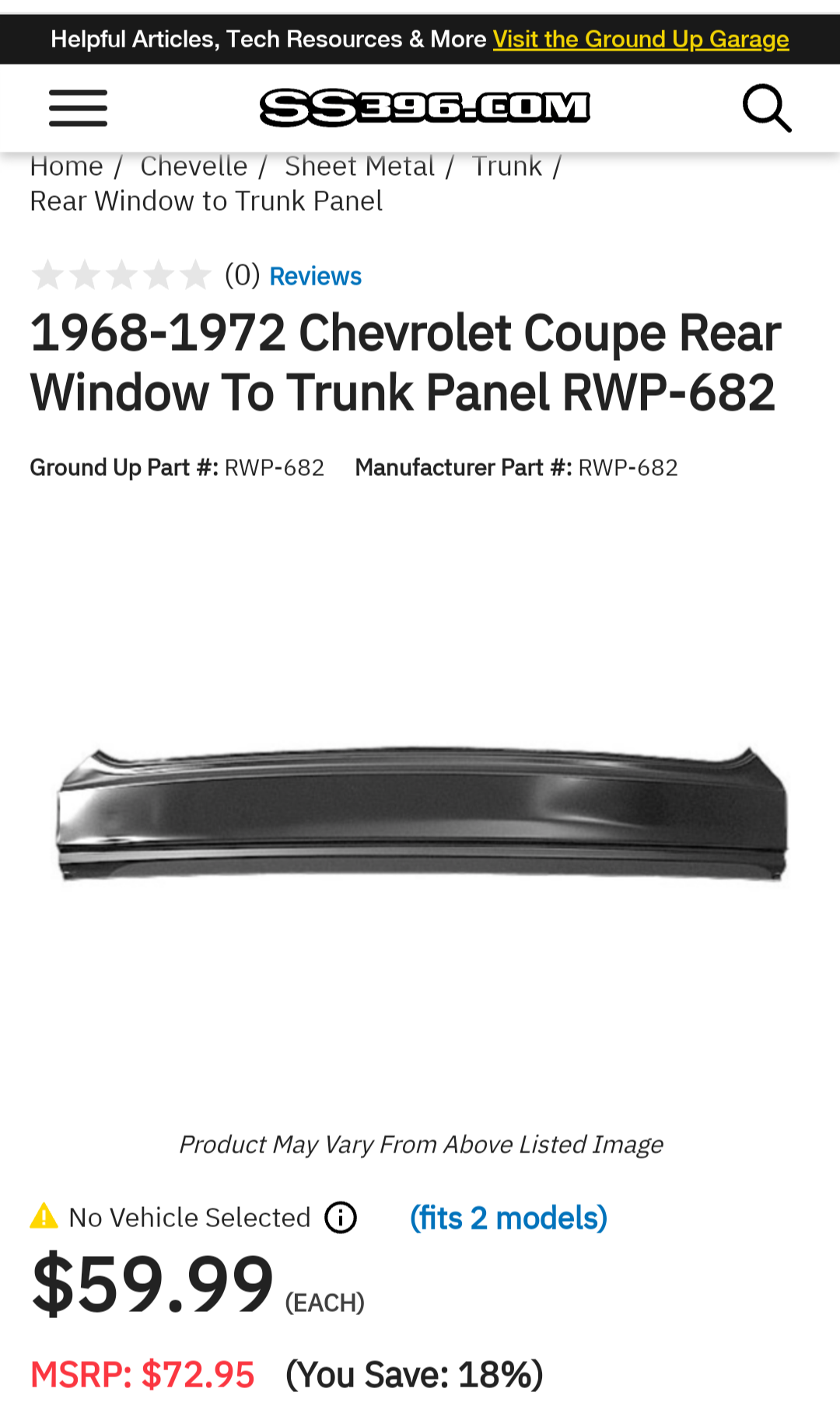

B-Man Posted March 19, 2024 Author Posted March 19, 2024 After nearly a month this rear window to trunk panel has finally shipped from SS396! Some more surgery coming up, but at least it's metal this time boyz haha 2 Quote

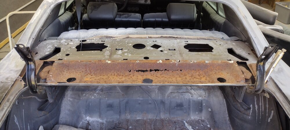

B-Man Posted April 1, 2024 Author Posted April 1, 2024 Well this was a horrible task. I guess I have some work to do before I start installing this new panel. Ugh! 2 Quote
B-Man Posted April 1, 2024 Author Posted April 1, 2024 @Steve G and @cny first gen 71 I've purchased a 200ml cartridge of 3M Panel Bond (see link below). And I'm going to borrow a 200 ml cartridge gun from my work, so I dont have to buy it (see link below). The cartridge comes with the mixing tips (swirls the 2 parts as you squeeze the cartridge with the gun, then throw away the tip after use) but I will grab more as needed Once I treat the rusty metal under the window to trunk panel with a rust reformer I'm probably going to throw a layer or two of glass over it as well to reinforce it. It's pretty thin. Then I will just bond the new panel place and use the panel bond as sort of a seam sealer too. Should be fun! And I should have this knocked out over the weekend. I still have to deal with that giant hole on the driver side at the base of the rear window and sail panel. Even though it looks somewhat finished in the above photos, there's no structure there. So I'm going to have to tear back into the area and rethink it. More panel bond, haha!! 3M Panel Bonding Adhesive, 08115, OEM Recommended, Two-Part Epoxy, 200 ml/6.75 fl oz Cartridge, Black https://a.co/d/9yNLFaL Innovations 200 ml (1:1 and 2:1) 26:1 High Thrust Dual Component Cartridge Gun https://a.co/d/05rt8ur Quote
cny first gen 71 Posted April 1, 2024 Posted April 1, 2024 The panel bond has to be used on clean bare metal, not sure if it will work over any kind of paint or fiberglass. Quote
B-Man Posted April 1, 2024 Author Posted April 1, 2024 17 minutes ago, cny first gen 71 said: The panel bond has to be used on clean bare metal, not sure if it will work over any kind of paint or fiberglass. Yep, agreed. I'm going to leave any bonding surfaces free of fiberglass. It's just that structure that I'm going to reinforce. I will cut away any glass on the bonding seams as needed once its all cured up Quote
