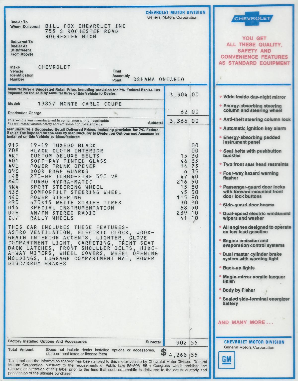

stangeba Posted December 11, 2016 Share Posted December 11, 2016 All I can say is, look at the picture below. 1 Link to comment Share on other sites More sharing options...

Rob Peters Posted December 13, 2016 Author Share Posted December 13, 2016 I am trying to keep the tire diameter as close to an original tire as possible so the speedometer is as accurate as possible. For all of you tire guru's out there. I am not sure if the original tires were G70-15's or G78-15's. From what I am seeing on line here are my thoughts: If they were G70-15 I think the tire diameter was 27.5 inches so I think my best bet would be either the 215/70R 15 at a diameter of 27.3 inches or 215/75R 15 at 27.7 inches. I think I could possibly even go with a 235/70R 15's at a diameter of 27.95 inches. If they were G78-15 I think the diameter was 28.0 inches and I think my best choice for that would be the 235/70R 15 at a diameter of 27.95 inches How flawed is my thinking. Out of the three which would I be best with? rob 1 Link to comment Share on other sites More sharing options...
stangeba Posted December 13, 2016 Share Posted December 13, 2016 This came to mind but may be incorrect, When I ordered the Rally wheels for my 71, they were only available in 7" wide and the WIDE OVAL single thin white stripe tires were required or should I say, included with the wheels. This is how I think I remember it but my window sticker doesn't read that way.... Link to comment Share on other sites More sharing options...
