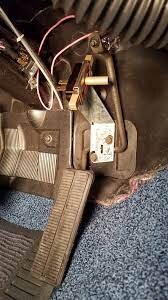

black07ss Posted October 21, 2023 Author Share Posted October 21, 2023 Anyone have some pictures how it is cut out around the gas pedal? I found these on line, not sure how detailed to get or impair the linkage. 1 Quote Link to comment Share on other sites More sharing options...

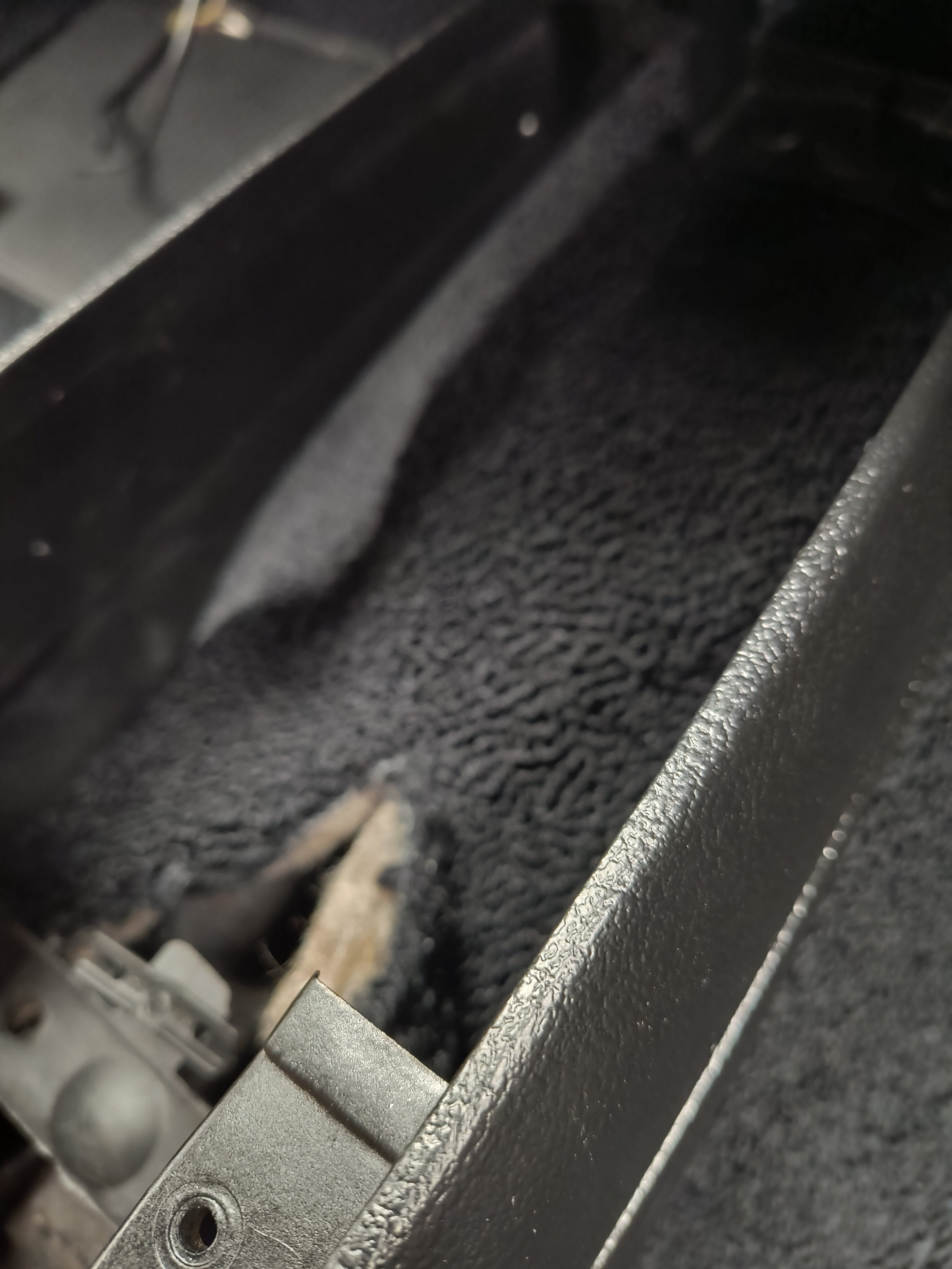

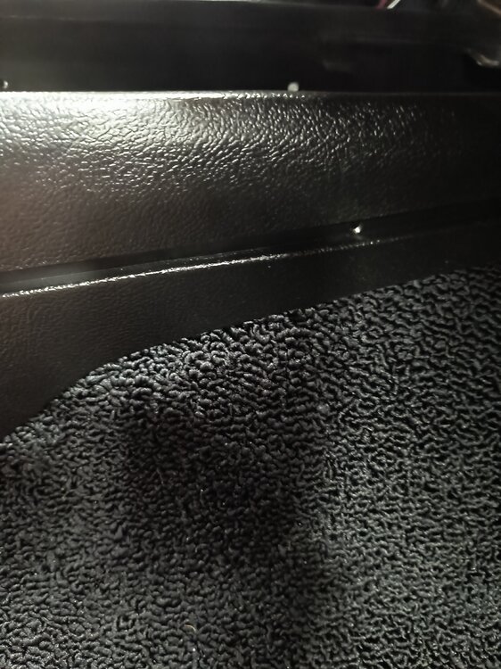

black07ss Posted October 22, 2023 Author Share Posted October 22, 2023 Console question Did you keep cutting down the center for the console to go down that little bit more? Seems like a large gap at the front. Quote Link to comment Share on other sites More sharing options...
jft69z Posted October 23, 2023 Share Posted October 23, 2023 I just put a minimal cut from what I remember. Quote Link to comment Share on other sites More sharing options...
black07ss Posted October 23, 2023 Author Share Posted October 23, 2023 9 hours ago, jft69z said: I just put a minimal cut from what I remember. Thanks Joe, The carpet is somewhat loose at the top of the tunnel and the console has a gap there as you can see in the pictures. Dan said his had a gap also. Quote Link to comment Share on other sites More sharing options...
Dtret Posted October 23, 2023 Share Posted October 23, 2023 Is it possible that the console cars had a thicker pad up top? Quote Link to comment Share on other sites More sharing options...
black07ss Posted October 23, 2023 Author Share Posted October 23, 2023 2 hours ago, Dtret said: Is it possible that the console cars had a thicker pad up top? Not sure Dennis but that is how I am going to resolve my issue by adding a little more jute at the top of the tunnel. Quote Link to comment Share on other sites More sharing options...
