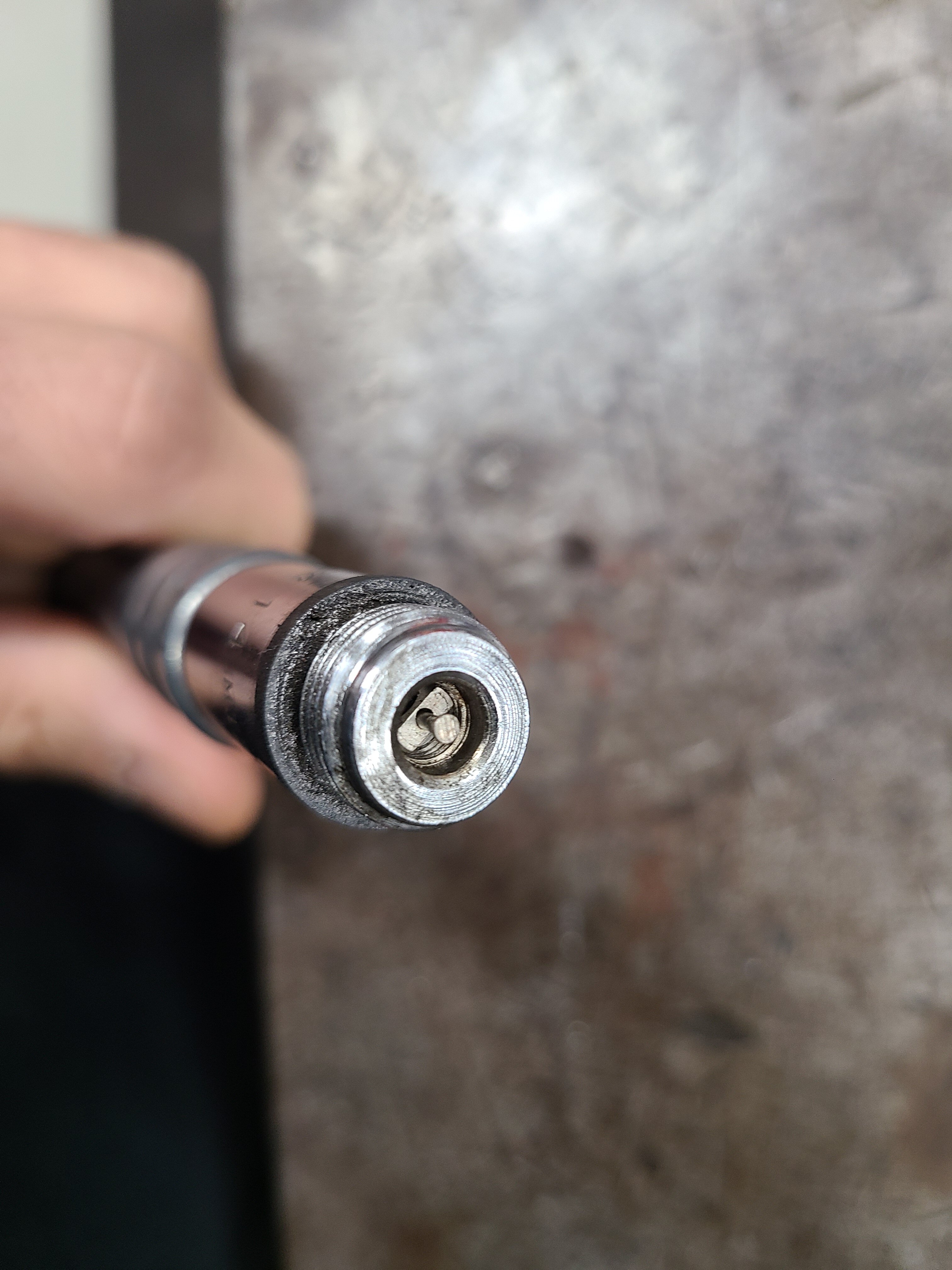

In regards to your statement that it held pressure for days.... usually those hoses have a Schrader valve in the tip, at the spark plug end. I'm thinking that's why it appeared to hold pressure on that cylinder, it just trapped pressure in the hose itself. With the piston rings having an end gap, it would be impossible for the cylinder to hold pressure for more than a few seconds, let alone a day. My SnapOn compression gauge set has a little pressure relief button on the side of the fitting, to vent the hose down after taking the reading.
18 minutes ago, Leghome said:
Joe this gauge also has the valve on the side to relieve the pressure no shearer valve on this one
There should be one in there somewhere, I'm pretty sure. On mine, it's screwed right into the end of the hose tip. The hose for the leak-down tester doesn't have one, but another extra hose I have also has a valve in it too.

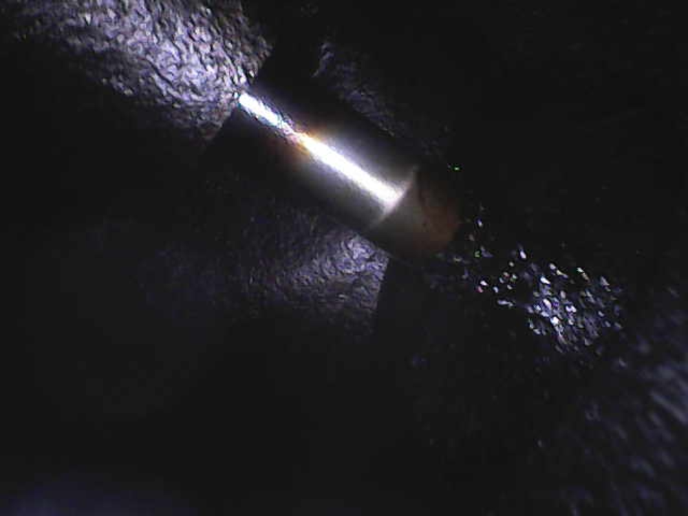

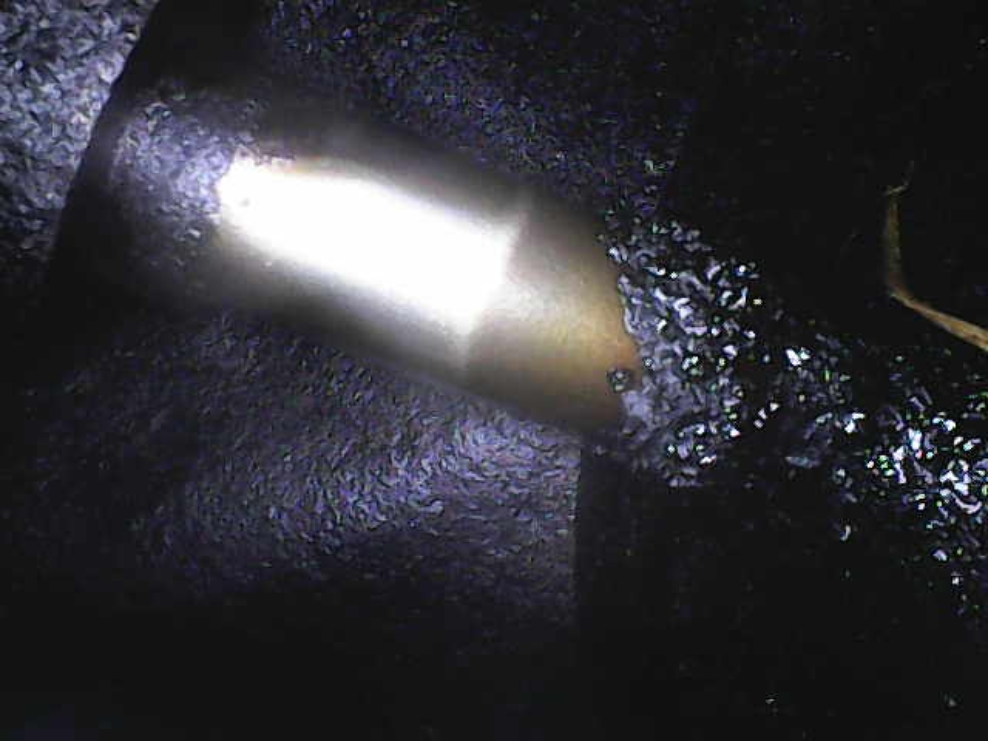

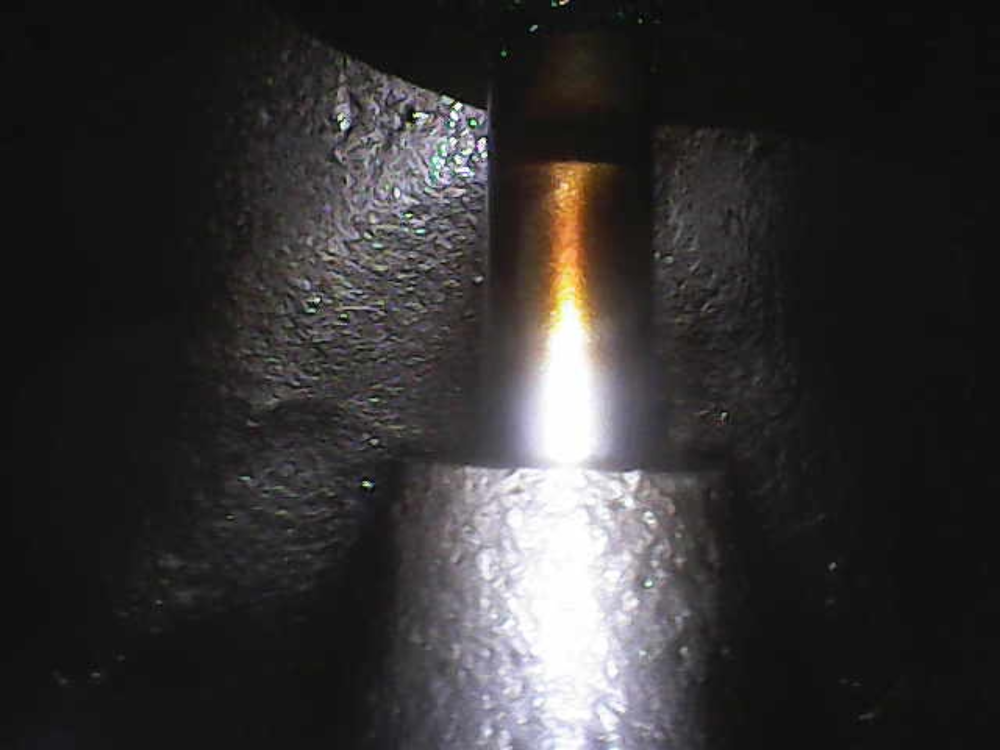

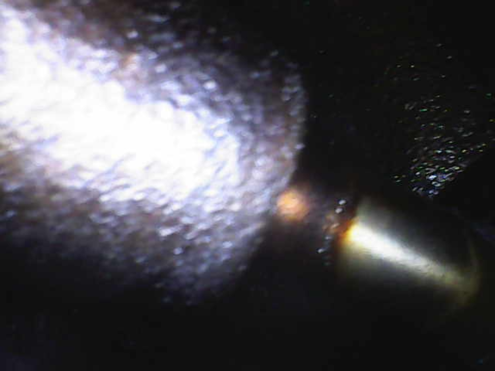

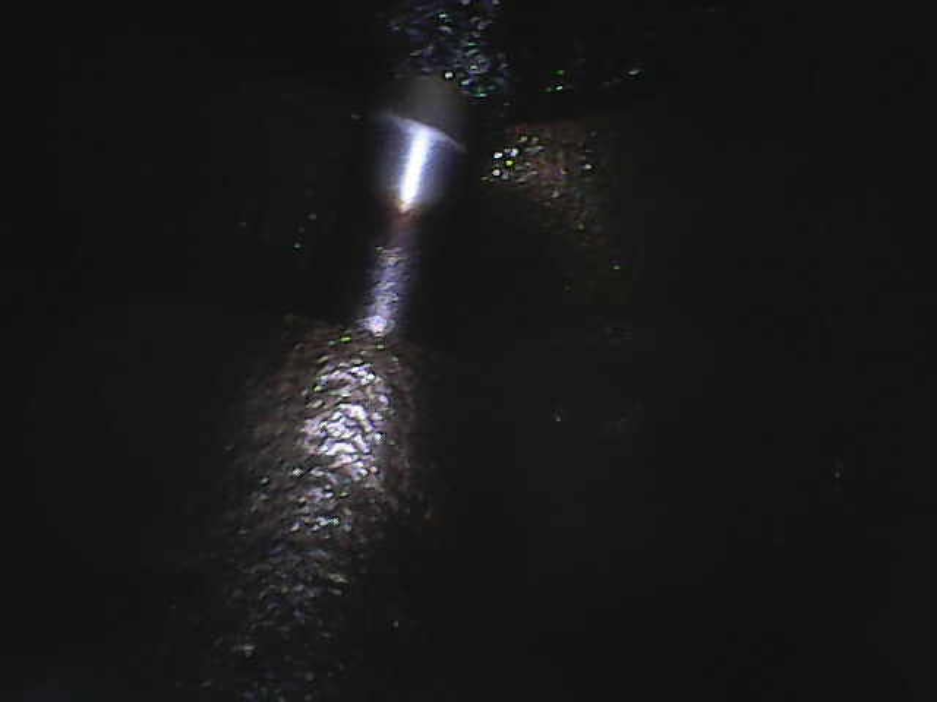

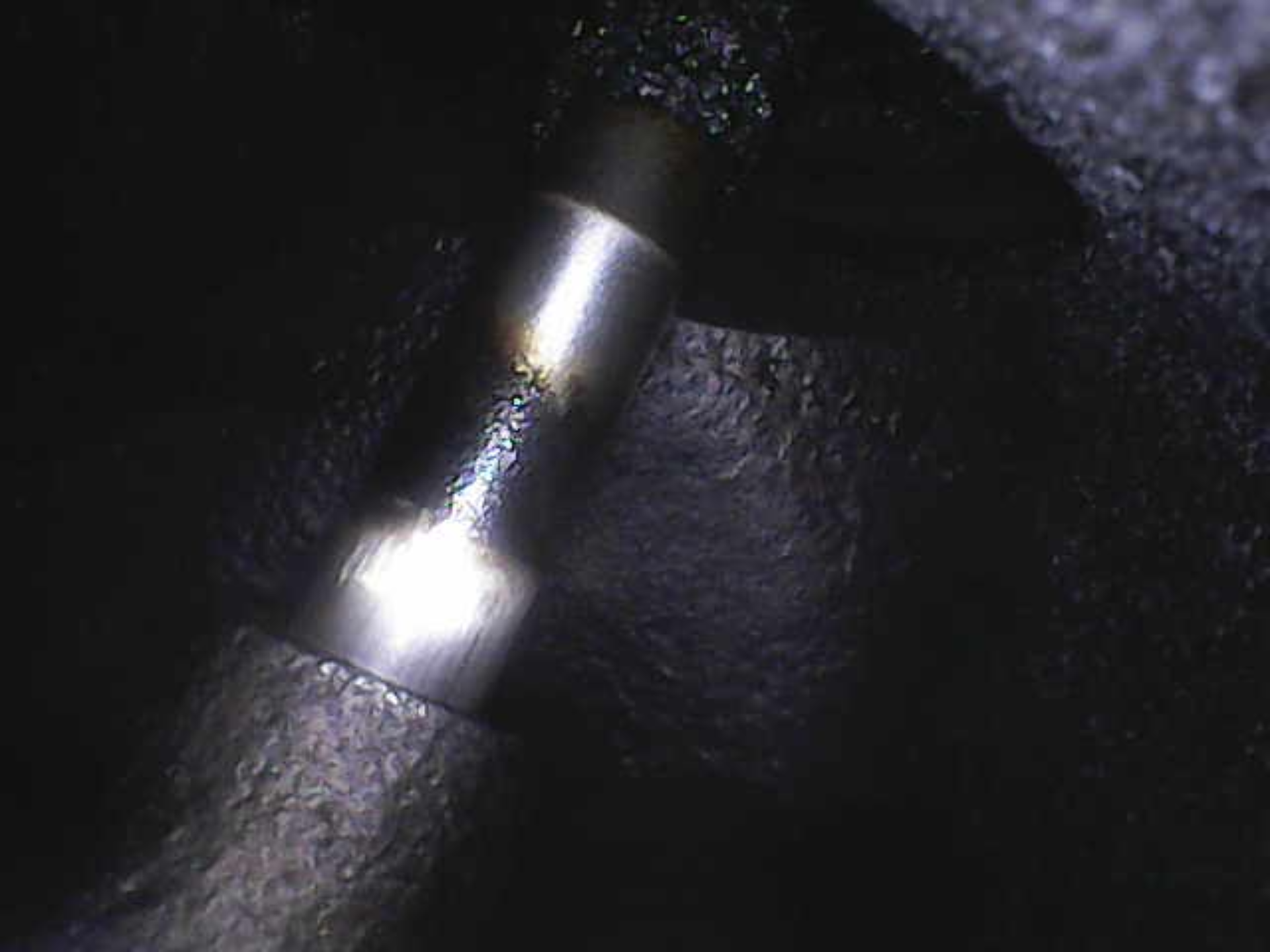

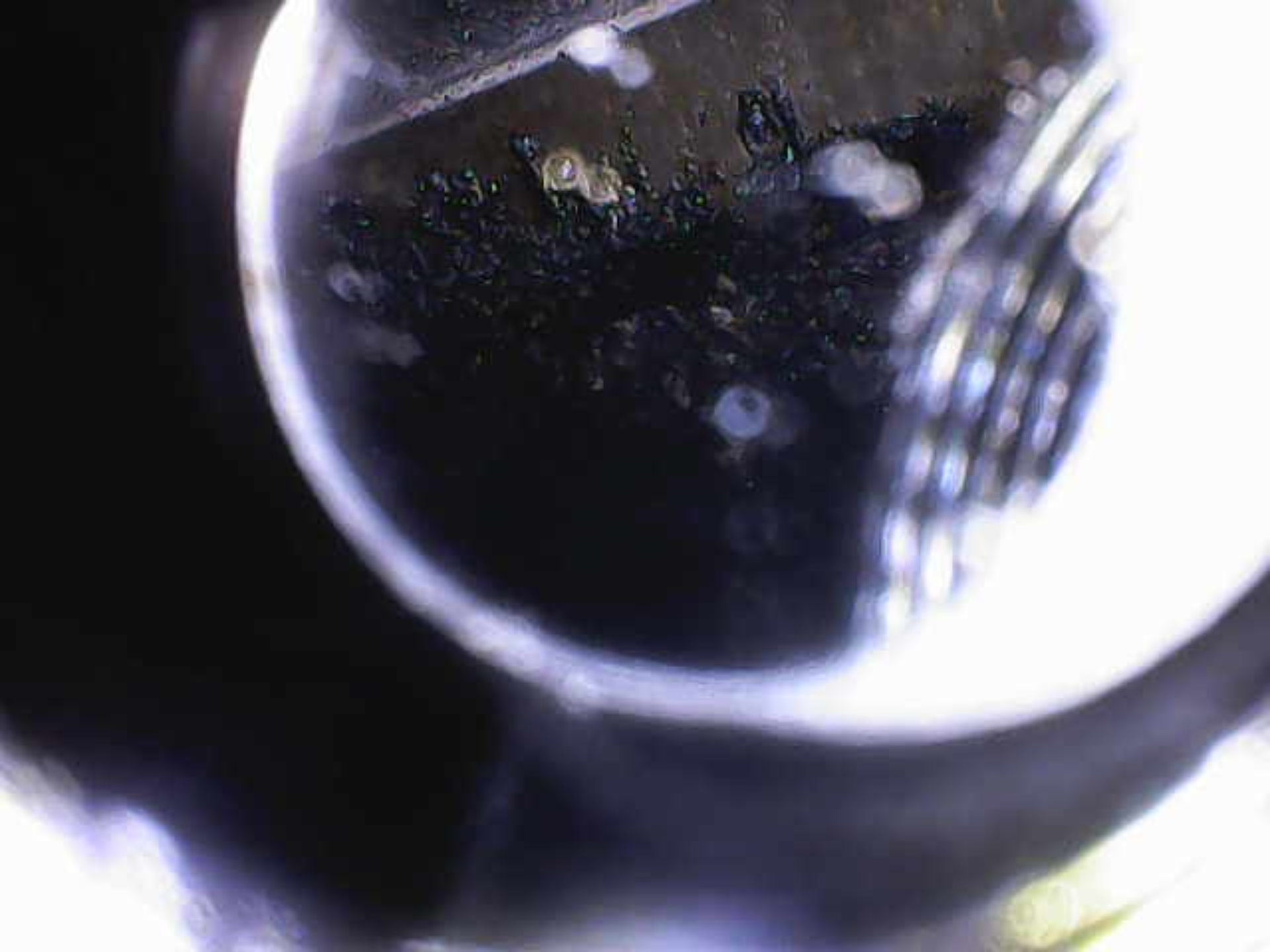

t my endoscope today and played with it a little so the pix aren't the greatest but you gotta  start some wheres. Looks to be some rubbish around the one valve and on top of the piston. I need to play some more to get better quality photos but that wire is pretty stiff and I need to figure out how to maneuver it. After looking at the enlarged image I don't think that is the top of the piston
Similar problem here 3-4 years ago. Mine was valve seals, used the viton seal. No more smoke or fouled plugs. Teflon seals had disintegrated.. just hoping yours is that easy too Larry..
Jamey(son in-law Mechanic) and his dad are coming over tomorrow and we are going to delve further into it. I have the EFI moved out of the road so we can run the endoscope over to the valve area to have a look see.  Also looked for model number on the intake and it is an Eldebrock Performer 2101. Also found the invoice when the engine was rebuilt and they did do a valve job and resurface the heads, polished the crank, recondition the rods, new cam bearings, bored twenty thousandths and fit and pressed the pins
Pulled the intake off Saturday and everything looks good as far as the gasket goes good seal all around. Now to start checking the valve seals but need to get a valve spring keeper remover. If the guides are worn new heads may be coming and if the seals are all that looks bad then replacing them will be done. Been pricing different heads and they run from $1338 a pair for Brodix to $1192.50 each for Edelbrock. I had never heard of Brodix until a few days ago talking to Joe T, we have talked about this problem and solved most of the worlds problems in our over 90 minutes worth of discussion. Talked to Brodix part number 1021005 and Edelbock part number 60895 on the phone today was their best recommendations for the way my engine is setup. Waiting to hear from AFR and Dart.

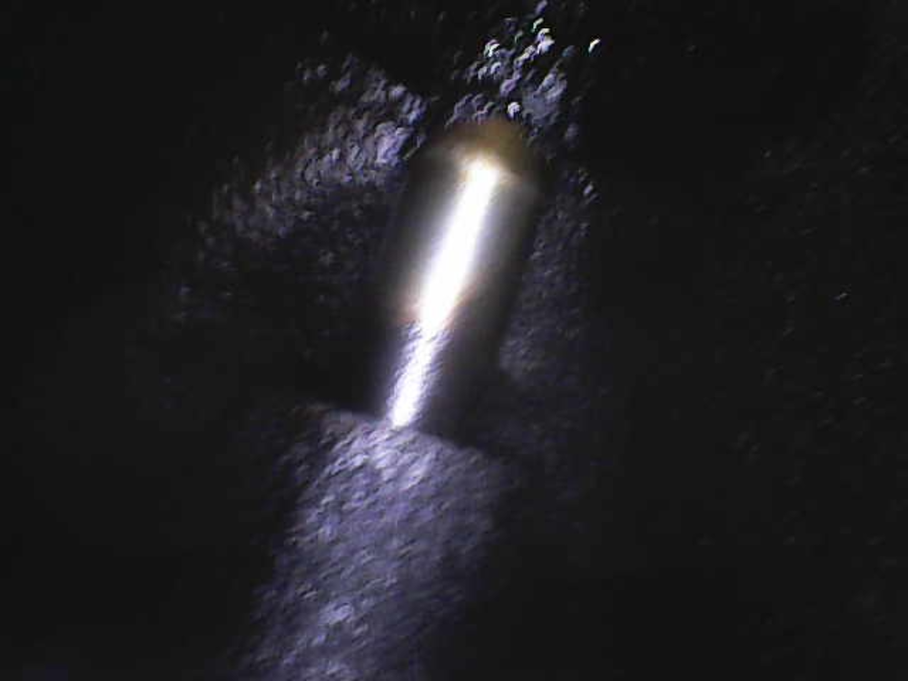

With the intake off, look down the intake ports at the valve and stem. If the seals/guides are leaking you should see signs.
2 and 7 were golden colored a couple of others were slightly but the first two mentioned especially 7 was the worst by far. So now to check the valve seals and hoped for the best but expect the worst
the first photo is No 7 stem, the fifth one number 2 stem I think. I am still learning how this endoscope works So I have mixed them up. Number seven is fouling the plugs the worst.  pic taken in this order 7,5,3,1,2,4,6,8 Intake valves Actually wit the way the pic ended up in a line number 7 is actually the fifth photo. When I uploaded they were in order but it is what it is
