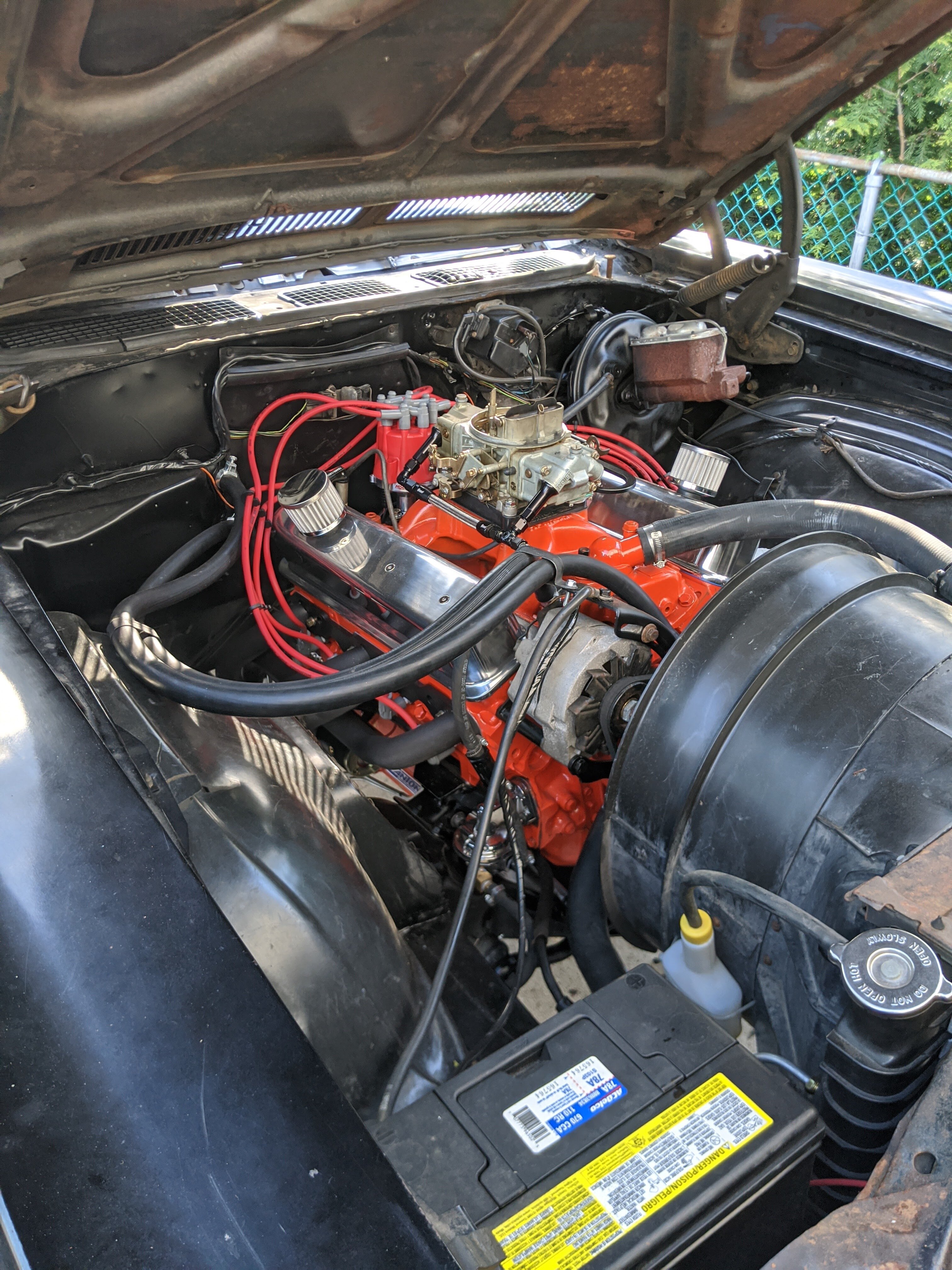

Not sure what brand my headers are, they came with the car. But the problem is the same.
Had to unbolt them and went with the short plugs (NGK) as well.

lha10.thumb.jpg.b47429157e3cb547484b16b6ec1695ed.jpglha12.thumb.jpg.76ee55ee6ca2b62916f66c3885213c85.jpg
