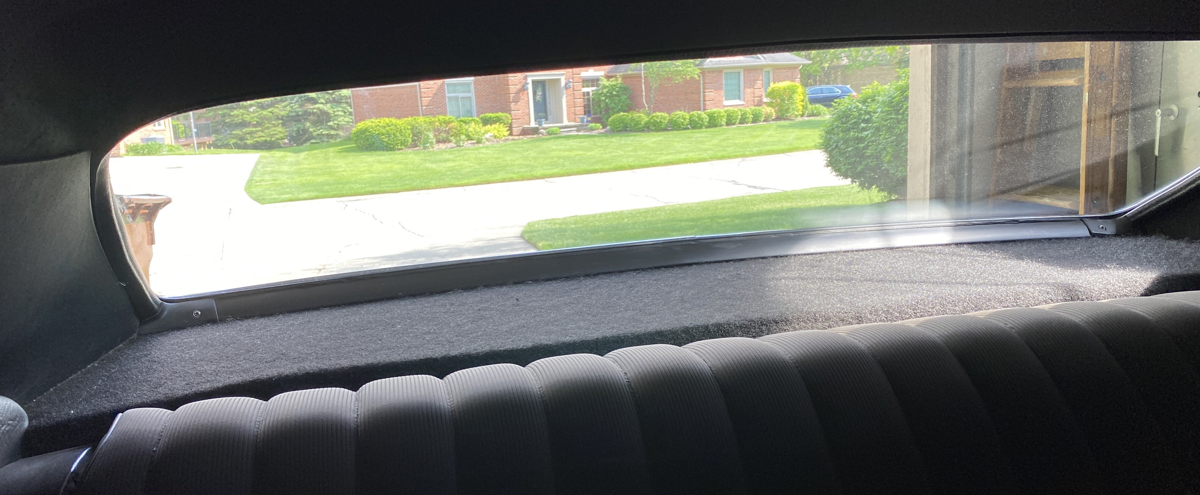

Canuck Posted May 20 Share Posted May 20 OPGI or CARS Inc may have them. Be sure you get the proper colour. The mesh style ones are not factory. Here’s mine but note I have not painted my grills to match. 1 Quote Link to comment Share on other sites More sharing options...

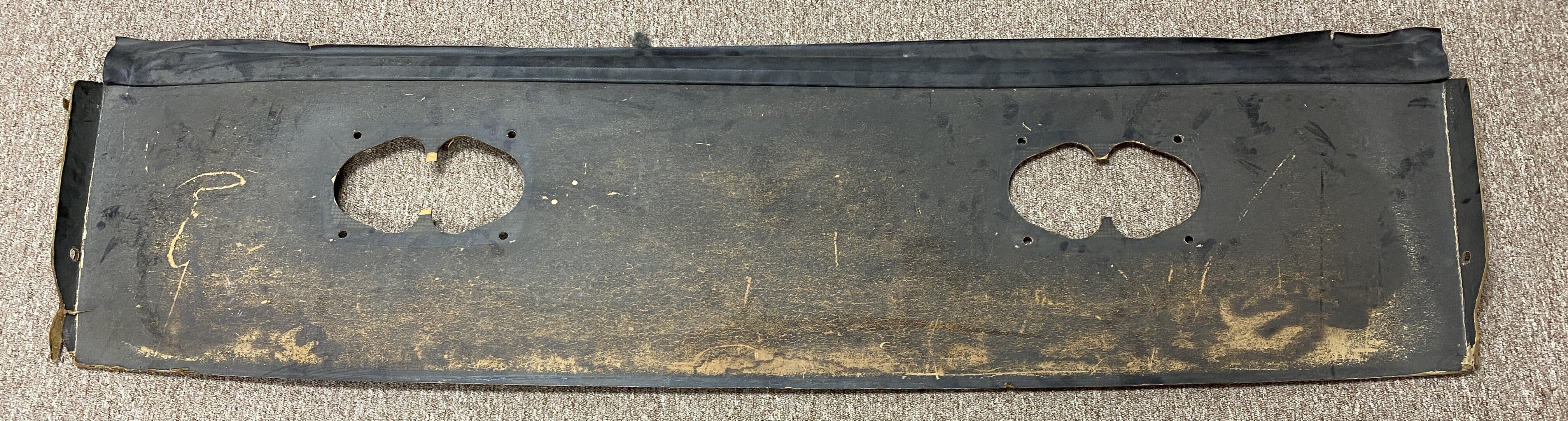

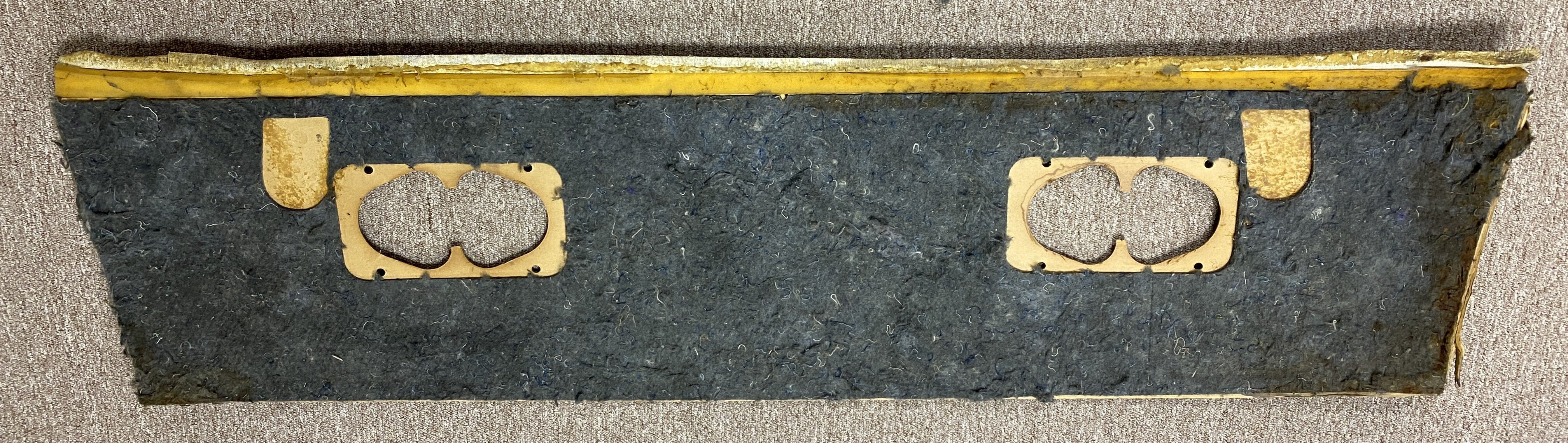

stangeba Posted May 20 Share Posted May 20 Interesting topic. I replaced mine over 33 years ago when a neighbor, who had just replaced it on his Chevelle, offered to make one for my 71 Monte Carlo. He worked for Chevrolet, at the Warren Tech Center in Michigan, and used some of the new 1980's style material, I call "Scotch Brite" but black. It has held up perfectly all these years. I also still have the ORIGINAL one in my basement just incase I ever want to change it again. No speaker grills were required. 2 Quote Link to comment Share on other sites More sharing options...
