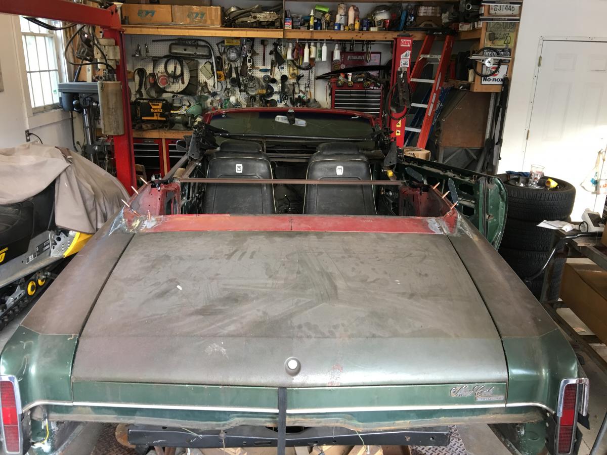

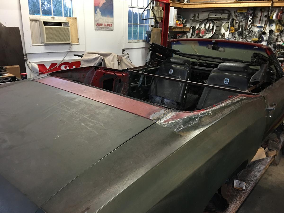

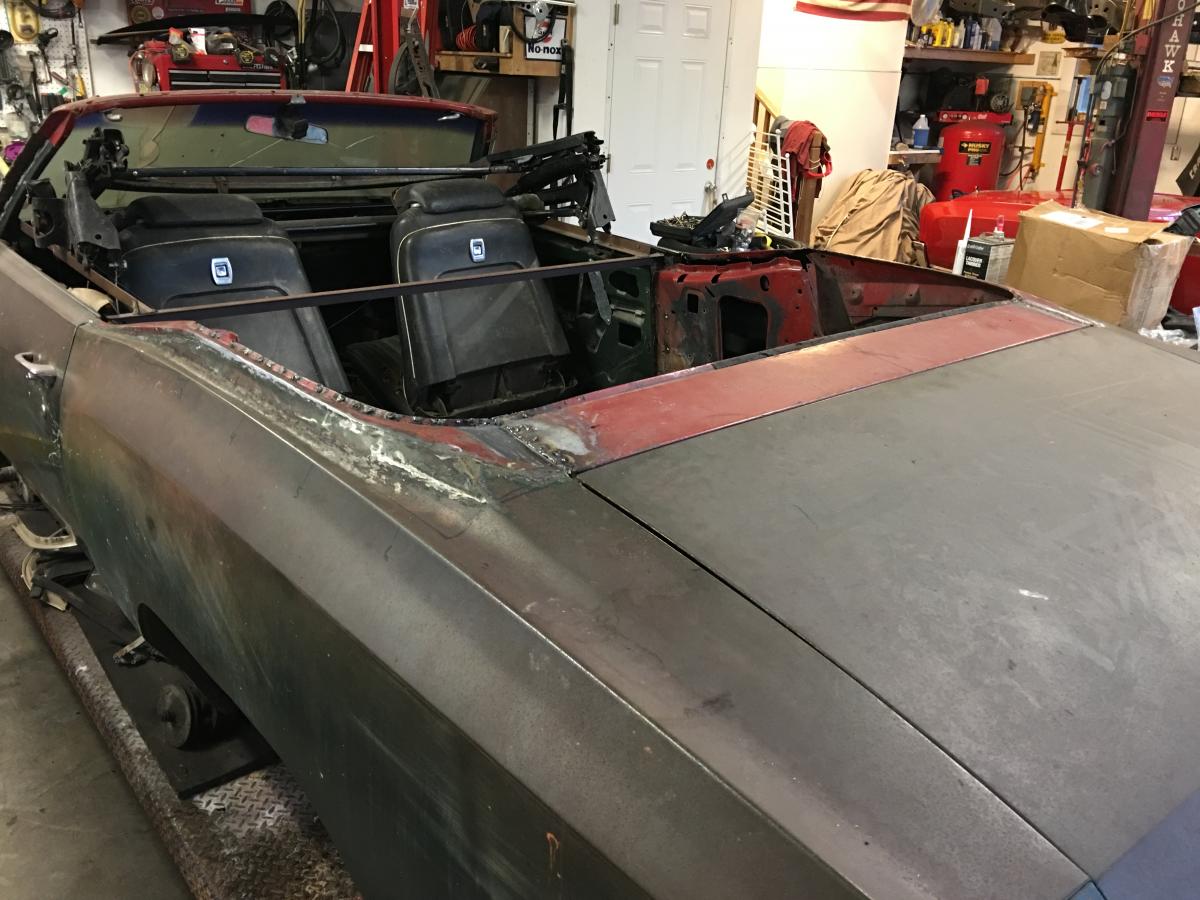

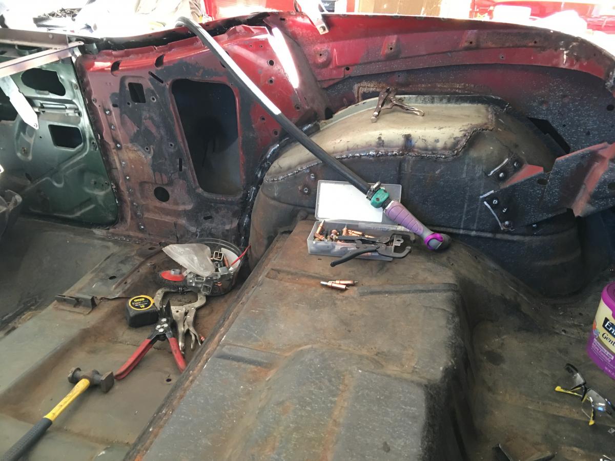

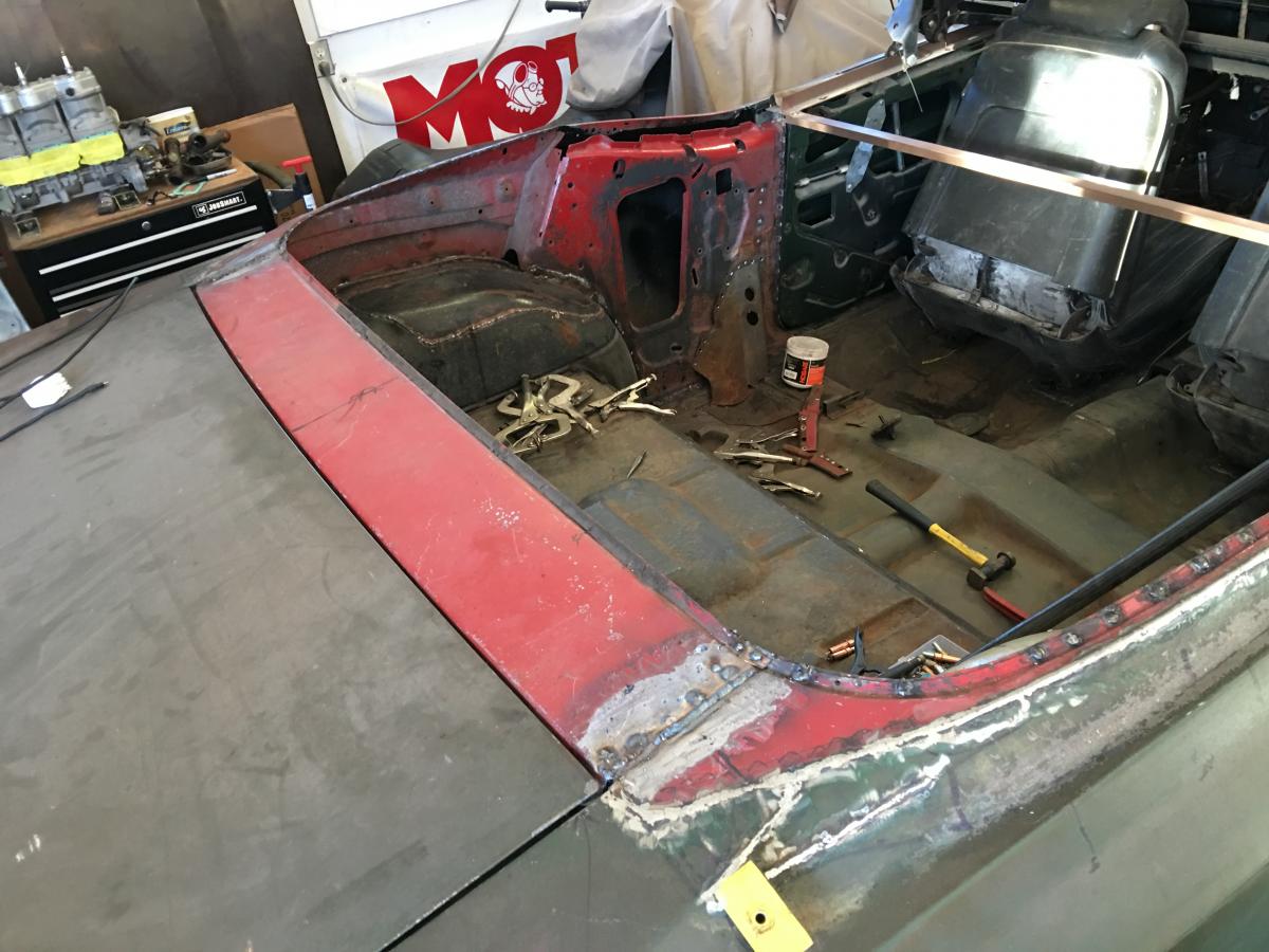

Welded up the Q-panel tops today. Now time to get out the grinder to cut down the welds. I used .023 wire and wet rags to keep the heat under control. I also plan on applying seam sealer to the back side of the welds to prevent moisture finding its way from beneath.

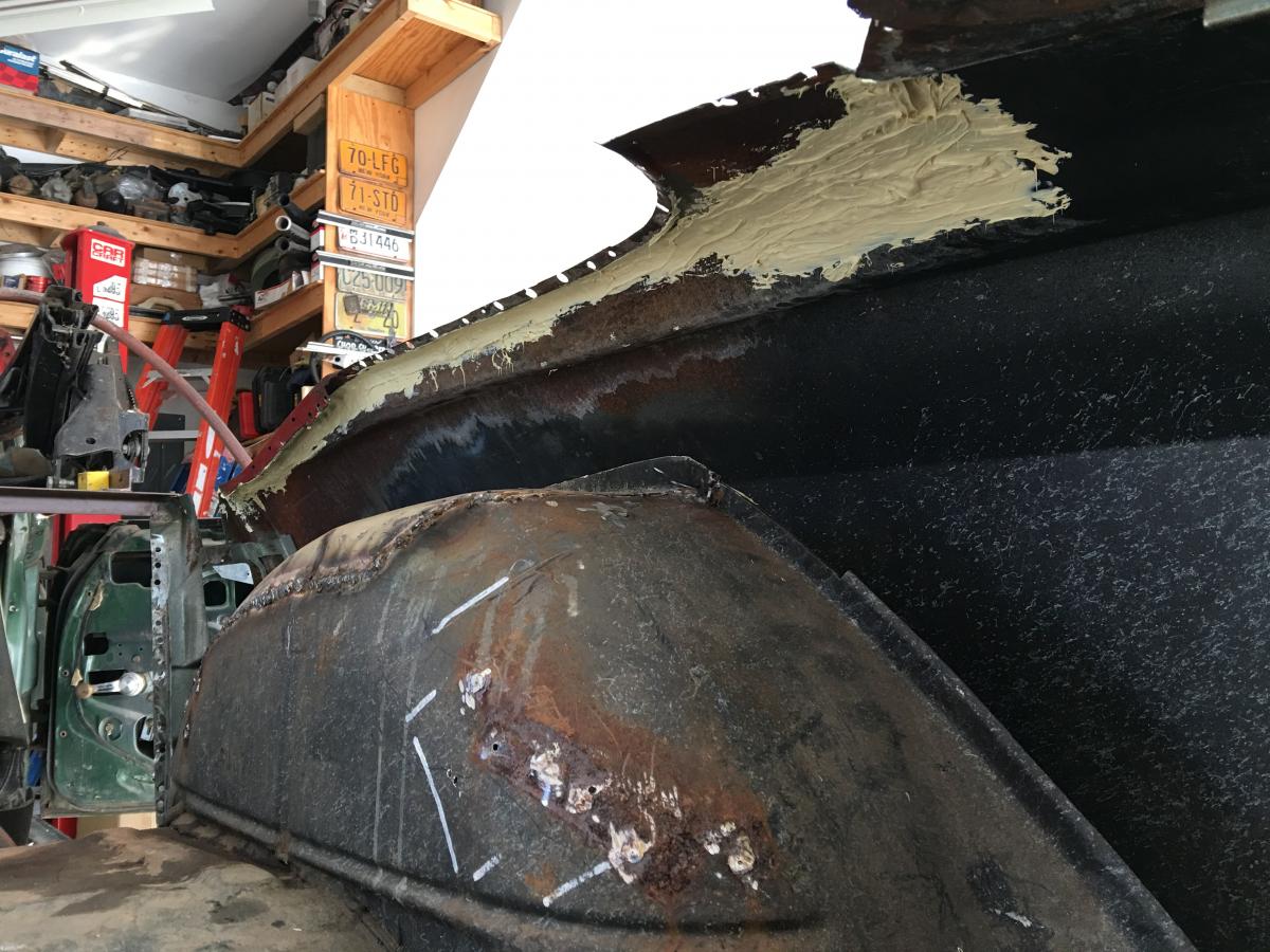

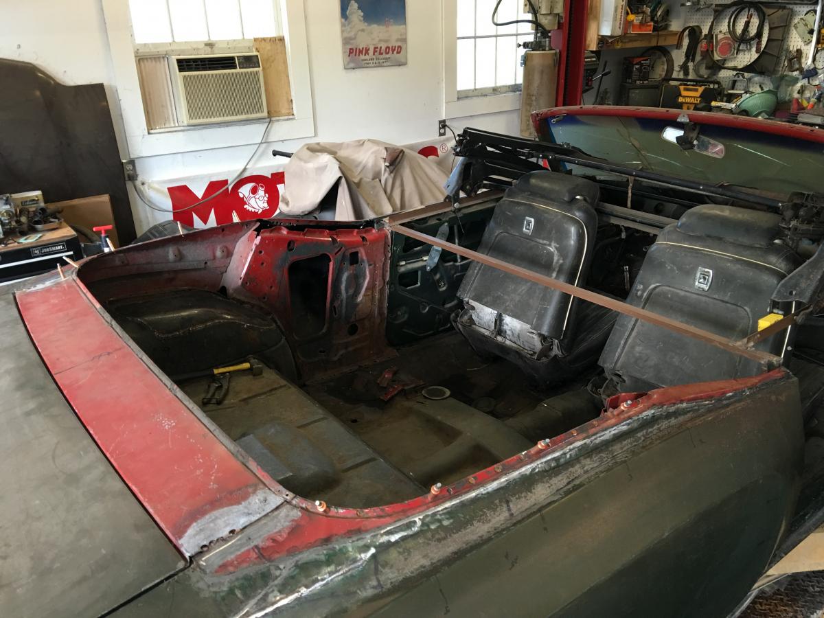

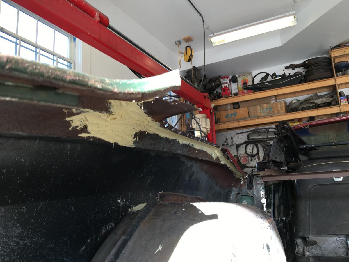

It only took about 10 years since the first cut but the body is almost complete welded back together. The quarter panel butt welds were welded on both sides and the outside ground flush. Then seam sealer was applied from underneath to avoid moisture entering from beneath and creating bubbles in the bodywork down the road.

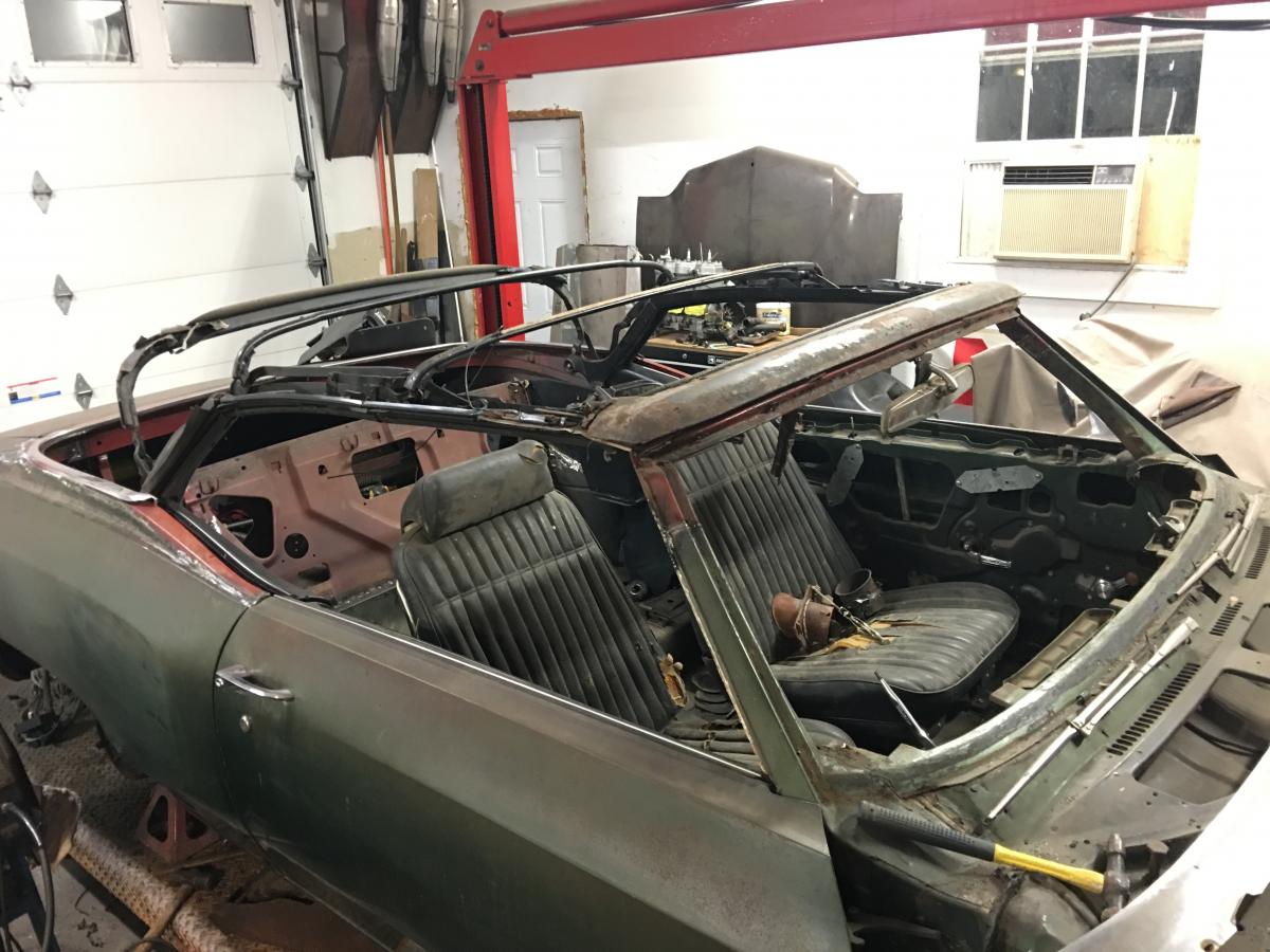

Thanks for the complements. Nothing is perfect but it seems to be coming together good. I dry fit the top and some of the trim panels and everything is lining up where it should.

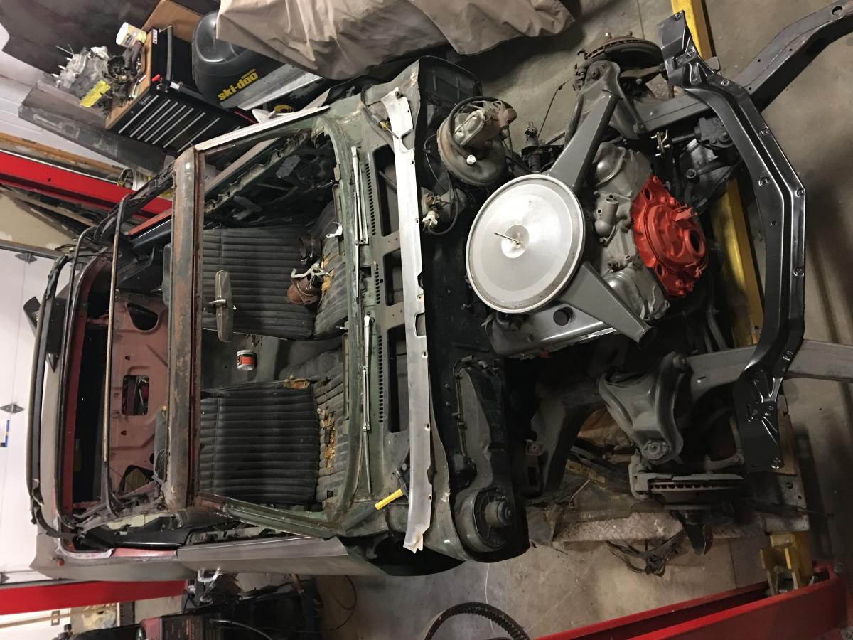

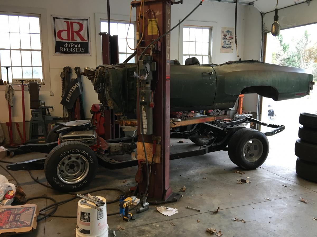

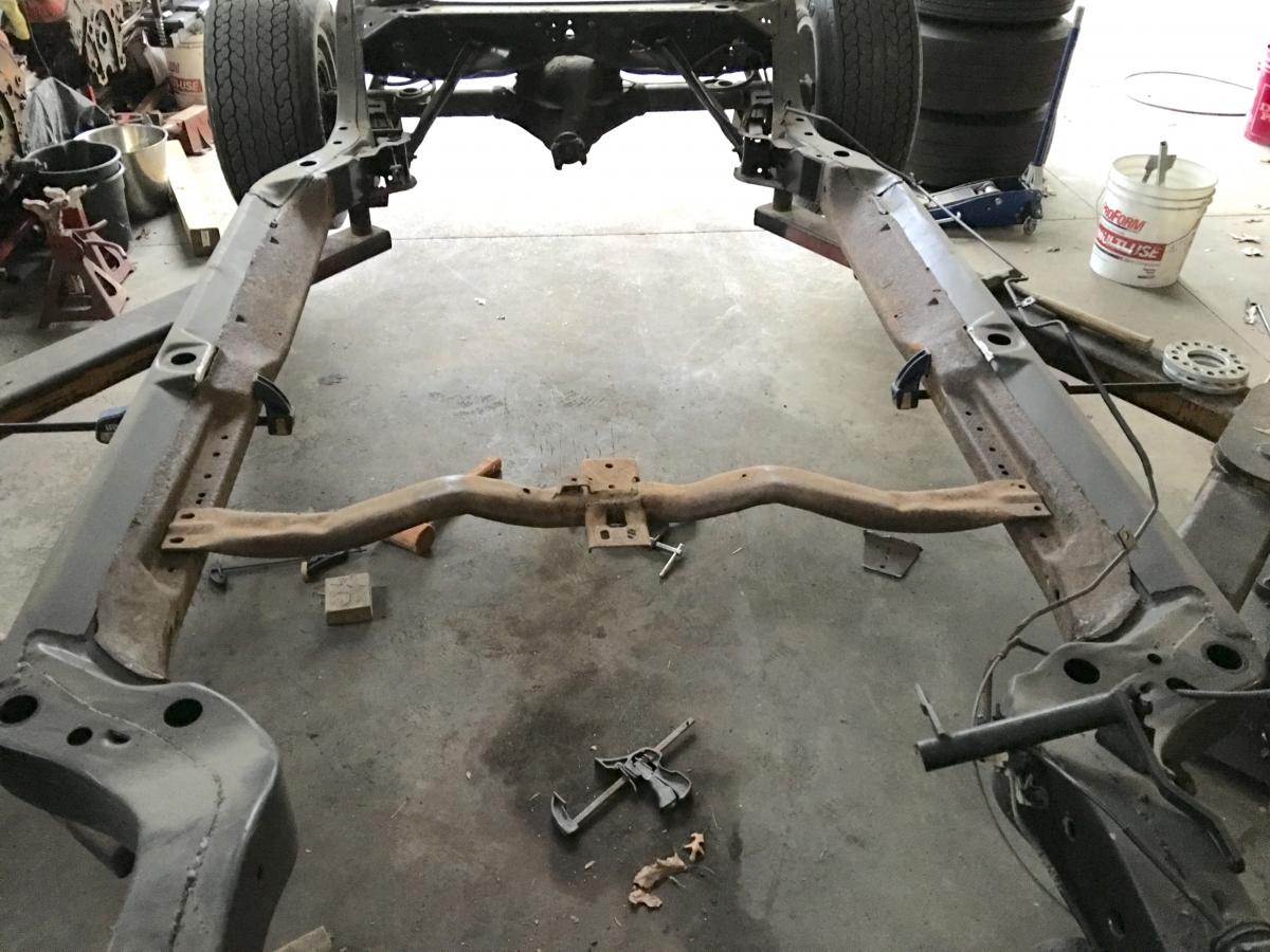

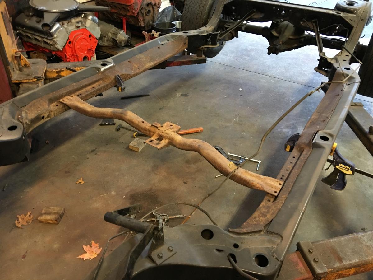

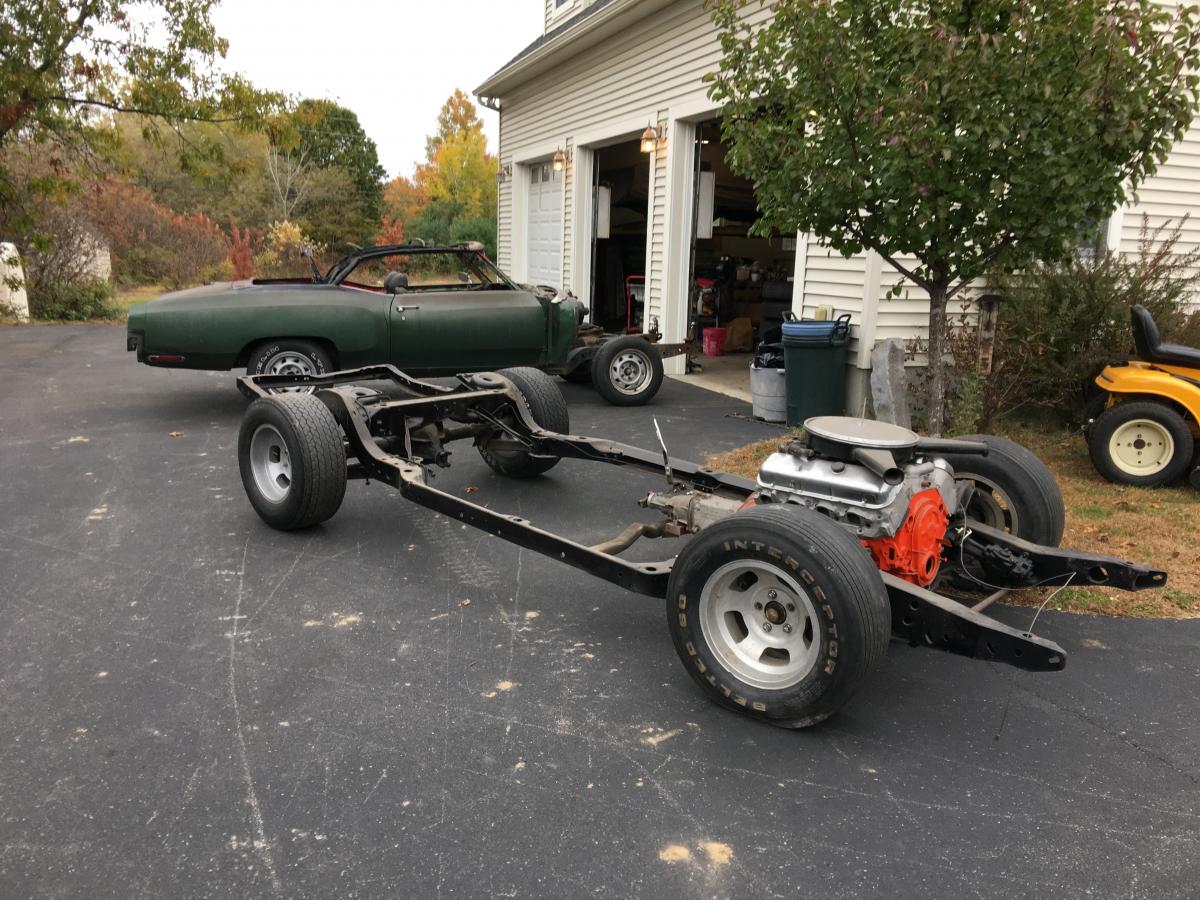

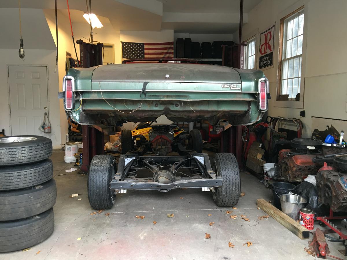

Pulled the body today and set it on a spare chassis. Then started to fit-up the convertible frame braces. First fitting went well but need some fine tuning.
