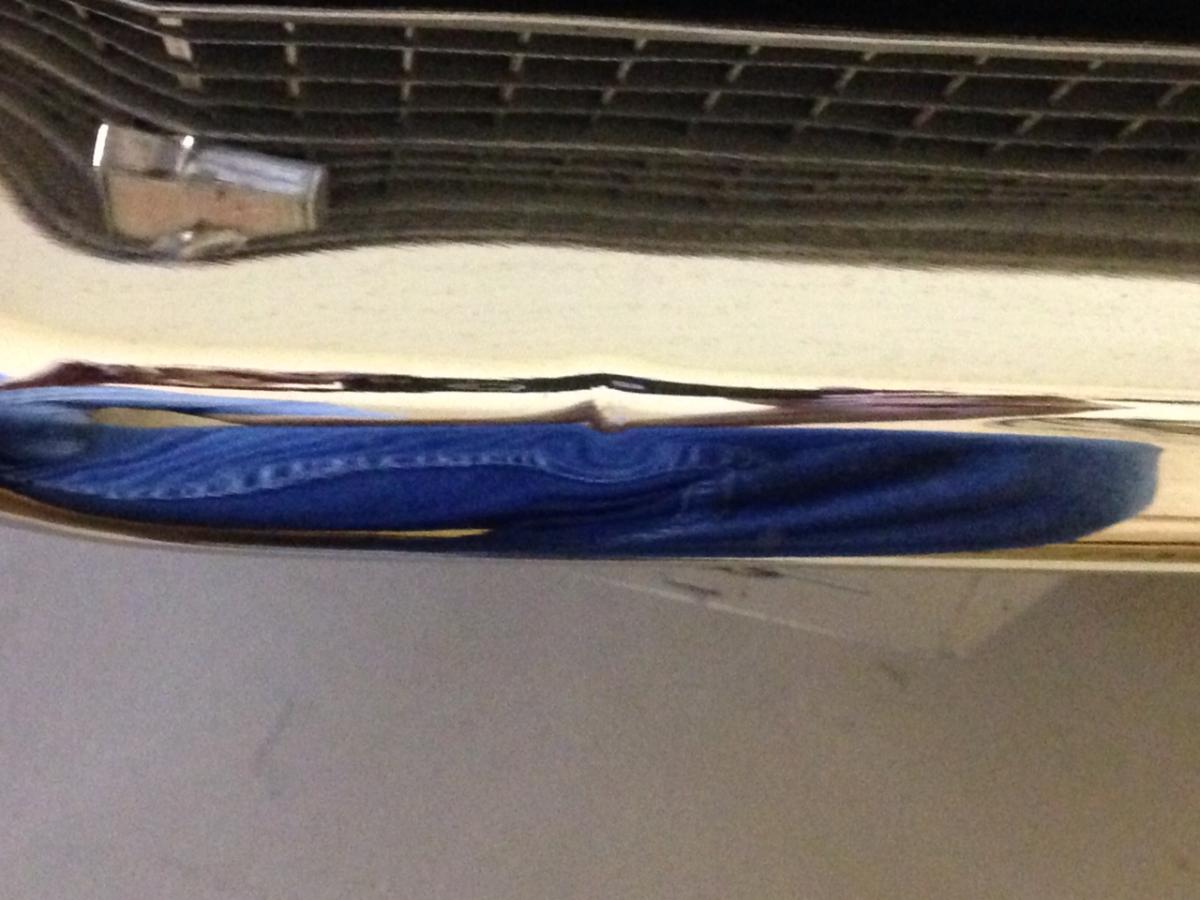

MCfan Posted March 28, 2016 Share Posted March 28, 2016 Finally replaced the front bumper on my 4 speed '70. It wasn't in terrible shape but had one small dent on the leading edge near the centerr and a spot on top where the chrome turned dark. (see photos) It was bad enough to be an embarrassment at car shows. I picked up a nice new '70 bumper from Dennis Day (Day1975) since he actually needed a '71 bumper instead. He shipped it FedEx Ground and it arrived in good shape - amazing! One thing I learned from this experience is to install the parking lights, bumper guards and even the front plate onto the bumper BEFORE installing the bumper on the car. Because I wanted to paint the parking light housings, I installed the bumper first while the paint dried overight. It is not impossible to mount the parking light housings with the bumper already on the car, but it is the next thing to it - what an unnecessary hassle! Another thing I learned is that at least two of the eight bolts that hold the front bumper on are nearly inaccessible. I had to use a crow's foot on a 3/8" drive breaker bar to get one loose - not sufficient clearance to use a socket and too far up inside to use a ratcheting wrench. Oh well, it's all done now and I even included an "after" photo ot prove it. Quote Link to comment Share on other sites More sharing options...
